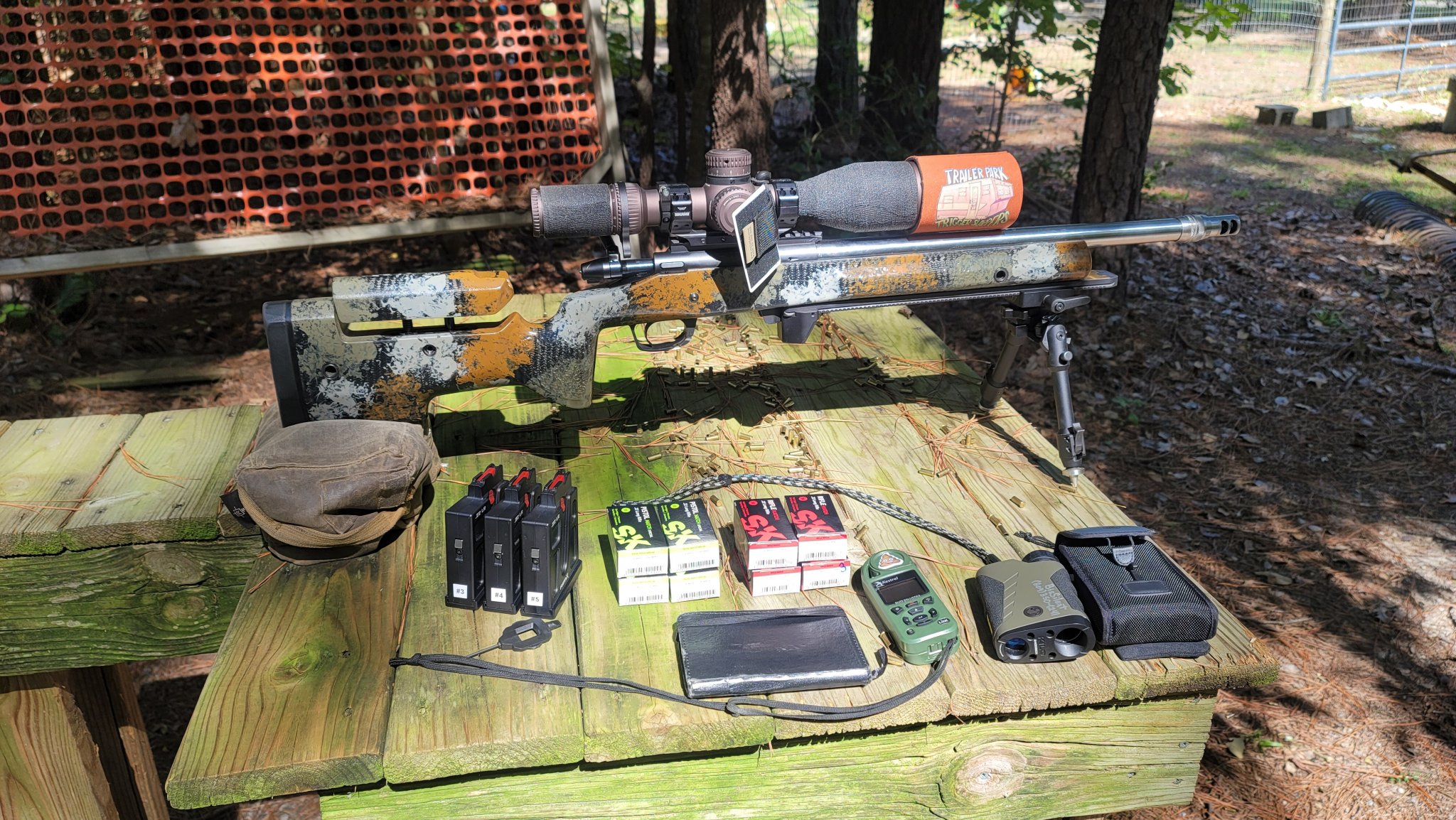

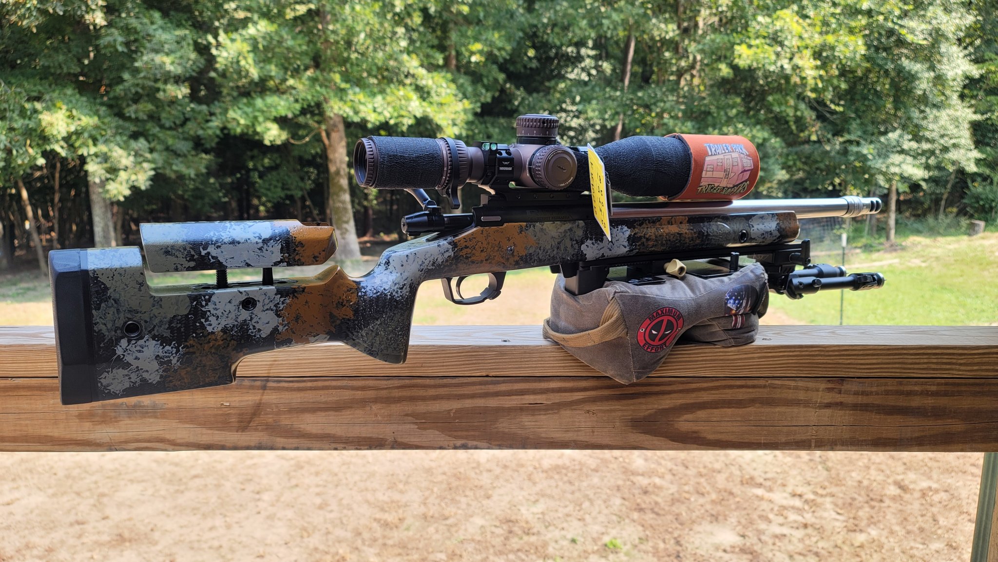

I bought a case of this to see if it would work in Rifle. It was $6.50 a box so I figured it was worth a shot "pun intended". So far I have been pleasantly surprised. It has shot pretty well so far and I got some magnetospeed on it today. Rifle is a Rim-X with a Straight Jacket Armory 18" 1:14 twist.
3 strings:
20 round, 1111 fps avg, 1126 hi, 1098 low, SD 7, ES 28
10 round, 1109 fps avg, 1119 hi, 1098 low, SD 6, ES 21
10 round, 1114 fps avg, 1127 hi, 1100 low, SD 7, ES 27
Gonna try it out at distance tomorrow 🤞

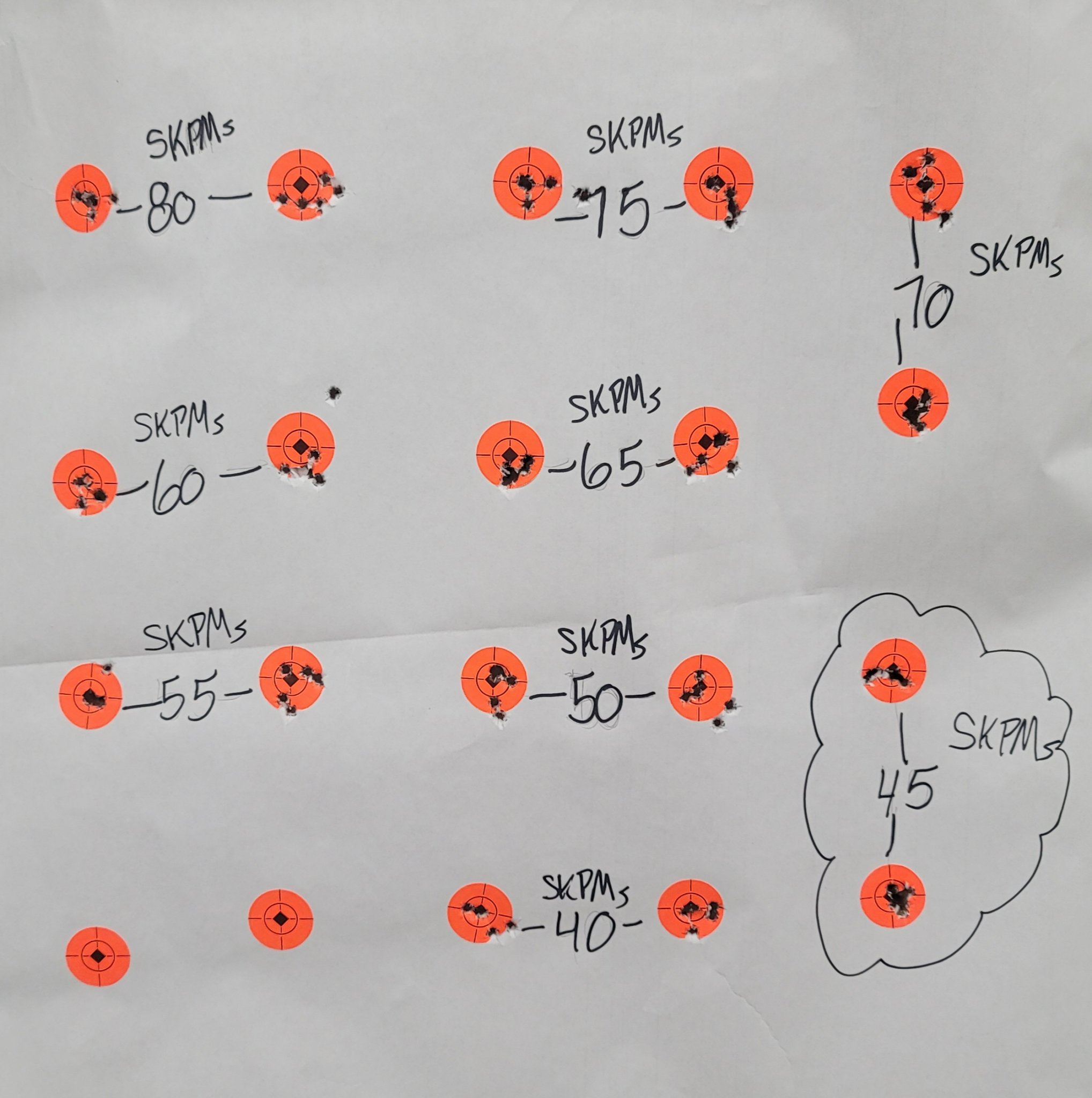

It isn't going to make the cut at distance...I haven’t changed my tuner yet but I'm skeptical that will make it anything more than practice ammo. Got 2 matches this weekend so I'm not messing with the tuner.

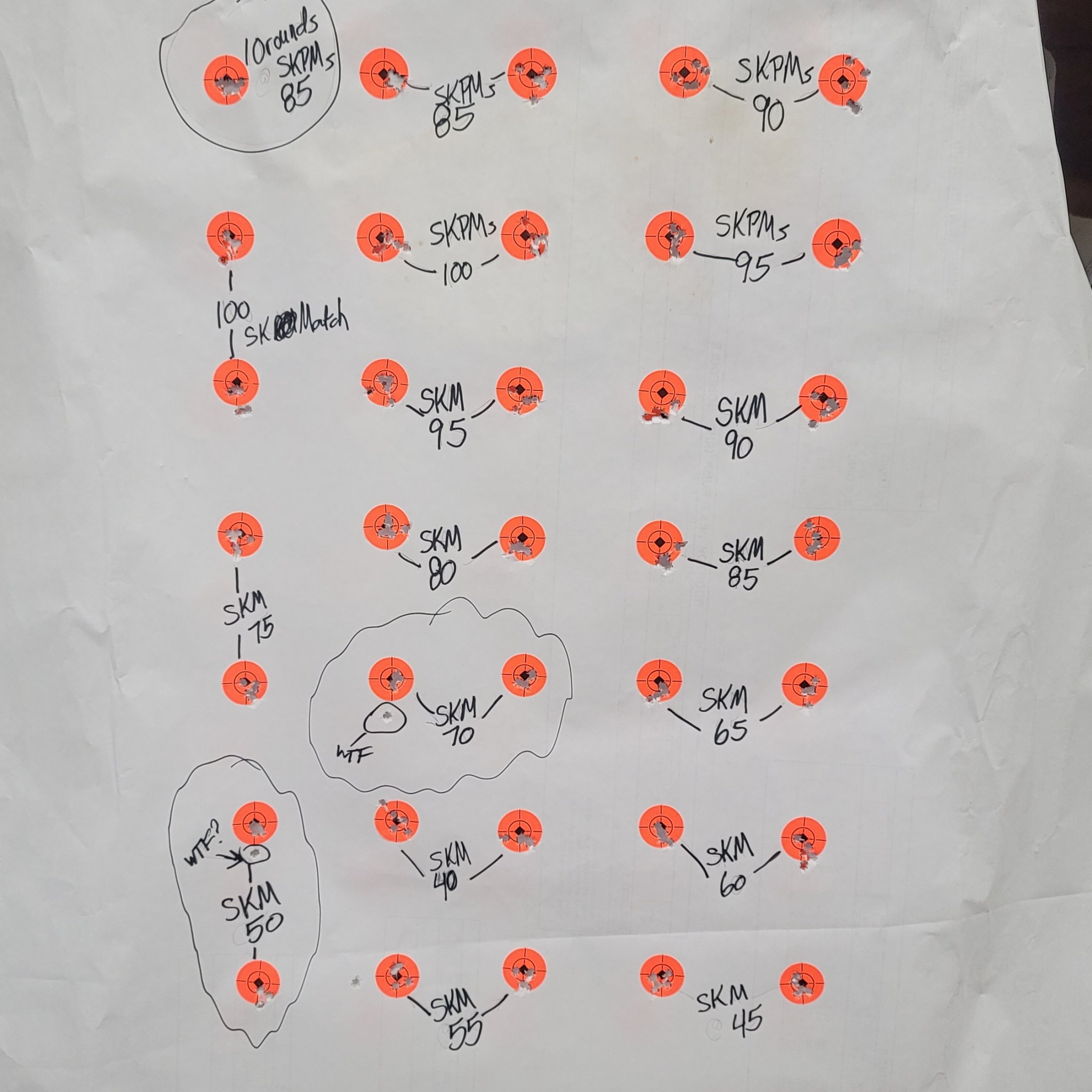

Tested the SK PMs and SK Match with the Harrell's tuner @50 yards. The # is the tuner setting. The Match shot much better but not great. The PMs looks like practice ammo only. I was trying to find a replacement for the ammo I was using in matches (that I'm out of) SK Standard Plus that shot one hole groups all the time. Had some flyers with the Match ammo but the PMs was all over the place most of the time.
