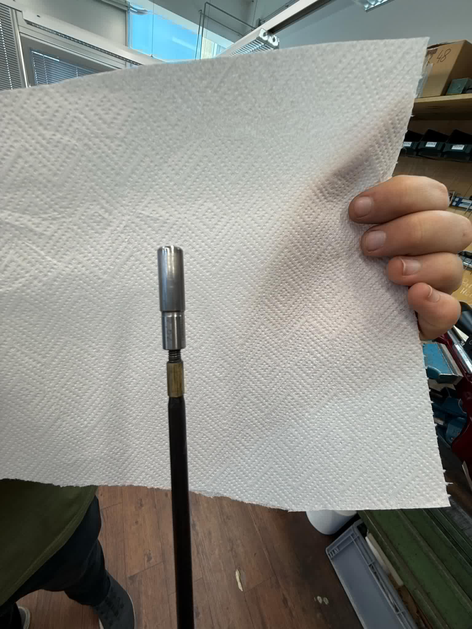

The owner of the rifle felt it wasn’t shooting good enough. He thinks the steel isn’t good. So, he decided to make his own bushing and put it on a cleaning rod and push it down the bore to check the barrel. He feels there are tight spots in it. I’ll guarantee you that he scored the tops of the lands. Barrel is guaranteed junk now.
Any lint, dirt, carbon particles etc.... will get forced between the slug and the bore and your going to do damage. Worse yet.... a steel bushing was made and to what spec it was made to and your pushing it down the bore. Nothing but a disaster here.
Nothing in his email about how he’s cleaning it, how many rounds on it… how it’s shooting etc… not to mention what the diameter/spec he made his custom steel bushing to in order to check the bore.
Yes.... No warranty being given.
I'm refraining from using very choice words right now!
