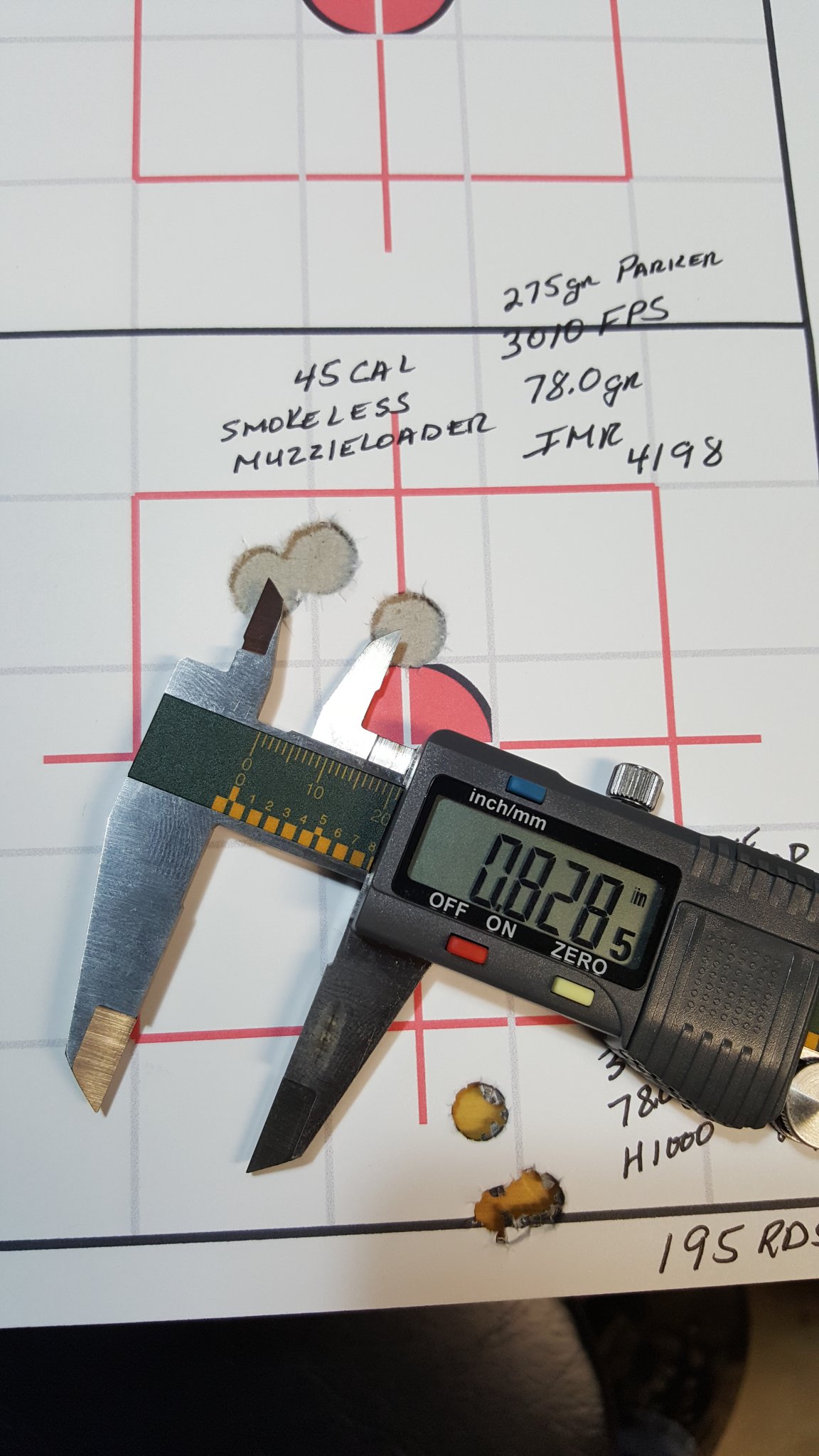

I have a smokeless muzzleloader built on a Remington short action, that regularly shoots over 3000fps with sized 275gr Parker Ballistic Extreme bullets and it is very accurate.
My muzzle loader uses sabots with all my loads so no brake. And 3000 fps with a 300 gr projectile? Really? Unless your using the slowest powder available in a 40" barrel, I call BS. I’m running close to published max with a 240 gr projectile and only getting 2400 fps.
I think the sabots make the difference. I think most of the people running those high speed heavy bullets are running them bullet to bore after running them through a sizer due to get perfect diameter.

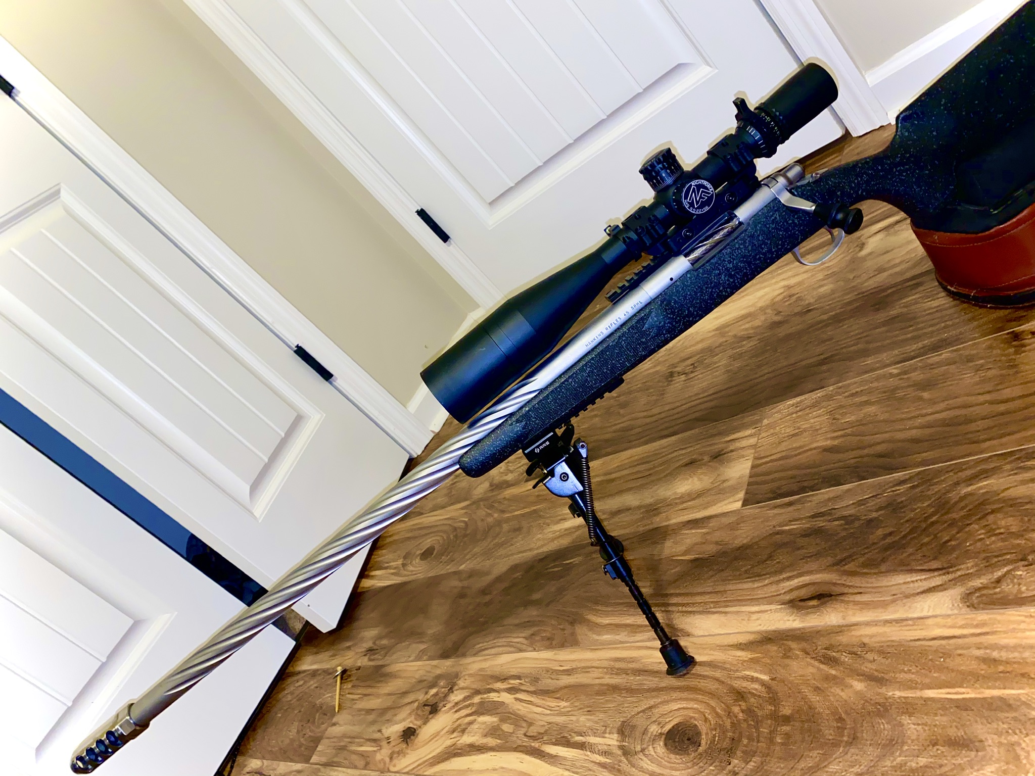

I built a .45 cal on a Remington 700 with a Bartlein barrel, 28”. Get all your components from Luke Horak at Arrowhead Rifles. I had Swinglock make a custom sizing die out of a drop of barrel, and am shooting Luke’s 310gr APBs at 2850 with a mild load of H322, could probably stretch to 3100ish at the next node and still be under safe pressures. With full form sizing, the accuracy is amazing. I swapped to Blackhorn 209 for an elk hunt last week, got 2400fps with the same bullets, and they worked awesome. Elk ran 20 yards with a nice wide blood trail, not that you need it when they die within 20 yards. I highly recommend dealing with Luke, and his LRMP breech plug system, and he will also build you a complete gun if you choose to go that route.

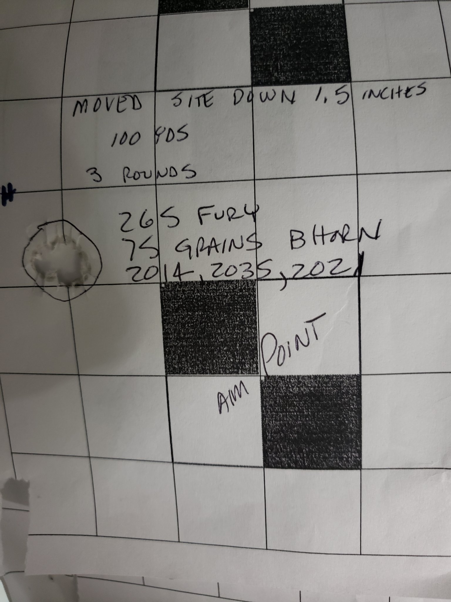

My 2019 Paramount 45 with Blackhorn 209 is as close as you can get to a smokeless MZ.
I shoot Fury 265 STB's and have had zero issues with ignition.
100 yds.
Used veterans discount. $750 to my door.
No sabot. Bullet sized to bore with Hankins sizer.
