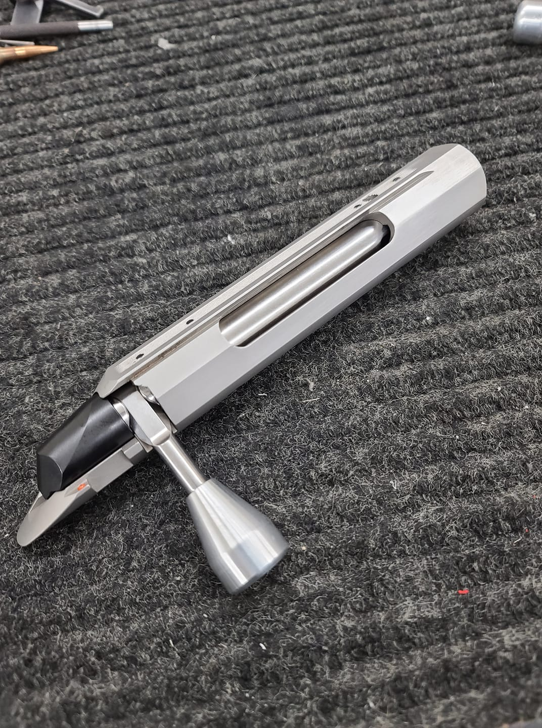

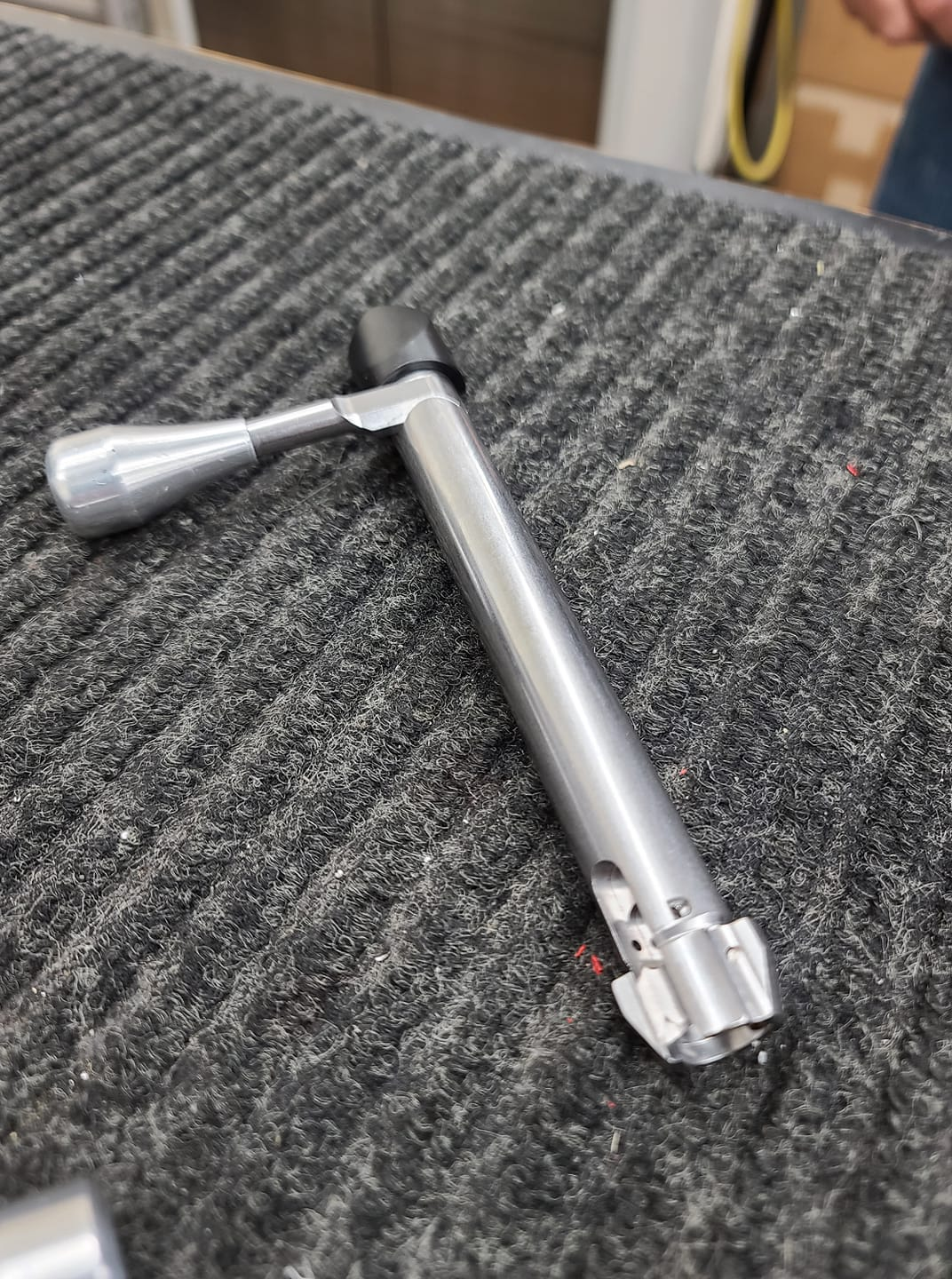

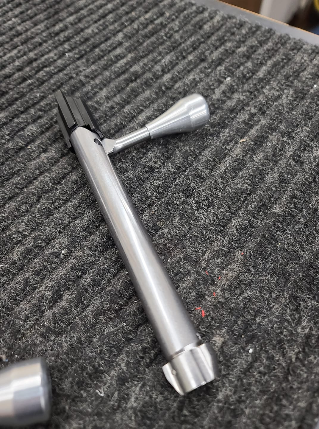

    Direct replacement bolts for the Tikka actions are now a thing.
    Details:
    Stainless bolt body and handle
    Complete fire control
    Bar stock machined bolt shroud. -No plastic or Zinc casting
    .480 and .545 diameter bolt faces available We might do a .590 for Lapua and/or a .390 for 223 stuff later
    RIGHT HANDED only. Sorry Lefties.
    M16 style extractor

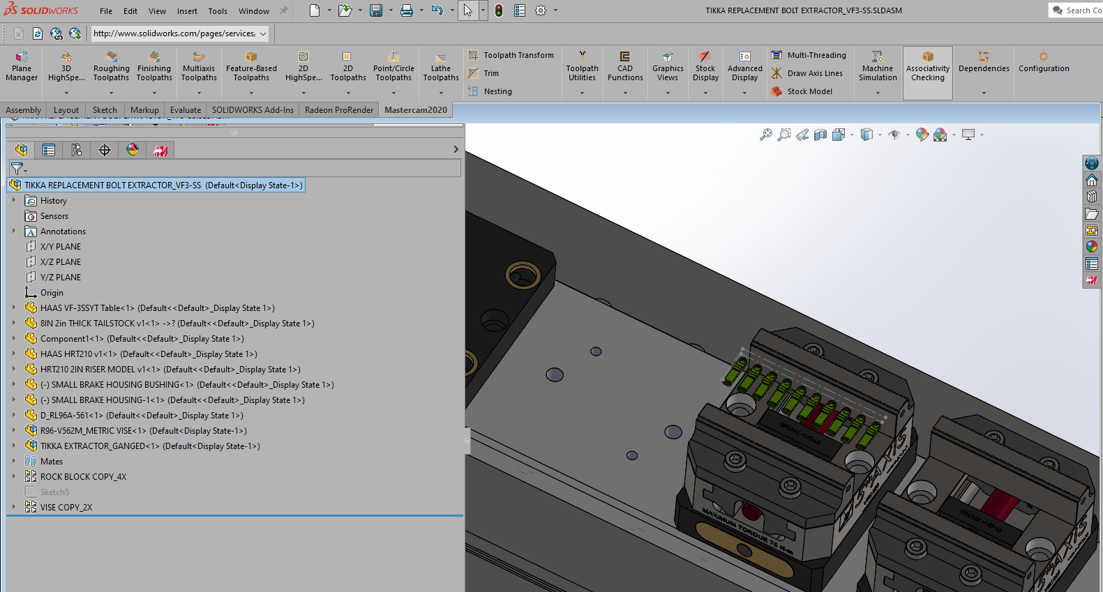

    We have inventory on the floor. I'm currently working on the extractors and they'll be done hopefully this week. They still have to go to heat treat but that doesn't take very long.
    Price: $375.00 for the complete drop on bolt. These will only be sold as complete units.

    Beautiful! Looking forward to this as a better option for replacements.
    Will the fire controls from this bolt fit into the existing tikka body? I’ve known tikkas (at least mine) to be hard on firing pins and seem to eat away at them sooner than other rifles.
    Tikka just improved... Cool stuff!
    heard more than 1 story of crummy CS after issues with bolts, and Beretta not selling a replacement.
    That bummed me out as I have been happy with their stuff.
    Now if you just made Tikka AICS compatible DBM...
    Reactions: 6.5Hunter12
    Will you be selling coated or bare metal?I’m assuming it will be slip in and go?
    Thanks for the update.
    These bolts are made from the same type of SS that the original Tikka bolts are made from. Therefore, no coating is applied or required. The shrouds are carbon steel and they are black oxide finish.
    As for "slip in and go."
    A number of folks have inquired about how "drop-in-capable" these parts are. I can tell you this:
    I have a small gaggle of Tikka receivers and take off barrels here at the shop. Yesterday we assembled one just to see how things would go. It all worked. The gun went together just as one would hope. We had zero issues with breech clearance or Headspace.
    I look at this as encouraging because the parts are random pieces accumulated over several years. The fact they all went together as expected strongly suggests that Tikka runs a pretty tight ship. I feel pretty good about standing behind our bolts being able to work with switch barrel setups. (Assuming the barrels chambered by a 3rd party are done correctly).
    Hope this helps.
    C.
