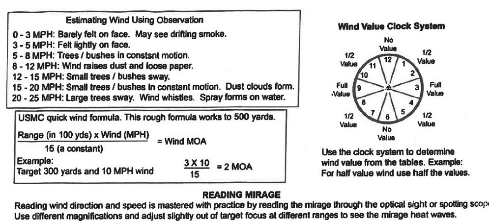

EFFECTS OF WEATHER
For the highly trained sniper, the effects of weather are the main causes of error in the strike of the bullet. Wind, mirage, light, temperature, and humidity affect the bullet, the sniper, or both. Some effects are minor; however, sniping is often done in extremes of weather and all effects must be considered.
WIND CLASSIFICATION
Wind poses the biggest problem for the sniper. The effect that wind has on the bullet increases with range. This is due mainly to the slowing of the bullet's velocity combined with a longer flight time. This allows the wind to have a greater effect on the round as distances increase. The result is a loss of stability.
a. Wind also has a considerable effect on the sniper. The stronger the wind, the more difficult it is for him to hold the rifle steady. This can be partly offset by training, conditioning and the use of supported positions.
b. Since the sniper must know how much effect the wind will have on the bullet, he must be able to classify the wind. The best method is to use the clock system. With the sniper at the center of the clock and the target at 12 o'clock, the wind is assigned three values: full, half, and no value. Full value means that the force of the wind will have a full effect on the flight of the bullet. These winds come from 3 and 9 o'clock. Half value means that a wind at the same speed, but from 1,2,4,5,7,8, 10, and 11 o'clock, will move the bullet only half as much as a full-value wind. No value means that a wind from 6 or 12 o'clock will have little or no effect on the flight of the bullet.
WIND VELOCITY
Before adjusting the sight to compensate for wind, the sniper must determine wind direction and velocity. He may use certain indicators to accomplish this. These are range flags, smoke, trees, grass, rain, and the sense of feel. However, the preferred method of determining wind direction and velocity is reading mirage (see paragraph d below). In most cases, wind direction can be determined simply by observing the indicators.
a. A common method of estimating the velocity of the wind during training is to watch the range flag.
The sniper determines the angle between the flag and pole, in degrees, then divides by the constant number 4. The result gives the approximate velocity in miles per hour.
b. If no flag is visible, the sniper holds a piece of paper, grass, cotton, or some other light material at shoulder level, then drops it. He then points directly at the spot where it lands and divides the angle between his body and arm by the constant number 4. This gives him the approximate wind velocity in miles per hour.
c. If these methods cannot be used, the following information is helpful in determining velocity.
- Winds under 3 miles per hour can barely be felt, although smoke will drift.
- A 3 to 5-mile-per-hour wind can barely be felt on the face.
- With a 5 to 8-mile-per-hour wind, the leaves in the trees are in constant motion.
- With a 12 to 15-mile-per-hour wind, small trees begin to sway.
d. A mirage is a reflection of the heat through layers of air at different temperatures and density as seen on a warm day.
With the telescope, the sniper can see a mirage as long as there is a difference in ground and air temperatures. Proper reading of the mirage enables the sniper to estimate wind speed and direction with a high degree of accuracy. The sniper uses the M49 observation telescope to read the mirage. Since the wind nearest to midrange has the greatest effect on the bullet, he tries to determine velocity at that point. He can do this in one of two ways:
(1) He focuses on an object at midrange, then places the scope back onto the target without readjusting the focus.
(2) He can also focus on the target, then back off the focus one-quarter turn counterclockwise. This makes the target appear fuzzy, but the mirage will be clear.
e. As observed through the telescope, the mirage appears to move with the same velocity as the wind, except when blowing straight into or away from the scope. Then, the mirage gives the appearance of moving straight upward with no lateral movement. This is called a boiling mirage.
A boiling mirage may also be seen when the wind is constantly changing direction.
For example, a full-value wind blowing from 9 o'clock to 3 o'clock suddenly changes direction. The mirage will appear to stop moving from left to right and present a boiling appearance. When this occurs, the inexperienced observer directs the sniper to fire with the "0" wind. As the sniper fires, the wind begins blowing from 3 o'clock to 9 o'clock, causing the bullet to miss the target therefore, firing in a "boil" can hamper shot placement. Unless there is a no-value wind, the sniper must wait until the boil disappears. In general, changes in the velocity of the wind, up to about 12 miles per hour, can be readily determined by observing the mirage. Beyond that speed, the movement of the mirage is too fast for detection of minor changes.

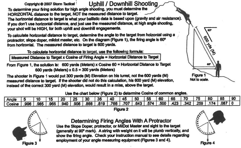

Cosine Angle Formula

Angled shooting
Re-posted with Author Permission - JC Comfort
I wanted to share what I have learned about angled shooting. When the guys and I started out, we would constantly push ourselves to learn more. We covered things like range estimation, moving targets and angles. Before I really started researching I would hear different things, from different people. Some folks said, you would impact differently depending if the shot was up hill or downhill (that is not true). The riflemen’s rule was complicated and took me awhile to decipher it. The math wasn’t something I was going to be able to do quickly out on the range or in the desert.
After some time and practice we figured out how to account for angled shots. We found we preferred using the modified rifleman rule. When you have an angled shot think back to your days in geometry glass. The pythagorean theorem is a way to solve the problem if you have the correct variables. The Pythagorean theorem demonstrates the different between the line of sight range and the actual horizontal range. The line of sight range will be greater than the actual horizontal range. This will cause you to shoot over your target regardless if the shot is up hill or downhill. The severity of the angle will exacerbate the effect.
The easiest way to correct for an angled shot is to measure the angle, use a cheat sheet to find the correct cosine, once you know the cosine take your DOPE for the line of sight range and multiply that by the angle cosine. (A cosine is a way to express an angle in decimal form)
Example:
Line of sight range = 600 yards
Angle = 25 degrees
Cosine = 0.906
DOPE = 11.5 MOA
11.5 (DOPE) x 0.906 (Angle cosine) = 10.419 MOA , dial 10.5 MOA
