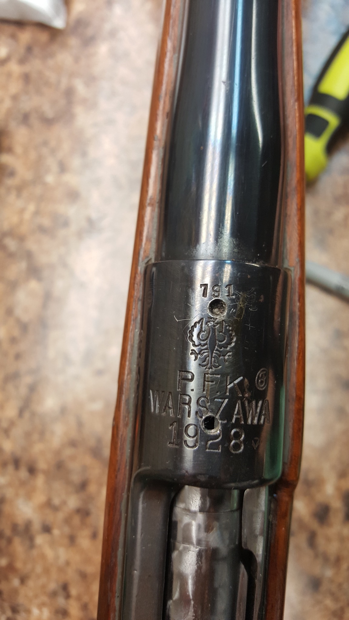

    Bought it off of Armslist. It has been rebarrled to 243 Win and has a Mannlicher Stock on and it has been bedded. Owner thought it was a 1:12 twist, but the manufacturer and smith are unknown. It isn’t in the best of shape, but I think it will be fine for a first deer rifle. It has an old Weaver TV style scope on it.
    I’ll put some pictures up in a bit.
    I’m trying to determine when it was made and everything I’ve come across shows the serial number having a lettered prefix, however this one does not. The serial number is four digits followed by an X.
    Can anyone’s point me in the direction to learn more about the serial number or maybe K98s in general?
    Thanks.
    Reactions: h3dgehawk
    It’s a Kar98a pattern rifle produced at the Polish state factory in Warsaw. Complete shame it was sporterized as most were sent to Spain during the Spanish civil war and unmolested examples are very rare and certainly expensive.
    Repro what? It’s a sporterized small ring Mauser, gunsmith special. They made excellent hunting rifles back in the day. Unfortunately a lot of valuable and scarce rifles like this one were stripped off almost all value in the process.
    This gun if in original configuration and matching numbers would easily sell between 1500-2000 dollars.
