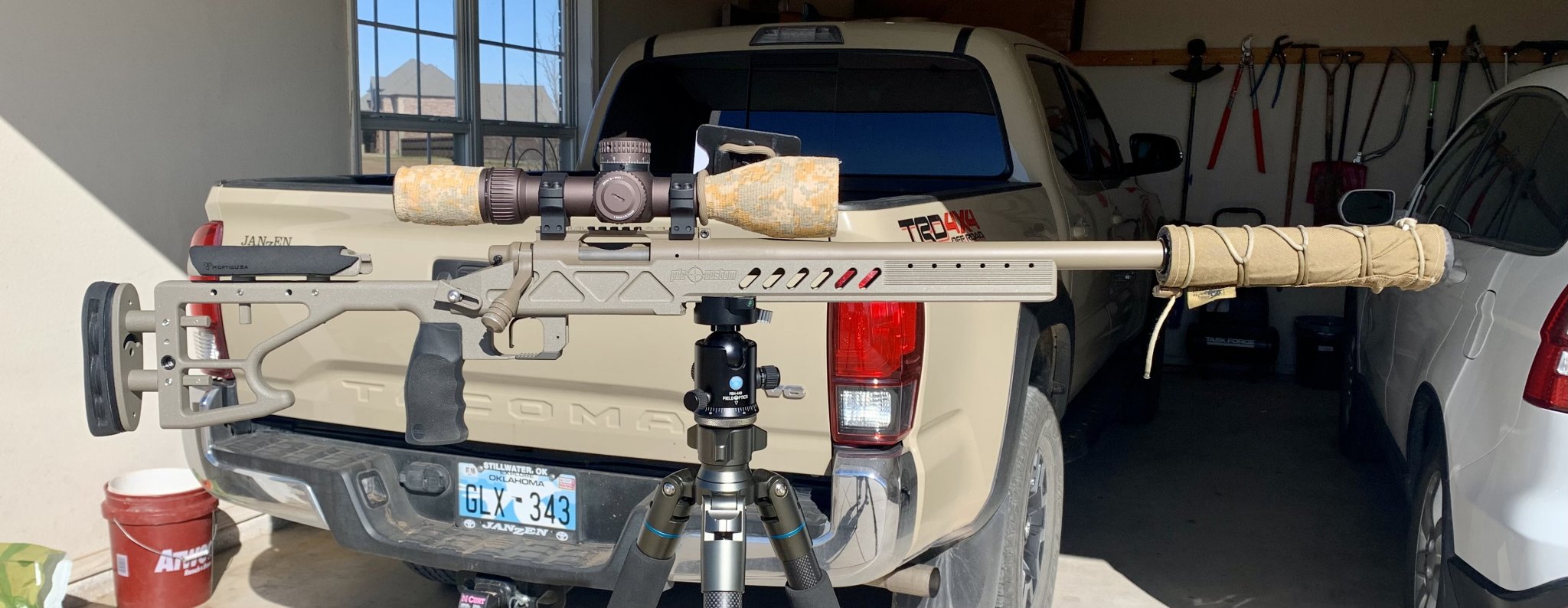

    If you want shorter I would look into an xlr element. You can slide the sucker all the way up and then extend as they grow.
    Other than that an old wood stock and a hacksaw is a good cheap standby. With the parts you listed that’s not on the table though.
    A magnesium element makes it even lighter which normally I would say to retain sooome weight for recoil etc but with the can it should be good.

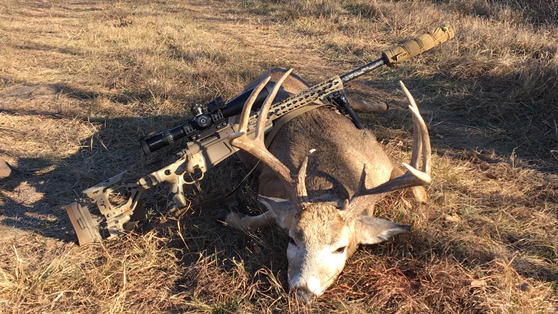

    I think there’s an XLR Envy in the PX for cheap. My daughter started shooting and shot her first few matches on an XLR chassis because it was light and short enough for her. It’s hard to beat them for hunting setups. My only suggestion is to pick an action and chassis that are patterned around the r700 so you have the full range of options.

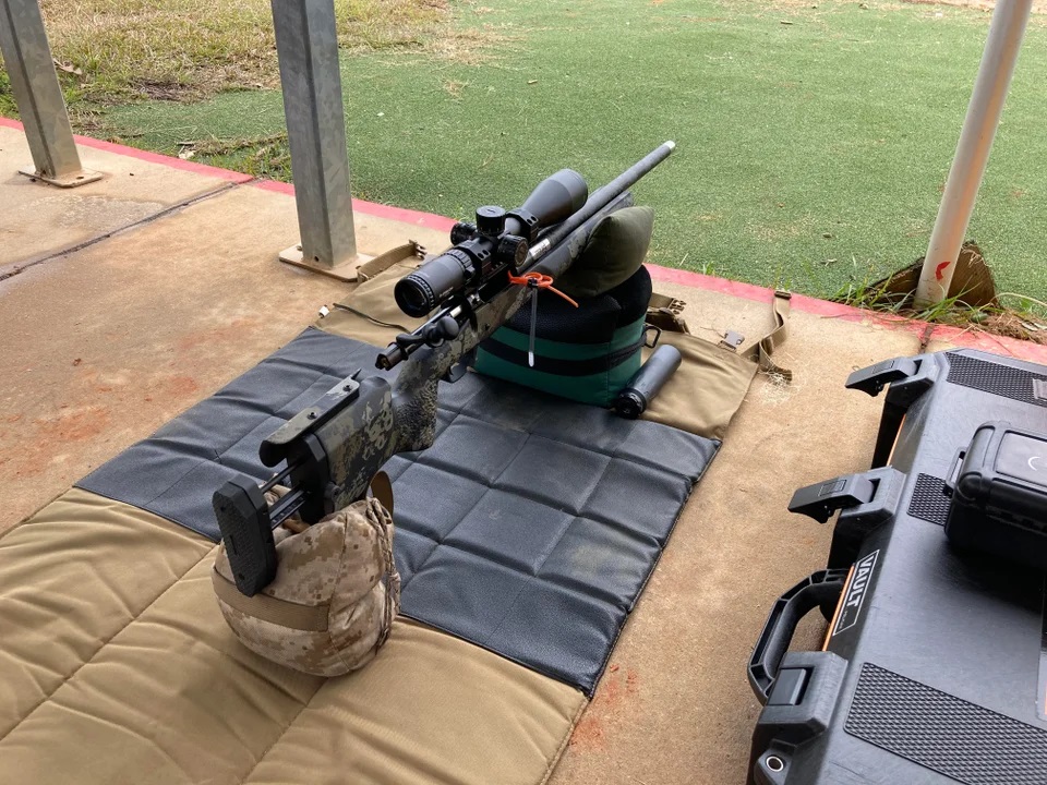

    Hunted for several years with this setup. Trued 700 action, WTO Switchlug , proof CF 6.5 Creedmoor @ 22” and AICS AX chassis. Downside it was heavy.
    Switched the barrel action to a PDC chassis and made it a few pounds lighter.

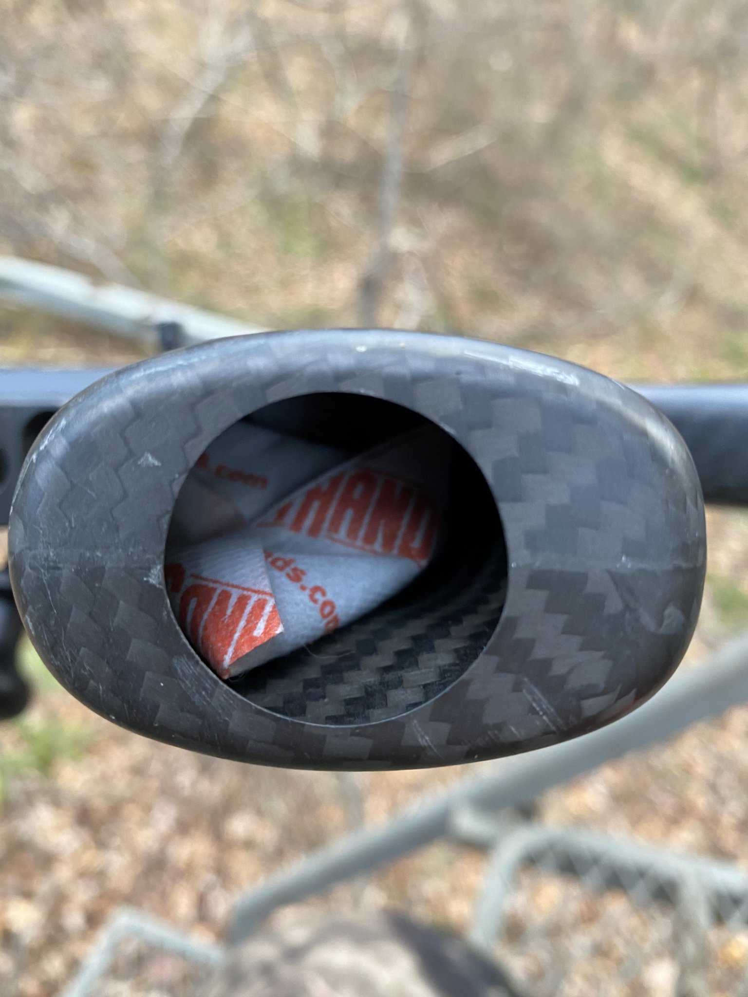

    I've got a Manners CS-2 with mini-chassis and CF shell... right around 2.7 lbs. LOP goes short enough for my sons to achieve appropriate LOP and eye relief and goes out quickly and easily enough for me to do the same (or near enough) in a couple seconds. Built with a 20" Proof CF and an ARC Nuc G2, the bare rifle weight is right around 7.5 lbs in 6.5 Creed.

    Or carbon fiber like a HNT 26.

    The HNT26 is probably the best chassis for your application, rifle season gets cold and the metal can be unpleasant to touch so the buttstock, grip and forend being carbon fiber help keep the rifle feeling warmer. Additionally it has one special advantage most chassis don’t
    You can stuff a hand warmer in the grip to keep your hand nice and warm.
    I hunt central PA for pretty much the same list of animals in probably the same terrain as you except I have a field that goes out to 600 yards. My choice was an ARC Archimedes in an MDT HNT26 chassis with a Nightforce NX8 2.5-20 with an 18” 6.5 PRC CF Barrel. Rifle weighs almost exactly 10 pounds with a Nomad Ti suppressor and an empty mag and the PRC exceeds the velocity of a 26” Creedmoor while still being shorter and suppressed.
    Apparently been using that wrong. 🤣
