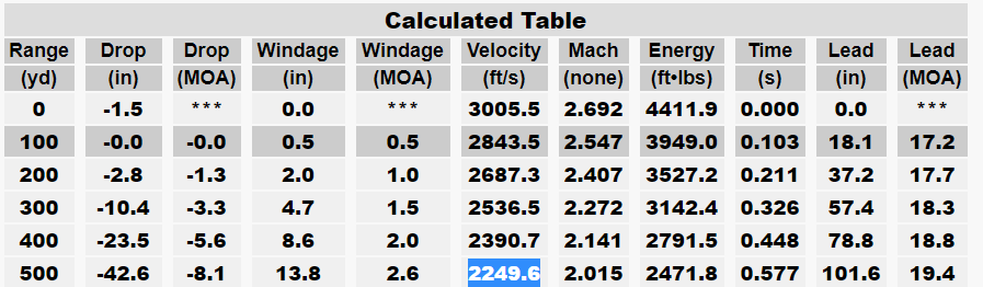

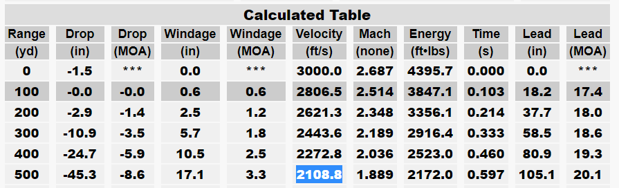

One has a G1 BC of .500 and the other has a G1 BC of .600.
The velocity at 500 yards of the .500 BC bullet will be the same as the 0.600 BC bullet at 600 yards.
No. No on both velocity and windage.
Using JBM, default inputs, with a 308 with a .5 G1...
And now, a 308 with a .6 G1...
You are missing something bud...
You are comparing both at 500 yards.
Show us the 600 yard numbers for the 0.600 BC. Those will closely correlate the the 500 yard numbers of the 0.500 BC.
600-68.6-10.920.43.22113.31.8931982.90.715125.820.0
