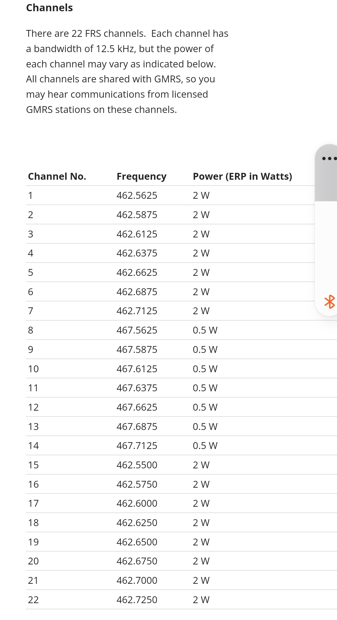

There are frequencies you can transmit on without a HAM license (FRS); however Baofengs' output exceeds the allowed wattage, so it's technically not legal to use a Baofeng on those frequencies. ...Maybe if you dial down the wattage, can't remember if that's kosher.
These are the frequencies used by walkie-talkie type radios. Without getting some elevation max range is 6 miles before the curvature of the earth gets in the way.
https://www.fcc.gov/wireless/bureau-divisions/mobility-division/family-radio-service-frs
It is not legal to use any radio with a detachable antenna on the family radio service regardless of power output. It is not just "technically not legal," it's not legal at all. Changing the wattage does nothing.
