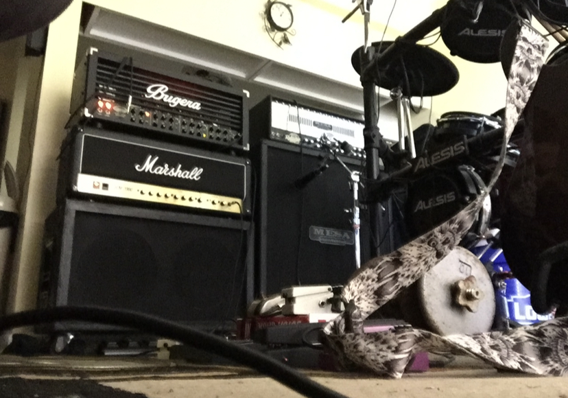

Tell us why if you decrease the resistance of a speaker (say from 8 ohms to 4 ohms) why is the amplifier able to drive it at nearly double the wattage ?
Yea, I know, confusing, right ?

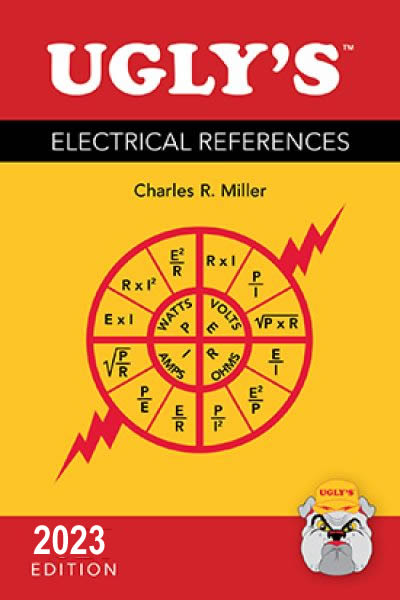

current (amps, I) = voltage(V) divided by resistance(R)
power (watts, W) = VxI =IxIxR
however, things do get a little different when you go to AC instead of DC because things like inductance and capacitance become reactive. on your amplifier, your speaker is NOT a resistive load, but an inductive load and the ohms rating of the speaker is refering to impedance. the ampifier itself also likeley has lots of reactive components. lowering the impedance of the speaker makes it easier to push more power - BUT, you get the most power in the load when it is impedance matched to the source (this is why the wrong antenna can burn out a transmitter)

Read it, learn it, love it.
^^^^This right here.^^^^
I actually had this pic copied, and was about to past it. Then I saw yours.
This thread has given me a headache. 😄
Edit: Oh, and it’s the amps that kill you. If you’ve ever been hit by a spark plug wire, you’ve been hit with 20,000 to 50,000 volts. All it did was make you hurt yourself. It didn’t hurt you because the current was so low. Increase the current, and you get smoke tested.
Reactions: BLEE and Llatikcuf
