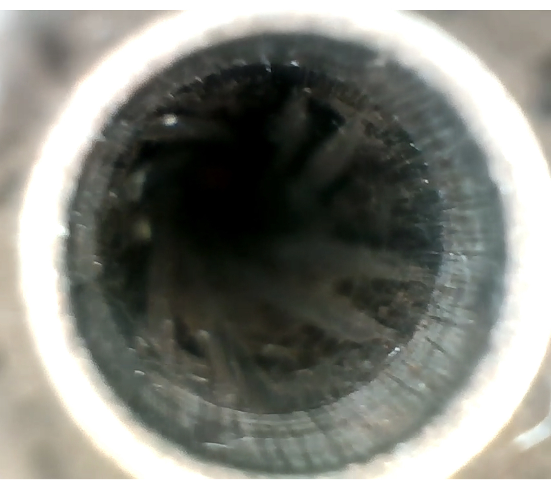

Here’s what’s left of a carbon ring in the freebore of my 6gt. I brushed a lot of it out and still have some work to do to get the barrel back to like new shape.

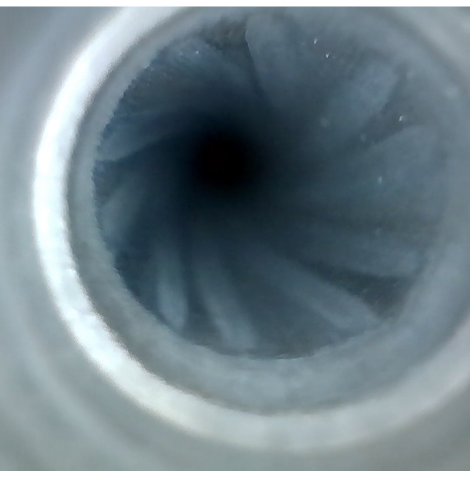

For comparison, the other pic is a .22br with 173rnds in it. Notice the freebore is much cleaner.
I would use some Remington 40x on that barrel and then finish it up with BTE Carbon remover

How many rounds through the 6GT Dthomas?
Was around 525 when small problems started showing at a match and 650 when I stopped shooting due to heavy bolt lift. I’ll be changing my cleaning (from basically never, to after every match). But from other barrels I have scoped, this one is noticeably dirtier.
Interesting, cut rifled?
Yep, bartlein.
My theory is I may have turned necks a little too much. I usually go for .005-.006” clearance.
If I have something like .007 or .008, maybe the necks open a little more on ignition and more carbon is built up around the throat instead of being pushed further and being distributed further down the barrel.
That’s just a half ass theory. I won’t be testing to see if true as I’ll be cleaning more often now and using Borescope to verify.
