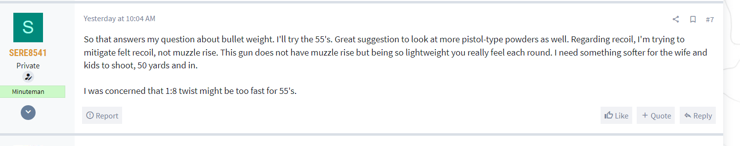

So that answers my question about bullet weight. I'll try the 55's. Great suggestion to look at more pistol-type powders as well. Regarding recoil, I'm trying to mitigate felt recoil, not muzzle rise. This gun does not have muzzle rise but being so lightweight you really feel each round. I need something softer for the wife and kids to shoot, 50 yards and in.
I was concerned that 1:8 twist might be too fast for 55's.

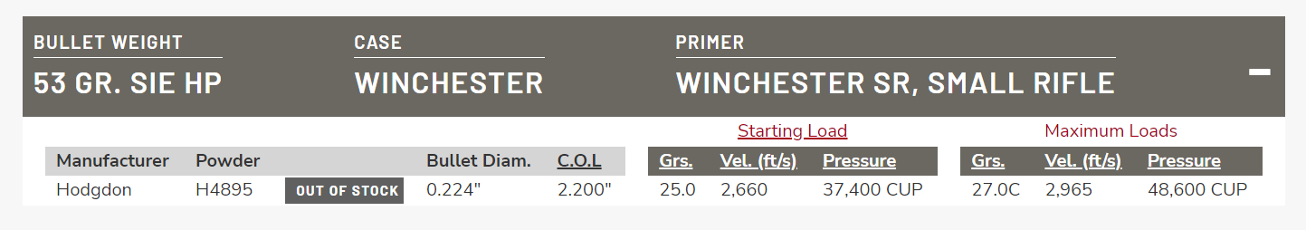

You can use H4895 down to 60 percent of max load for any given bullet that calls for H4895 in published data . You could find the bullet you want to use at those velocities and use H4895 testing for function as you work up . You can load from 60 percent and work up safely in any increment you choose .
One example, although this is from a 15" barrel . You can reduce that 27 grains down to 60 percent .
