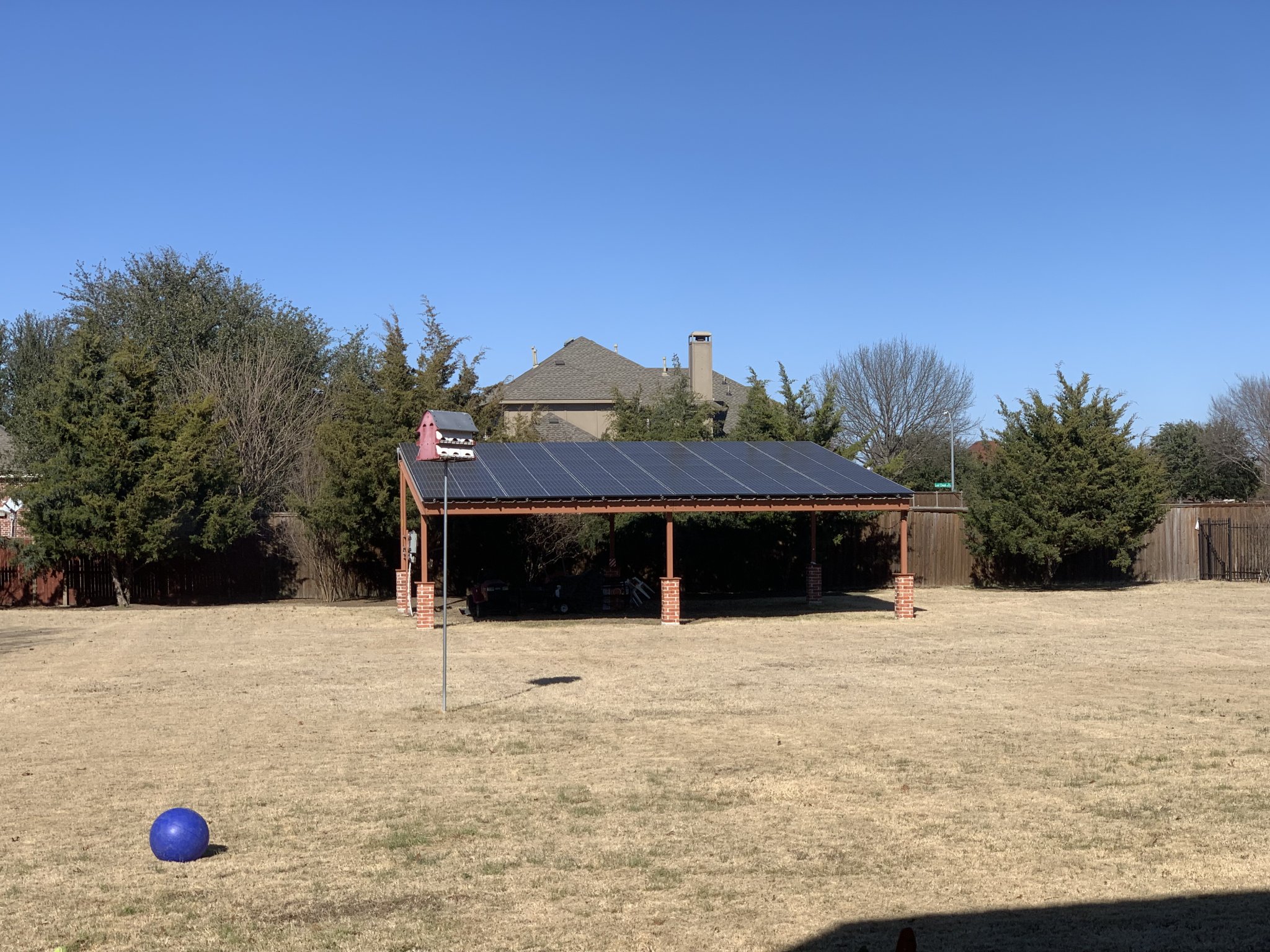

My 15 KW array north of you ~200 miles.
PM me.
