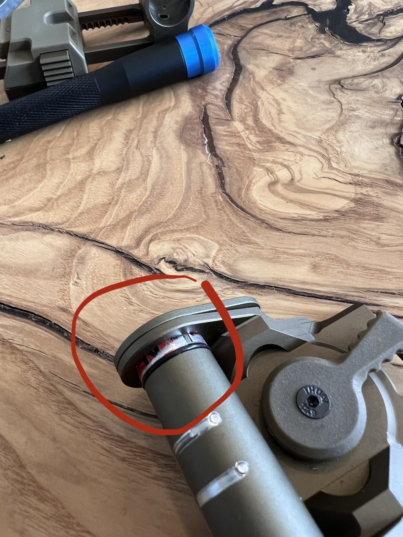

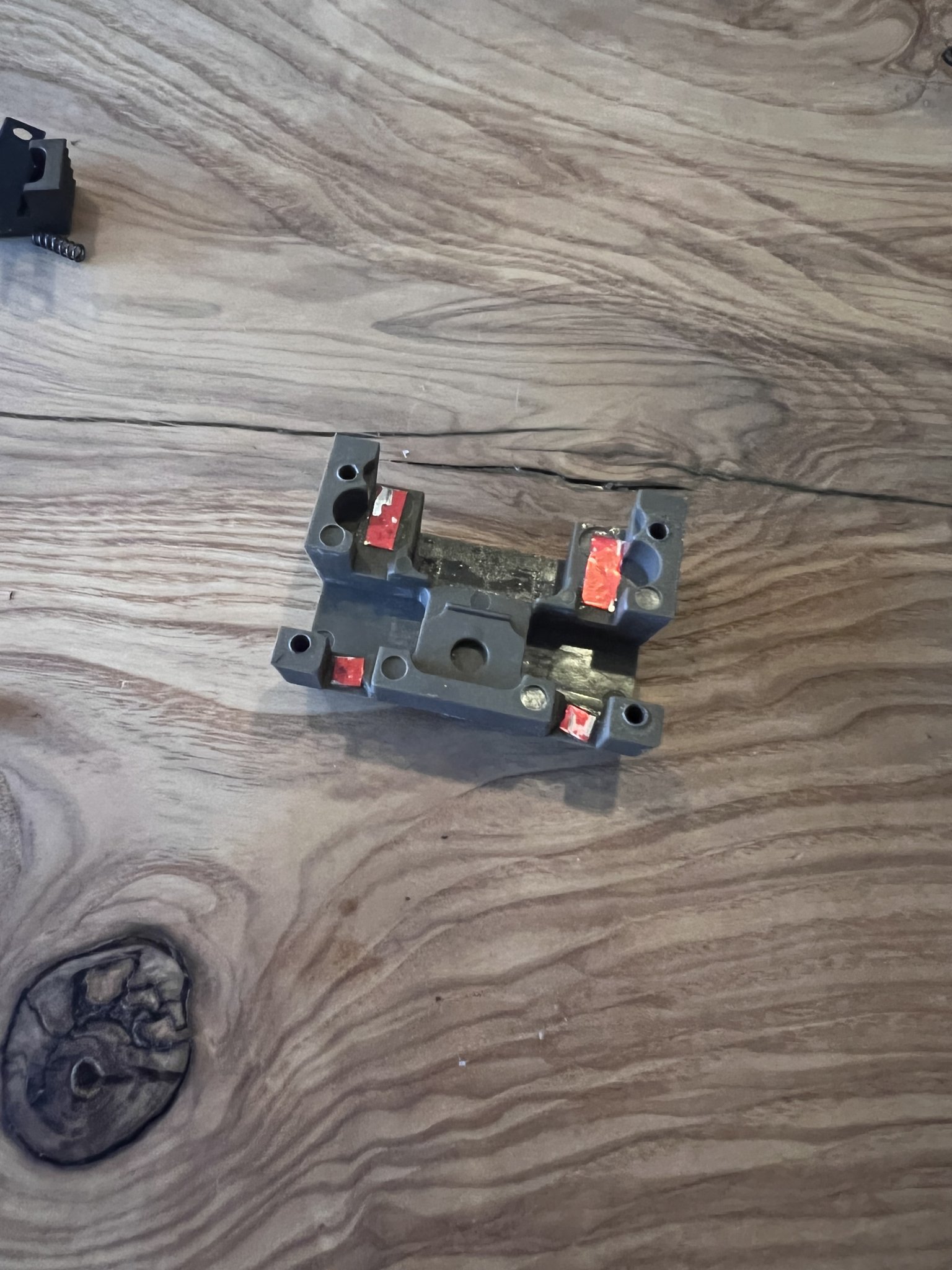

So, for the past 12 years of usage, the inherent Wilcox mount wobble have annoyed the hell out of me. This tutorial is regarding the mount itself, NOT the fit between the mount and shroud.
So I set out to find the solution, and im sharing my results with you to see if it works for others willing to try.
The main issue is the god-aweful tolerances in between the parts of this expensive piece of jewelry.
The solution is to shim the right places.
I took the mount completely apart, cut shims out of a Coke-can, and placed them as seen on the pictures. The one on the «barrel» was the hard one. I found it easiest to tie a thin thread around the shim as you are trying to fit it. All of the shims are press-fit, except for the ones on the dovetail piece, they are glued in place.
For all the other screws, make sure that they are tight and loctited.
As for the result, AMAZING. Its now completely solid in both the stowed and down position.
Good luck, hope it helps👍🏻

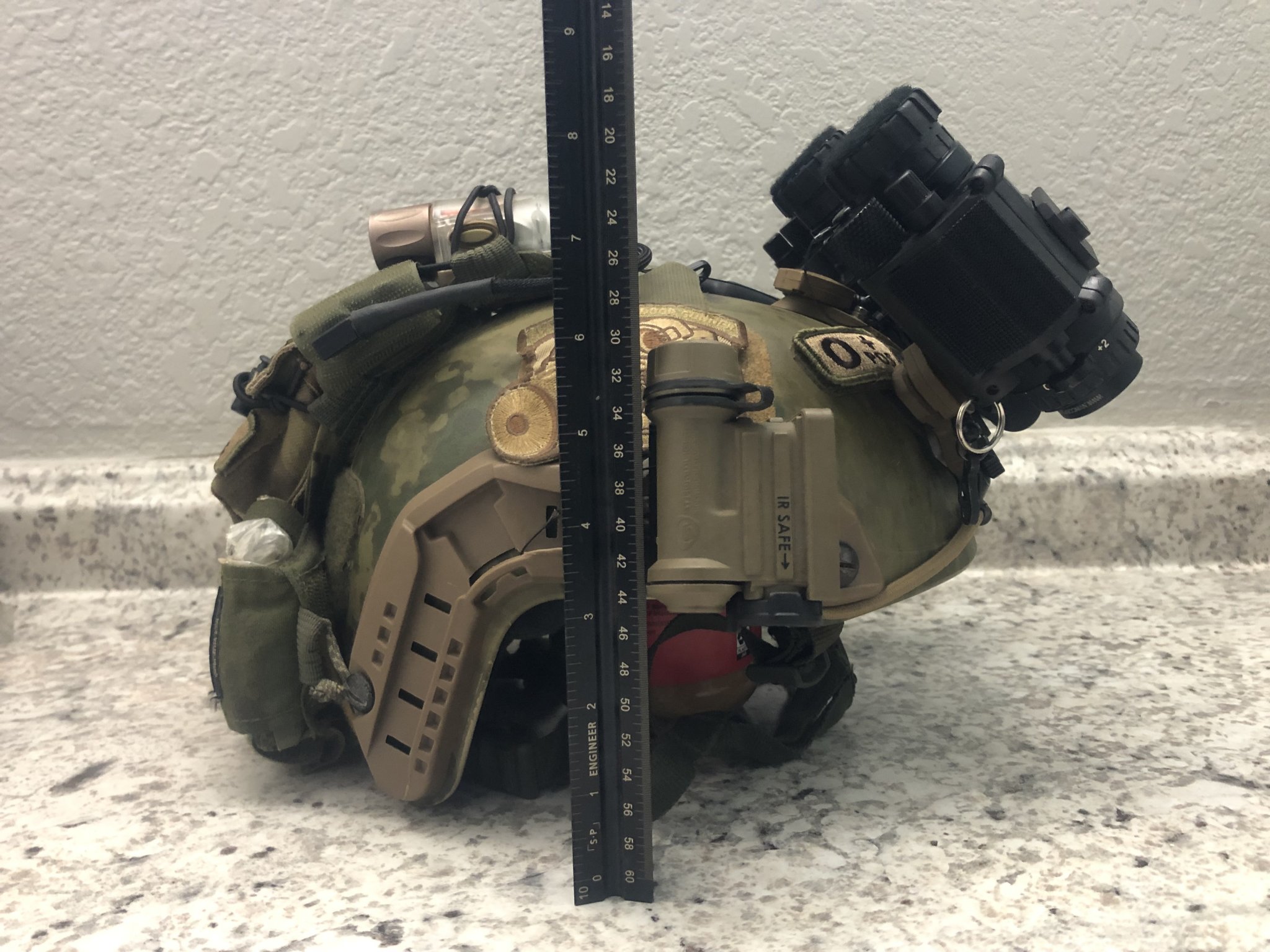

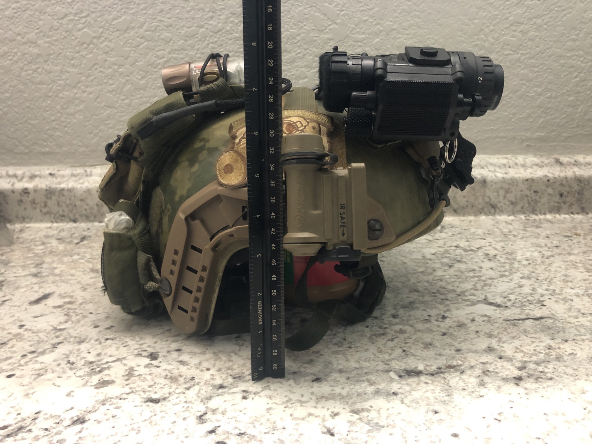

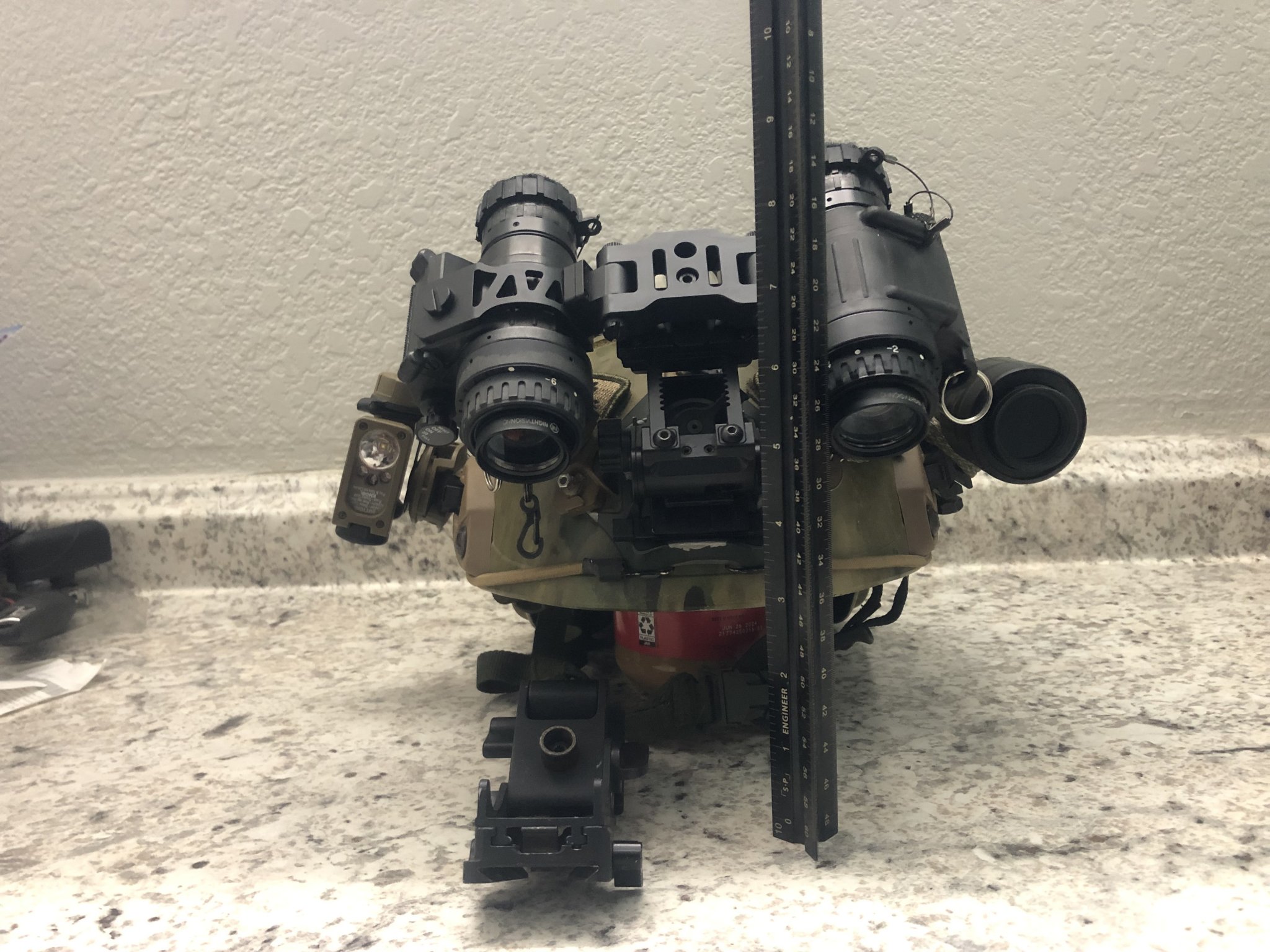

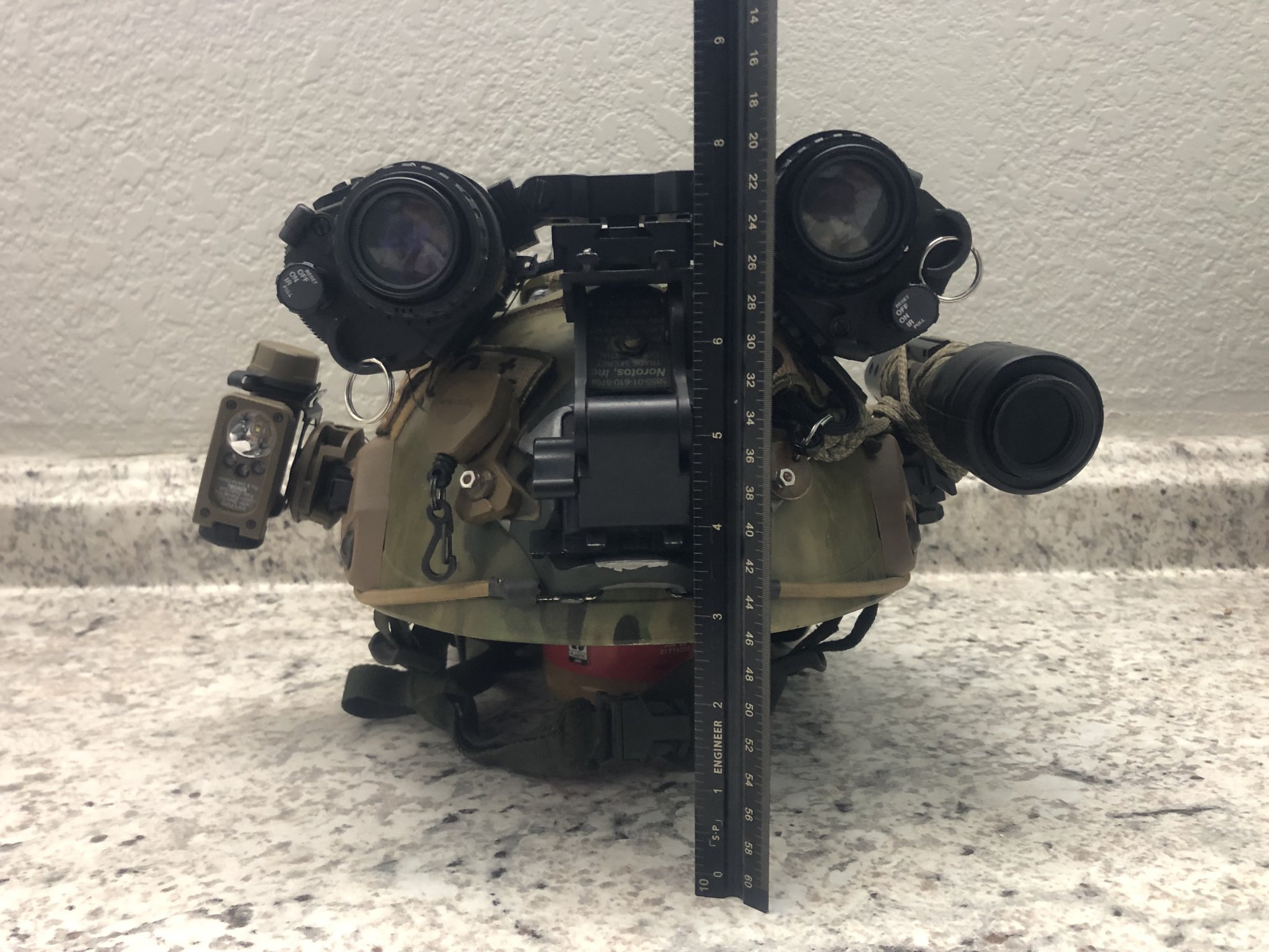

A Norotos Rhino 2 Dovetail lays a set of articulating binos flat on your helmet.
Same with a PVS 14 running a Mod Armory J arm.
Much lower profile than can be achieved with a Wilcox G24.
Here are some photos for you to inspect. As you will see, the Rhino 2 Dovetail places articulating Bino's or 14's at a significantly lower point on your helmet when entering or exiting vehicles and through low thresholds.
Wilcox G24 with Bridged 14's on a Mod Armory Light Weight Bridge Mount.
Norotos Rhino 2 Dovetail with Bridged 14's on a Mod Armory Light Weight Bridge Mount.

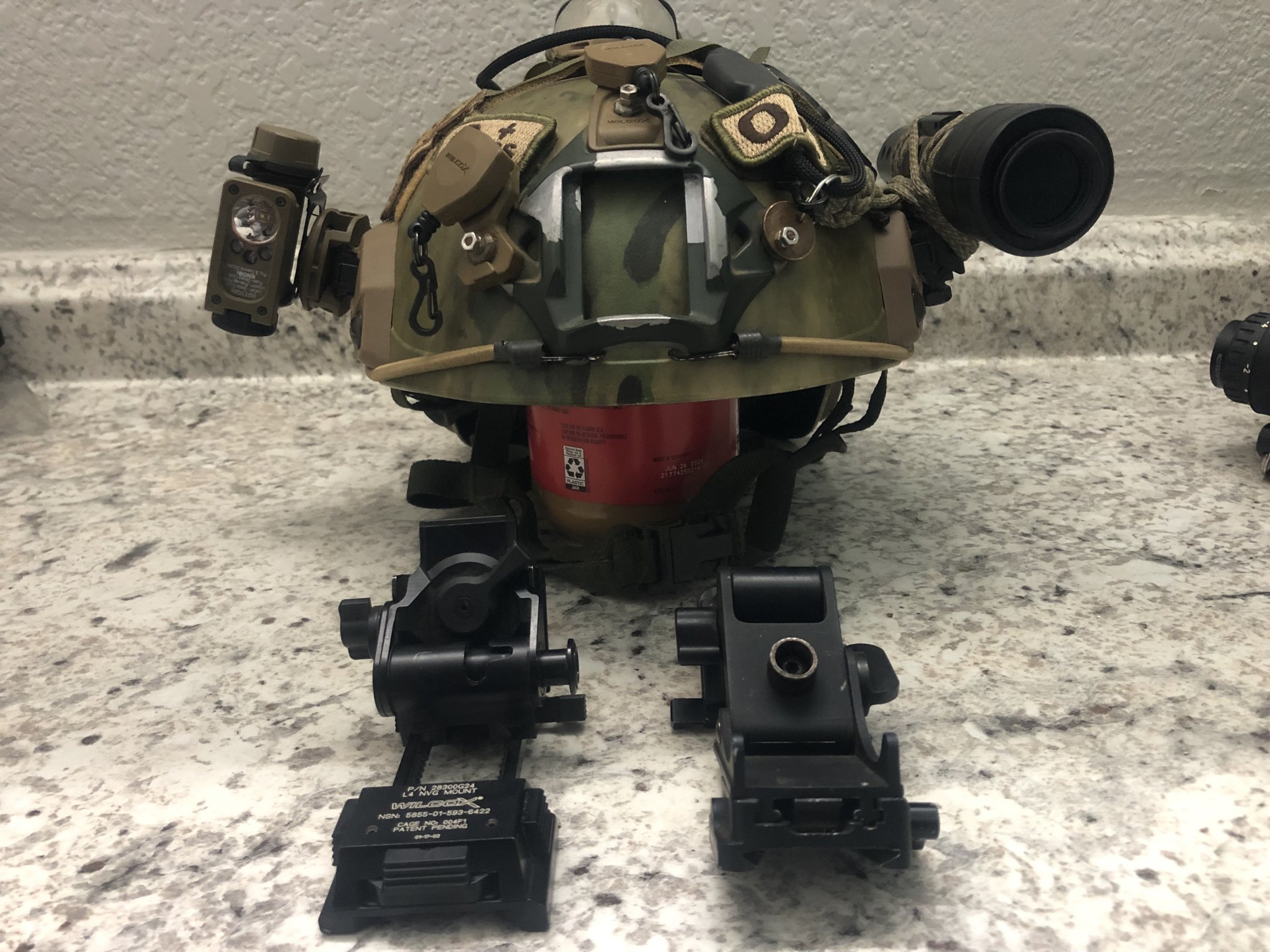

Wilcox G24 and Norotos Rhino 2 Dovetail
Yep, I keep that overpriced and flimsy - wobbly Wilcox G24 mount for occasions just like this, albeit it is regulated to my dustbin and rarely comes out. :LOL:
Rhino 2 Dovetail for the win. :)
