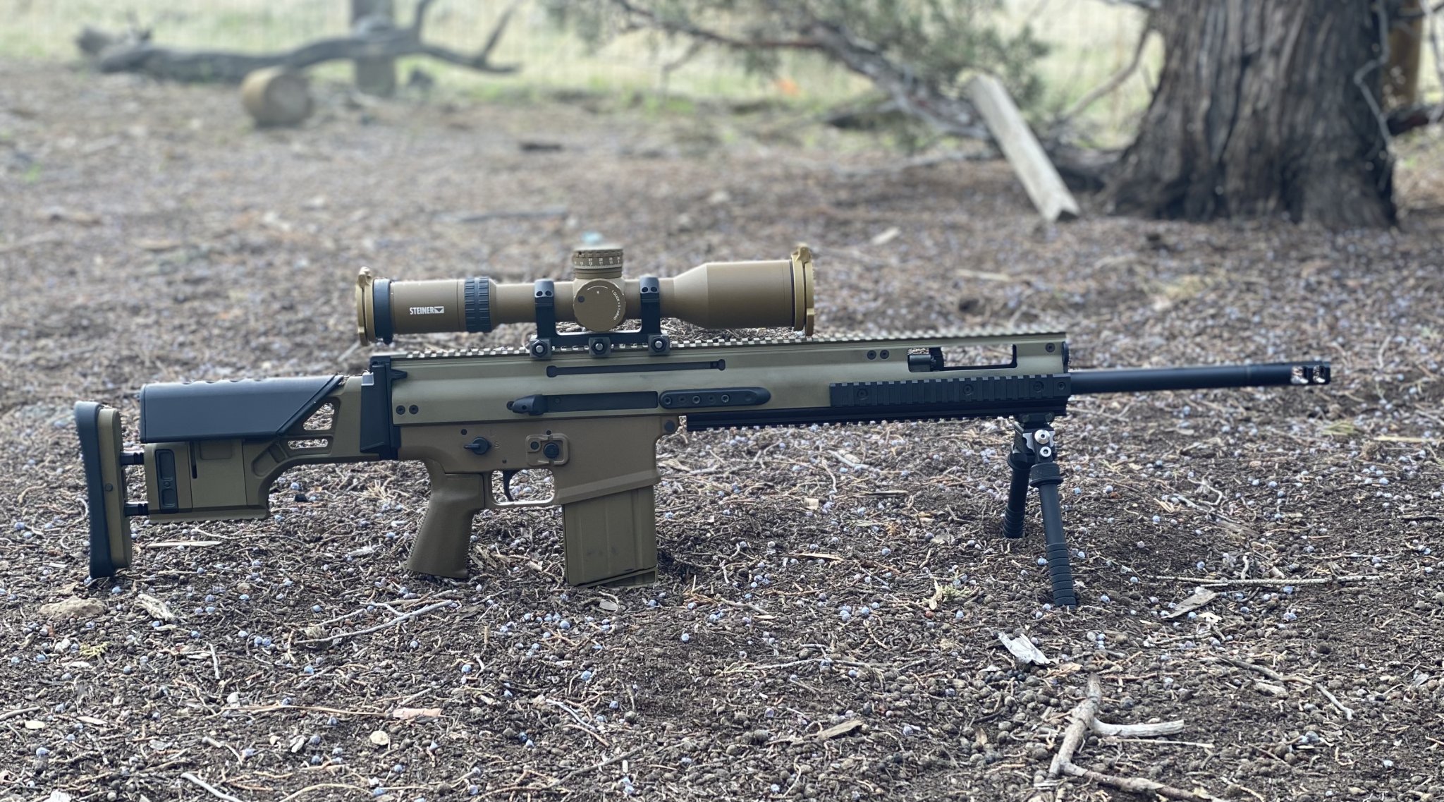

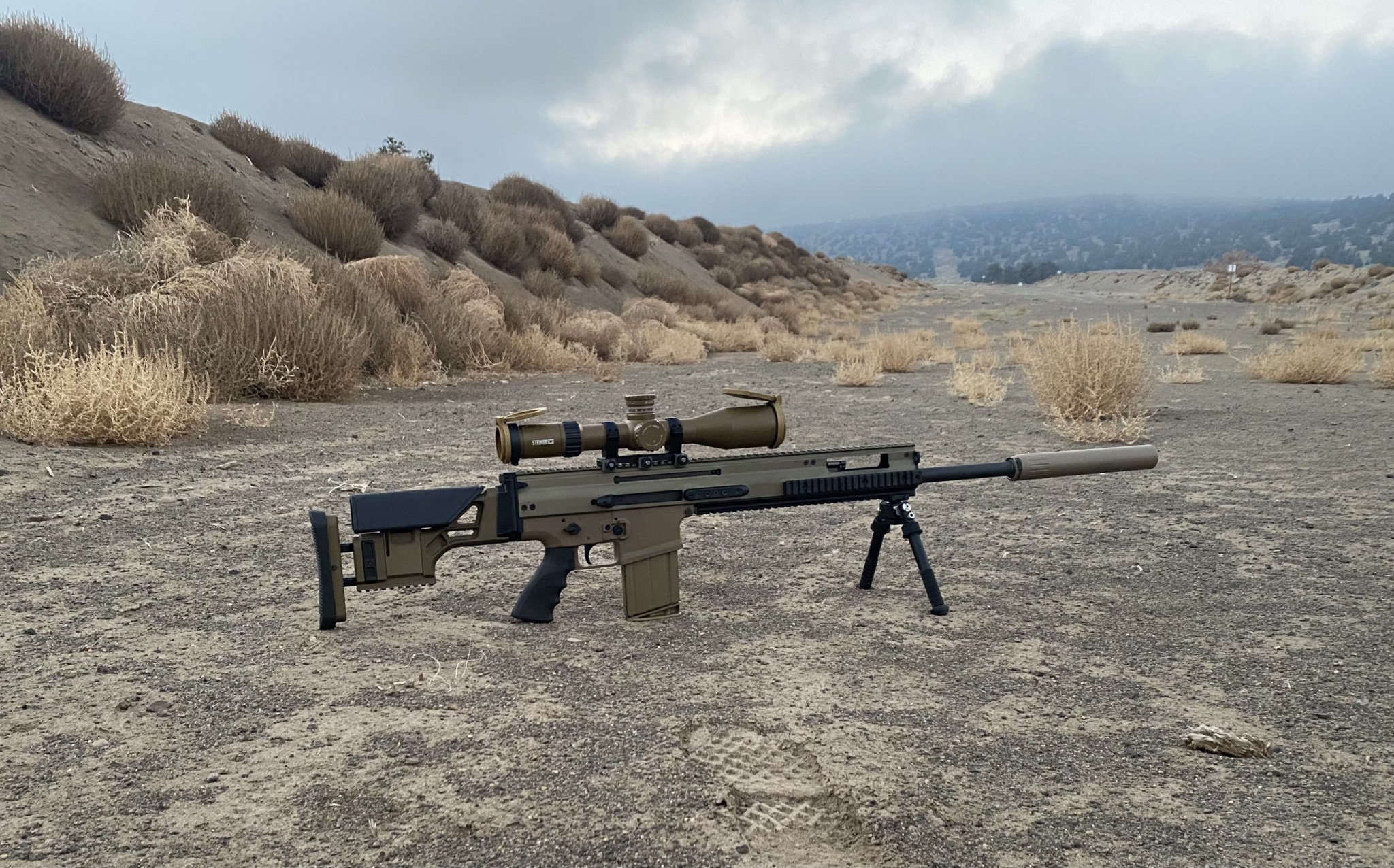

Love my 20
Newly upgraded Steiner 2.9-20 m7xi
