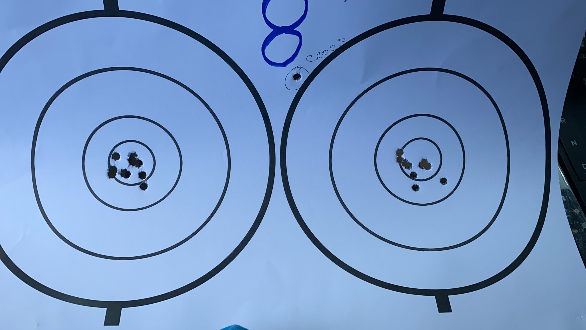

yes, I would pick the 29 out of those. You may find 29.1 or 29.2 to be more forgiving at distance but somewhere in that range you'll find a forgiving node based on that target
I'd be interested to see what your 30.4 or 30.6 group looks like. I feel like your 30.5 is just barely on the wrong side of an OCW node. Not sure if you checked and 30.5 was the last load before pressure signs or not.
i shot 29 grains at a 300 yard match 2 weeks ago . Did pretty good with it . First relay had 200 with 18Xs. I never went over 35 . Now you have me thinking . But won’t that be much harder on brass ?
I don't know where your pressure is so I'm not sure. I'm more or less just curious. If it's up near pressure signs I would definitely go with the 29. Also if the 29 has good ES you can always roll with that since that will mitigate vertical stringing. And if "I never went over 35" is in response to a powder charge I definitely wouldnt go there. I'm saying 30.4 may be a node, not 35. 35 will not only be hard on brass it'll probably wreck your rifle.
My bad ! I meant 30.5 . And if I remember I had a little sticky bolt and large crater at 30.5. Not a pro at reading pressure so that’s as high as I dared to go . And unfortunately no chrono so no idea on ES .
Oh ok yeah I'd stick with 29 then. I just ran into a couple of your other posts in the F Class forum and from what I can tell your ladder test gave basically the exact same outcome. 3,4,5,6 were your node on that and it ranged from 28.7-29.2 if I remember correct so I do believe with that info and this info you hit the right node. Granted your ladder test didn't go up past 30.1 but if you are getting bolt lift at all around 30.5 then it's not worth trying 30.4 because that will from shot to shot be effecting your overall run out and other factors. The only advice I could give is that you try to sweet talk someone with a Chrono ( preferably a Labradar ) and figure out what your ES with that load is. After looking through targets that you posted id say your ES is pretty tight. I mean that 30 round picture you posted on another thread shot out the X ring with only a couple outside the X ring so your ES is right there, I'd venture a guess at right around 15 or so.

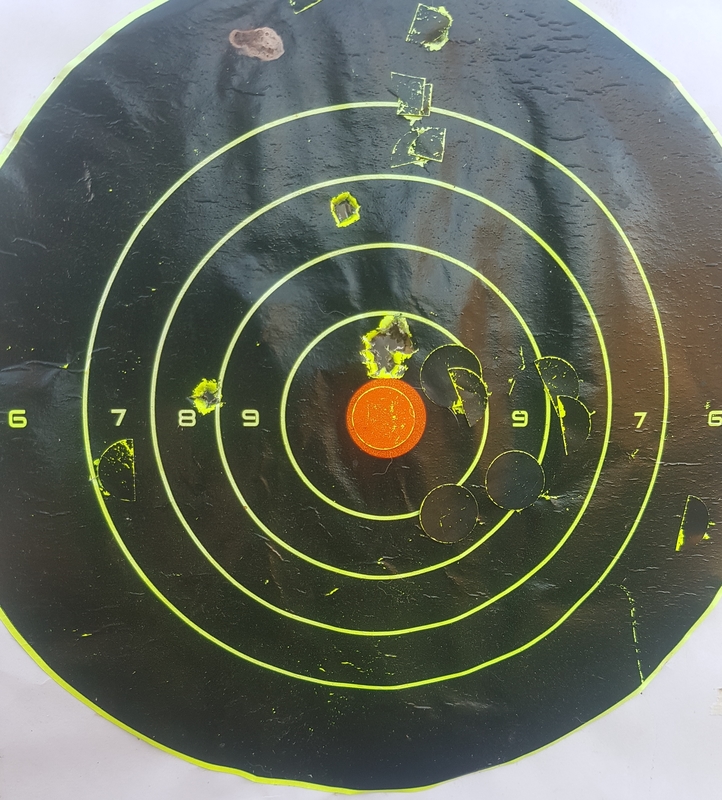

I weight batch my brass to 0.1gn as well as my projectiles.
Well worth the embuggerance and testing,
The group above the bull is 5 rounds of my OCD .223 handloads at 300m.
55g Hornady soft nose, marketed here as Roo Max, seated to the top of the cannelure in ADI brass weighing 93.3gn with 25.5gn of ADI 2206H and CCI BR-4 primer.
The 2 fliers are Australian Buffalo River factory rounds using the same ADI brass and a comparable 55gn soft nose projectiles
