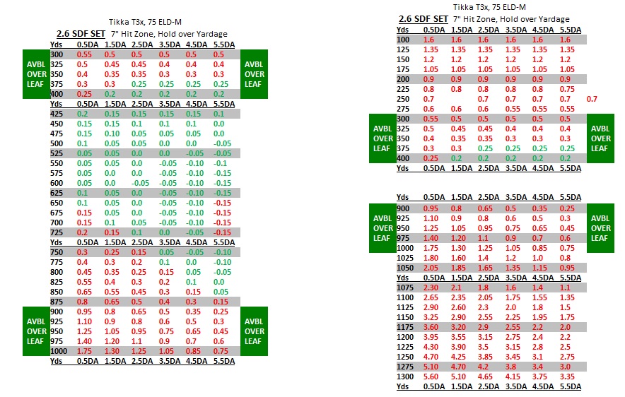

I just could not stop thinking about @jackmaster article on Speed Drop Factor and how incredibly useful and versatile it could be in real-world situations, so I sat down and drew up a few tables and then went shooting.
I first started thinking a +-mil range is all well and good for targets that scale with range, but what if your target doesn't scale with range? Deer, hogs or blue helmets don't get larger the further away they get.
Once drawing up a table for a 2,500ft Density Altitude with factors of 2.6, 2.5 and 2.4 I then added a linear displacement from waterline using the various Mil values it produced at range.
The table itself is based on a 7" vital zone diameter, or +-3.5" from waterline. As you can see, 0.25mil for example at 325 vs 600 vs 850 give vastly different linear displacement values.
It became obvious very quickly that 2.4 was way too low (and as I found, the ideal number increases with an increase in Density Altitude) and after these tables were created from 500ft to 5,500ft Density Altitudes, a SDF of 2.6 was my chosen value.
I'm still in the process of cleaning up my dope table to make it faster to navigate through, but here it is covering anywhere within a range from 100-1300yds and DA of 500-5,500ft
The RED numbers fall outside of my +-3.5" zone if yardage is dialled without applying the listed correction, the GREEN numbers fall within my zone with no correction needed, but it is listed for fine correction if needed.
The numerical values are a correction (either holding under/over or dialling a correction on the turret).
I took this info out to the range yesterday and could not believe just how fast and easy this method is to use in the field. With a spotter calling yardage for various targets all I had to do was dial to it and watch the steel swing.
