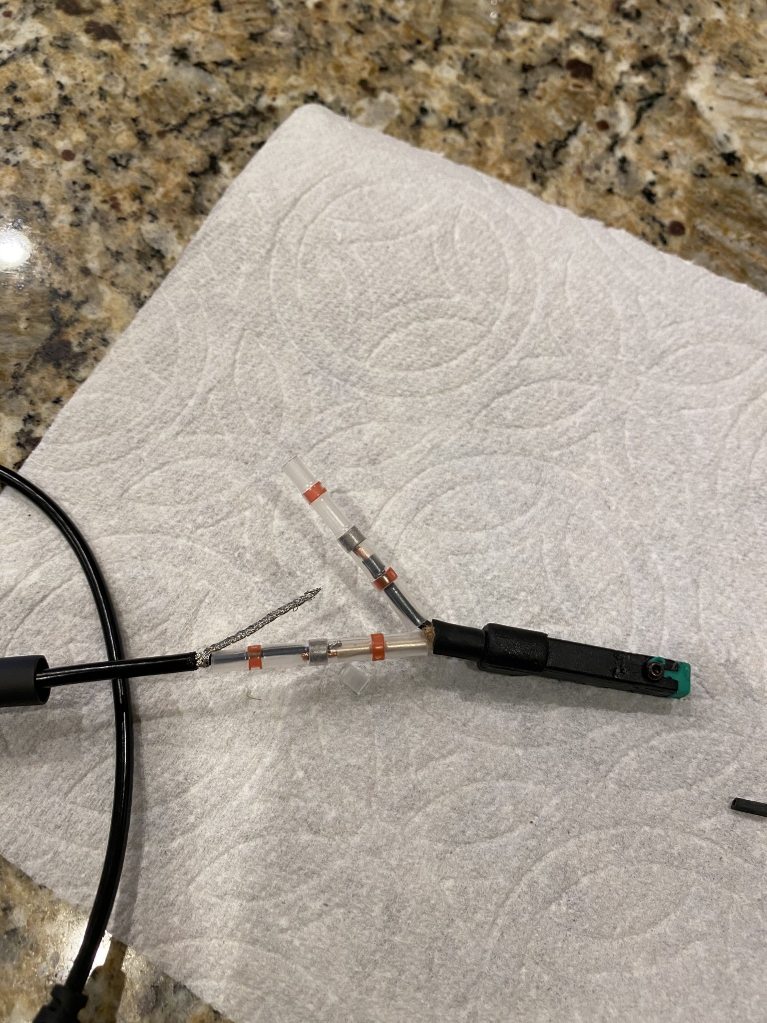

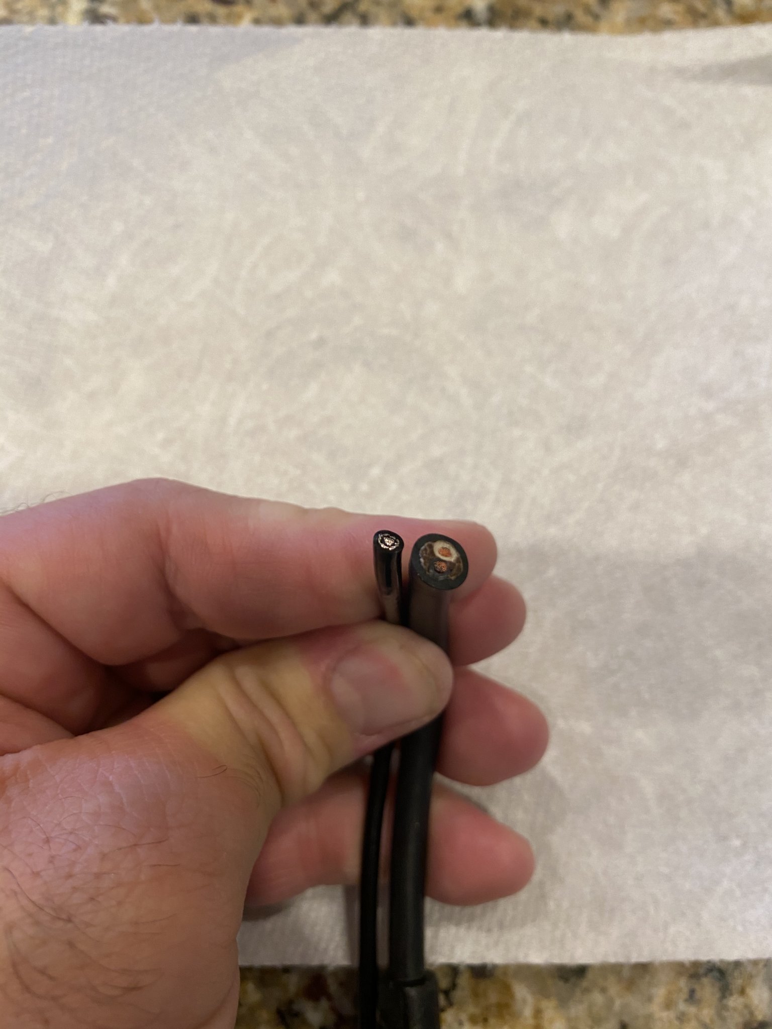

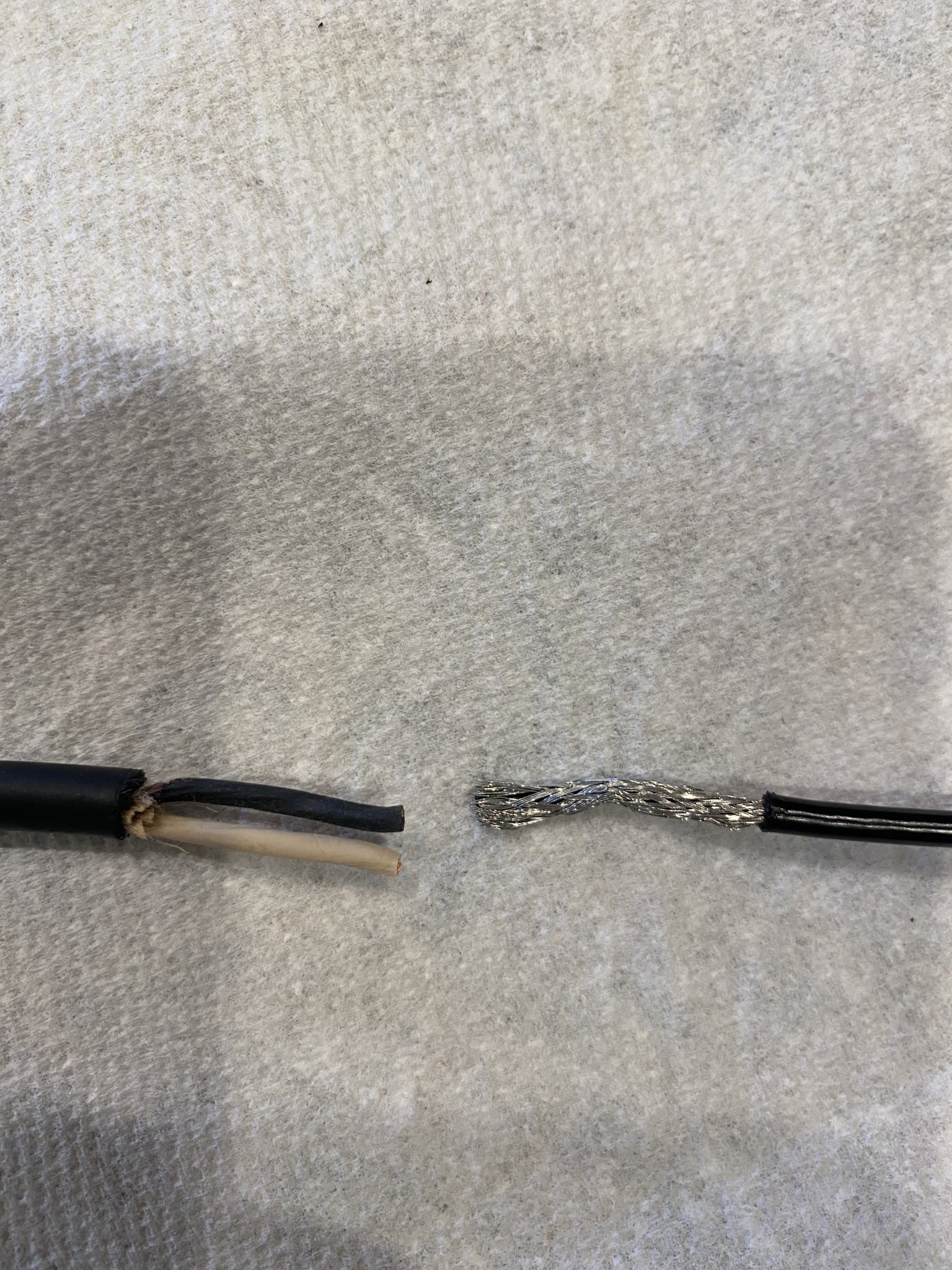

Spliced a TNVC Taps to a Meprolght MOR sight to work with a surefire 600 v aa IR light. This gives me an all AA battery setup. Didn’t have the right size shrink wrap to finish it so more pictures later. The TAPS wire is smaller in diameter because it uses a coaxial type of design with one wire wrapped around another. I un weaved the outer wire and twisted it together. For the splice I will use the heat shrink end to end solder combo connectors with shrink wrap over the top and silicone on the ends for completely waterproof wiring. This is easy and requires minimal tools. I will do my PERST 2 next. It would be awesome if they offered TAPs with connector and a kit to solder the other devices (streamlight) since it it pretty obvious they aren't bringing any additional compatibility on line anytime soon.

I wonder if you could just eliminate that third wire? Not that I plan on buying a perst laser, but I nerd out on this kinda stuff.

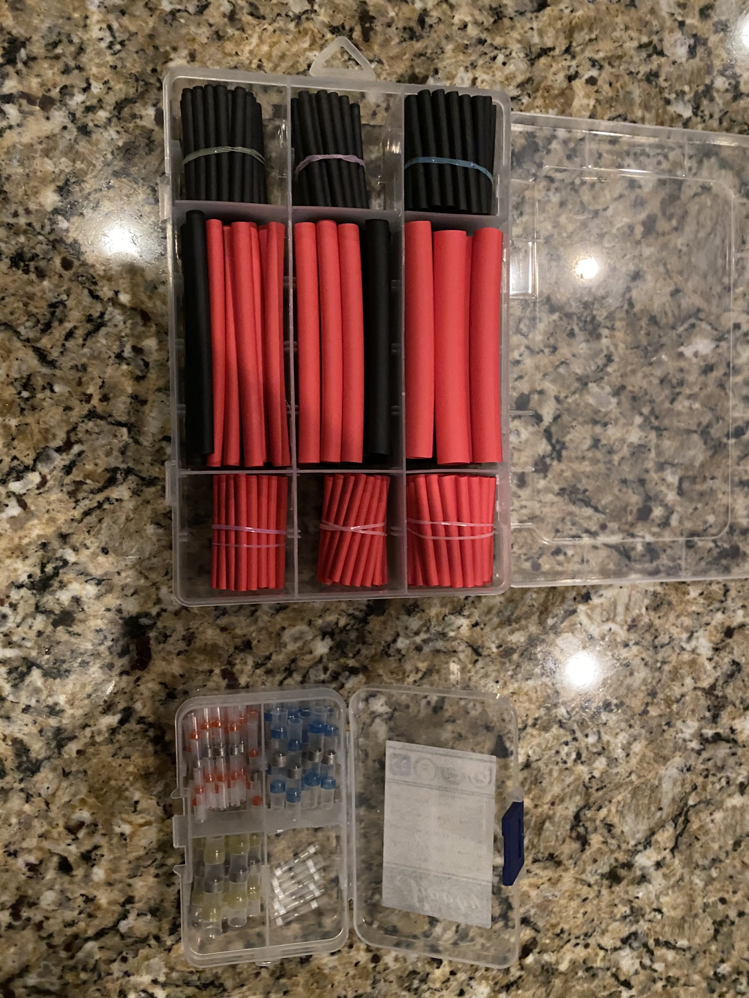

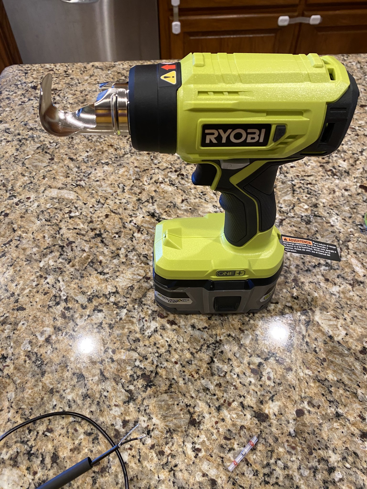

These are what got from amazon (chyyna). The connectors have solder inside the heat shrink tube. Last time I really used electrical connectors was more than a few years ago. They have come a long way.
I believe the guy who did some surgery on his cables on ARFCOM ended up having to run two wires into a single lead as the third wire is a signal to the Perst indicating the rotation of the rheostat on the switch.

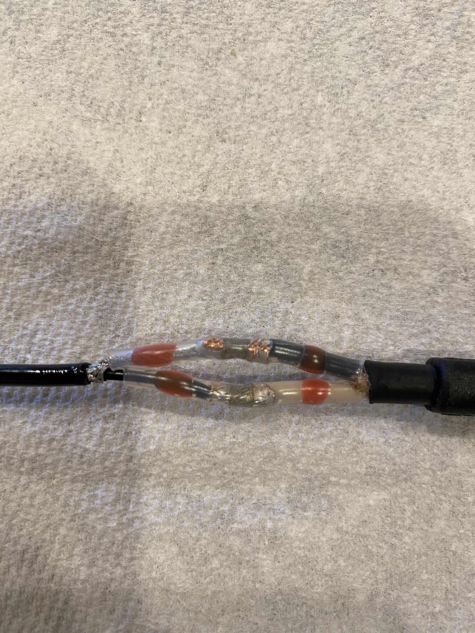

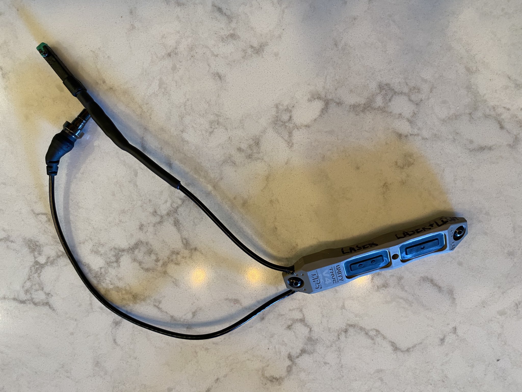

Finished. The all in one solder adhesive connectors are pretty slick but i think for this application physical crimping with solder would be better to prevent the connectors from pulling apart when tugged. Feels pretty solid though. Will send pics on the rifle. Bought a ryobi heat gun for this. Worked well.
Question about the connectors. Did you solder them with a soldering iron first, or is the solder low temperature enough to work off the heat gun?

the solder melts under the connectors and the red stuff is adhesive. Pretty slick
