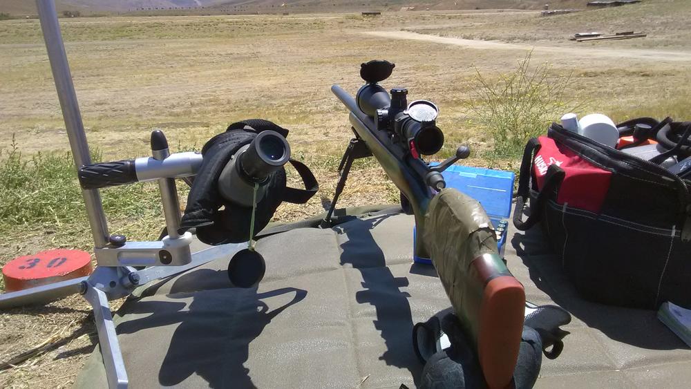

Dunno....Kowa doesn't make reticle eyepieces and frankly...even though I'm not a competitor at 72 y.o....I like having a reticle to measure with out there. Just saying...
