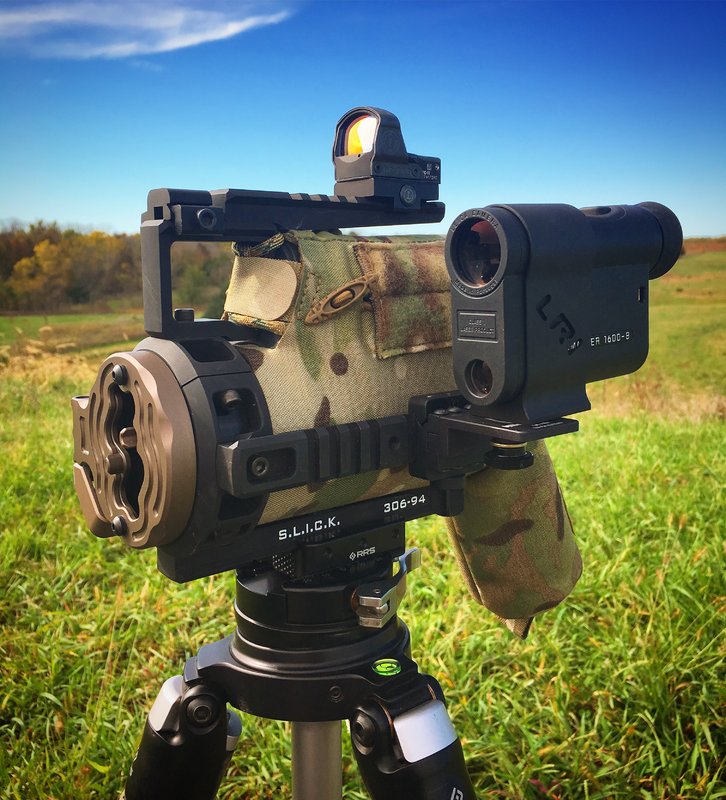

Shop around you can find good deals on them I got mine New with the Badger SLICK kit and leupold delta point red dot for $1400.

What's the attachment that you used to attach your lrf to the SLICK?
