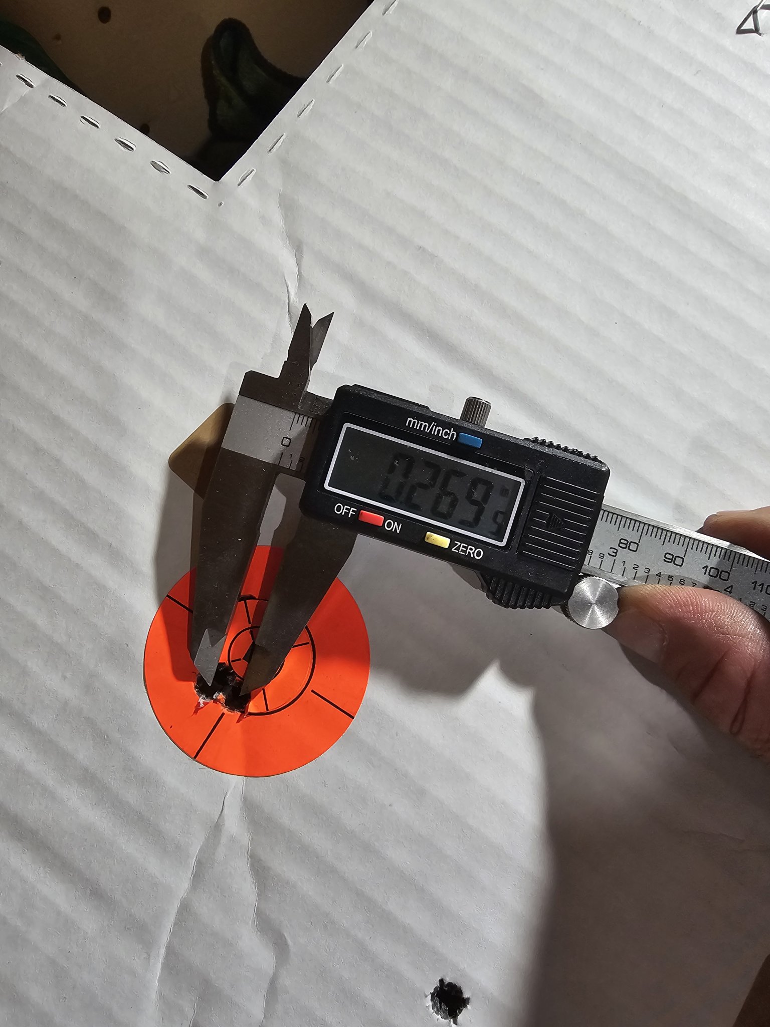

New member, but long time SH follower. So here is the run down. I got a brand new springfield Armory waypoint 7PRC with the BSF Carbon Barrel, mounted in a brand new ADM mount, with a brand new NF NXB 4-32 with tremor 3 reticle. Mounted and torqued everything as should be, took it out and got it sighted in and zeroed in 12 rounds, with my final zero group measuring .269inch. I then took it to 902yards and shot about a 5inch 3 round group.
At about round count 25/30, my accuracy started to go out the window. I'm now avarageing anywhere from a 2 inch to 5 inch group. This is all with factory Horandy 180grain ELD-Match ammo. I have contacted both Spring Armory and Nightforce, they have both been super helpful, easy to deal with, and will be sending both the scope and rifle back to their respective manufacturers.
With all that being said, has anyone see this thing happen before and/or what does the group think could be happening?

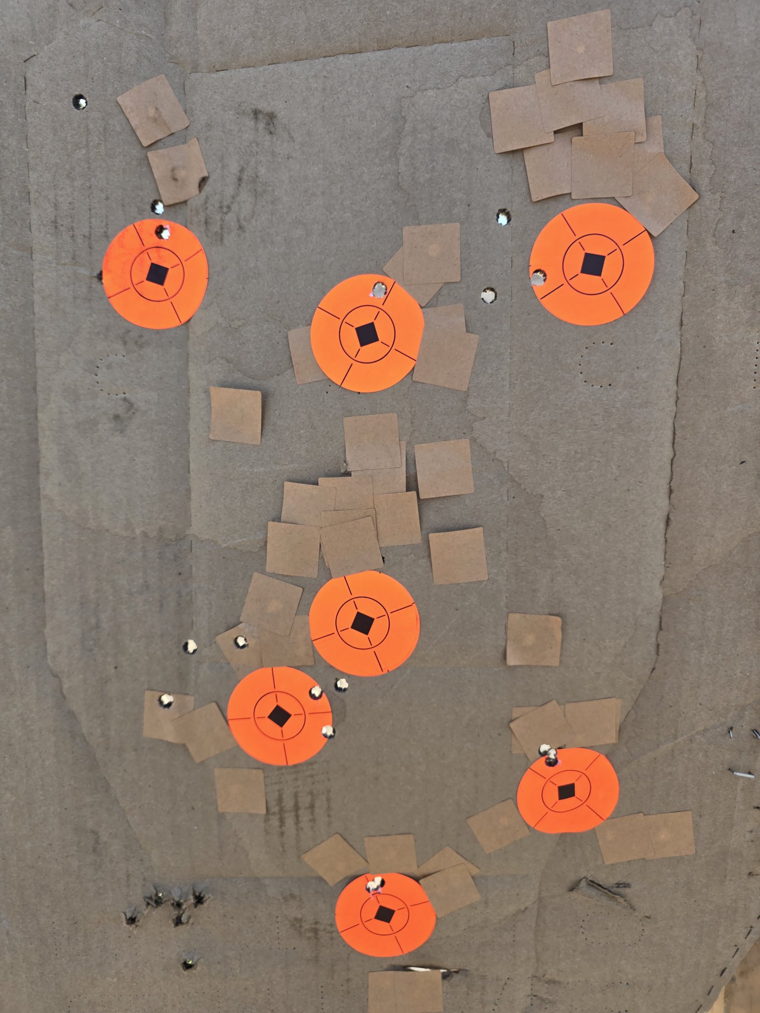

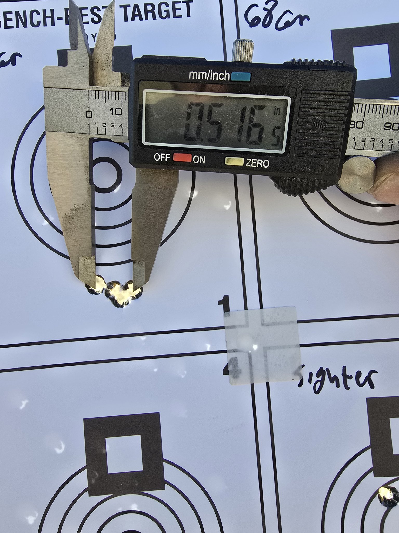

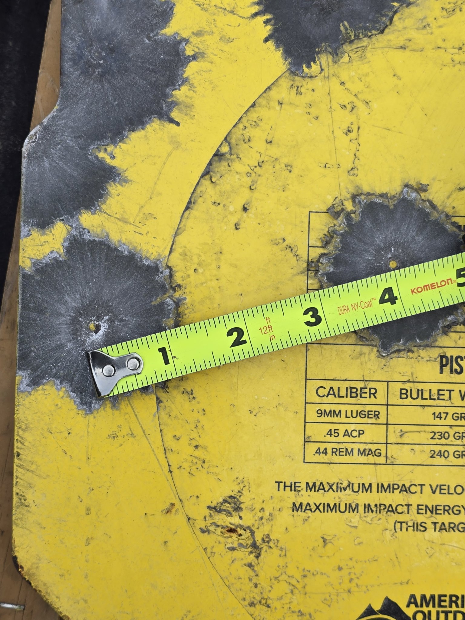

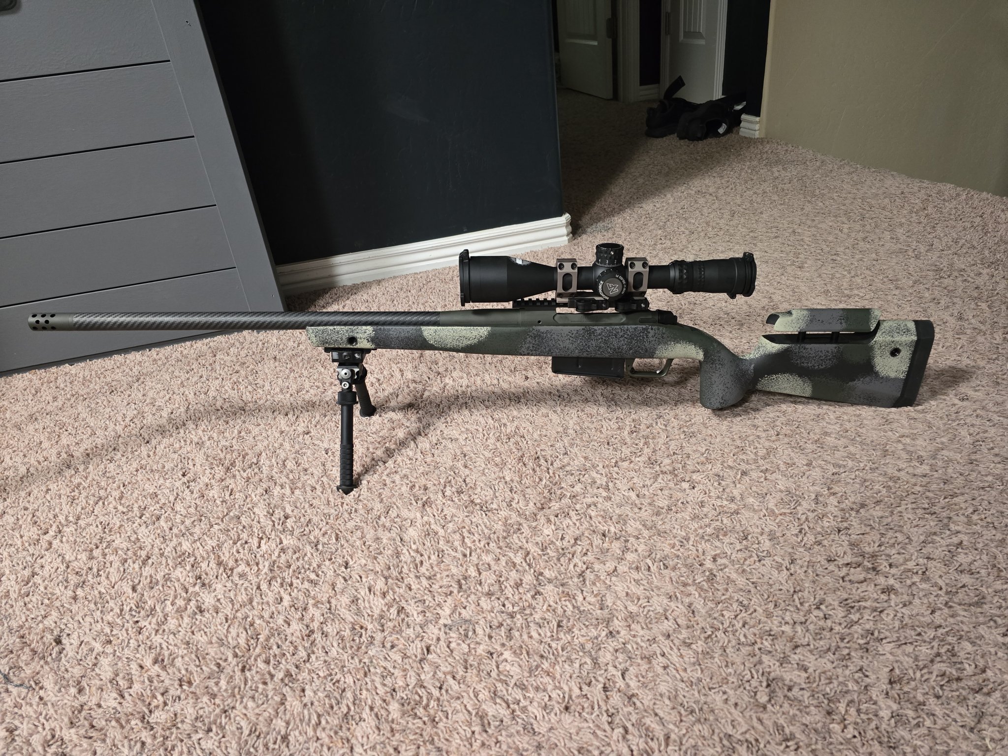

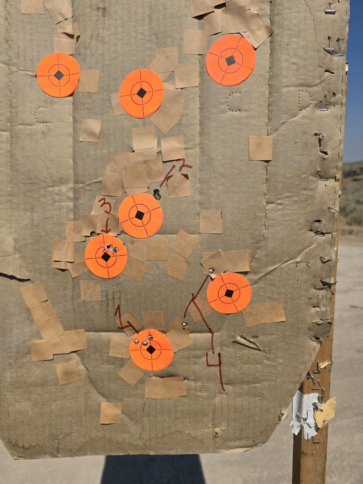

First picture is initial zero, 2nd. 3rd, 4thpick is rounds on steel at 902 yards, 5th
picture is current grouping, and final picture is rifle.

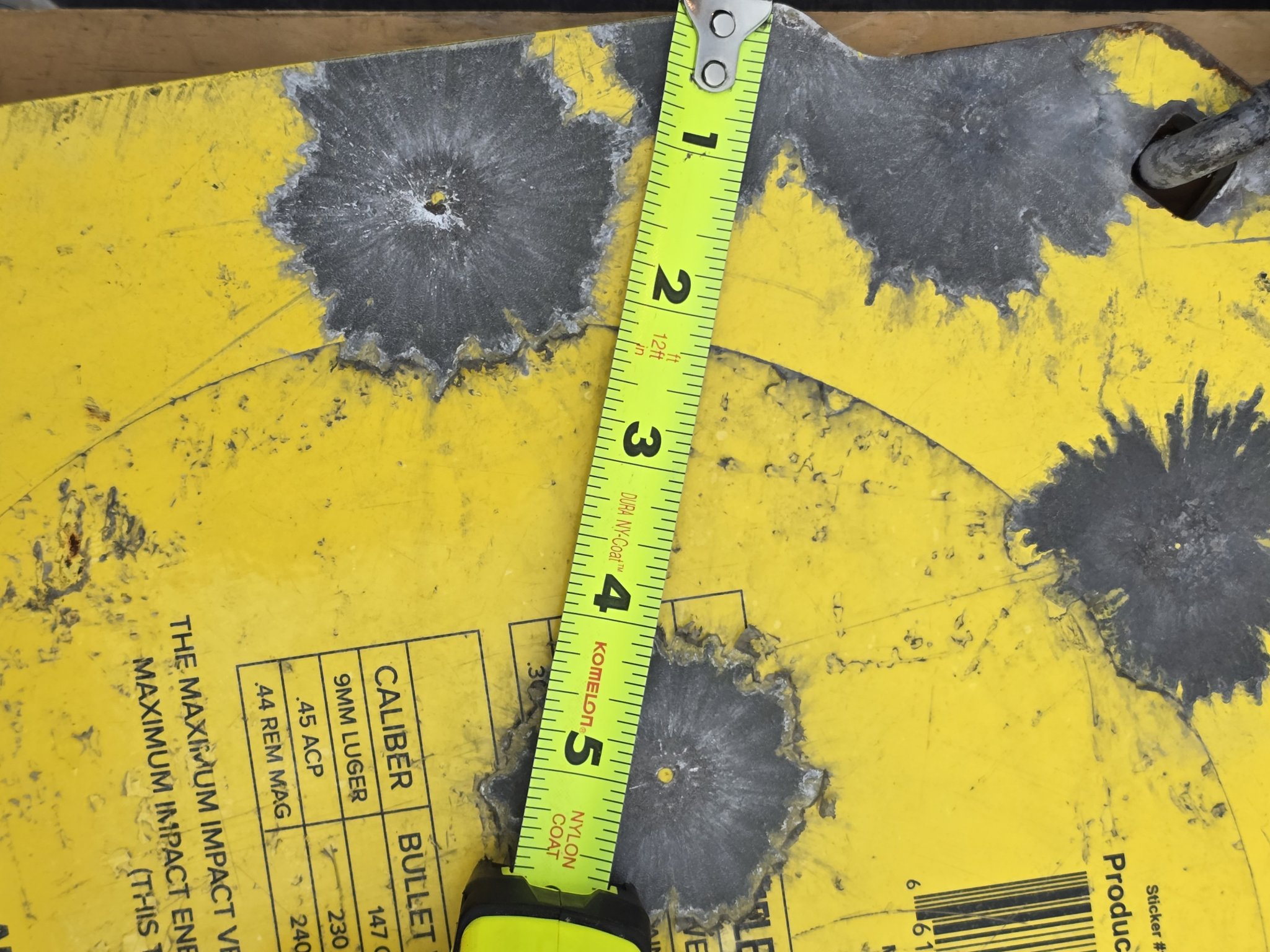

So I think I have narrowed it down to the scope. I took everything off, remounted and torqued everything took it out and shot it just now. I have labeled the groups in order of shots. After the first group I went down .1mil and right .1mil, then shot the 2nd group into one hole (but it went high and right). I then went down .2mil and left .1mil and shot the 3rd group, I then went down .1mil and shot the bottom hole of group 4, I then went up .2mil and shot the top hole of group 4. So it seems the scope will hold zero, but the adjustments are not accurate. Why or how this happened I don't know. As group 2 shows the gun will still shoot a tight group, so I think there is an issue with the scope. Thoughts or ideas?

Hey yea got both rifle and scope back about 3 weeks ago. Springfield said there was not issues with the rifle, Nightforce said the tracking was fine but there was a issue with the parallax (nothing that would cause an issue like I was having). Went ahead and got a set of nightforce ultra duty 6 screw rings, mounted everything back up and zeroed it.

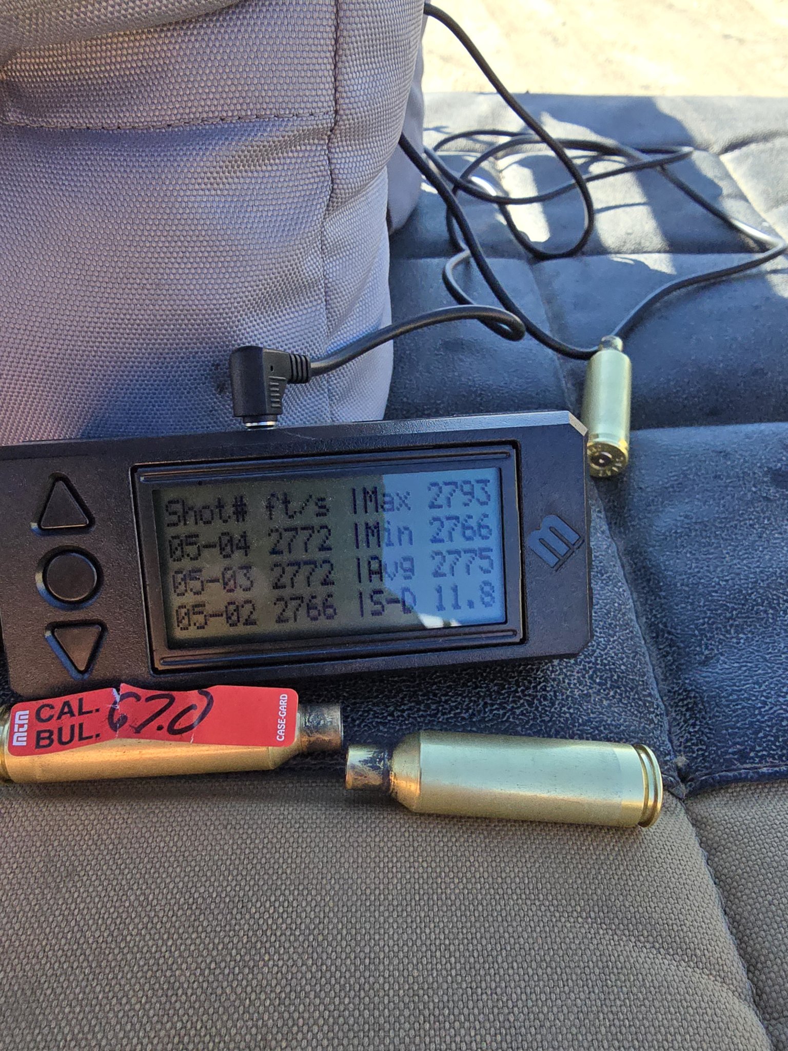

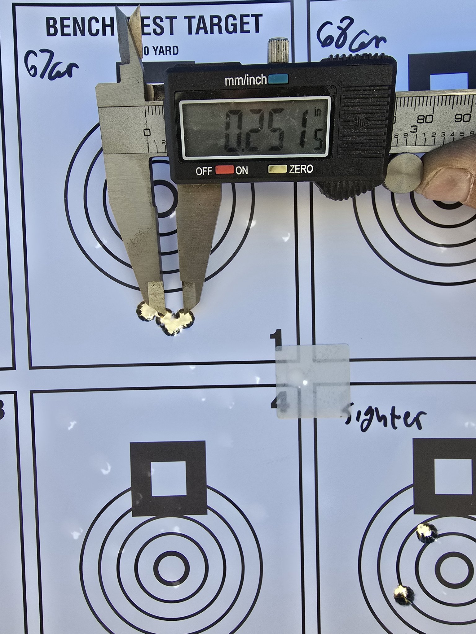

The gun will shoot sub half MOA 5 shot groups, however it's cold bore shot is significantly off and not predictable and when it warms up, it will shoot all over the place. I don't think BSF has the carbon barrel down like proof, but it's also a hunting gun and not made for rapid and successive shots.
There is also a very significant shift in group size and location after cleaning the barrel of carbon only. As long as I stay around 10 rounds of fire and let it cool it will hold sub moa. Here is a 5 shot group (it only registered 4 shots) of a load I worked up with 180 eld-m, 67 grains of Staball HD, and FGMM magnum primers. I wanted more velocity, but it's also only a 24inch barrel so I'm not to upset.

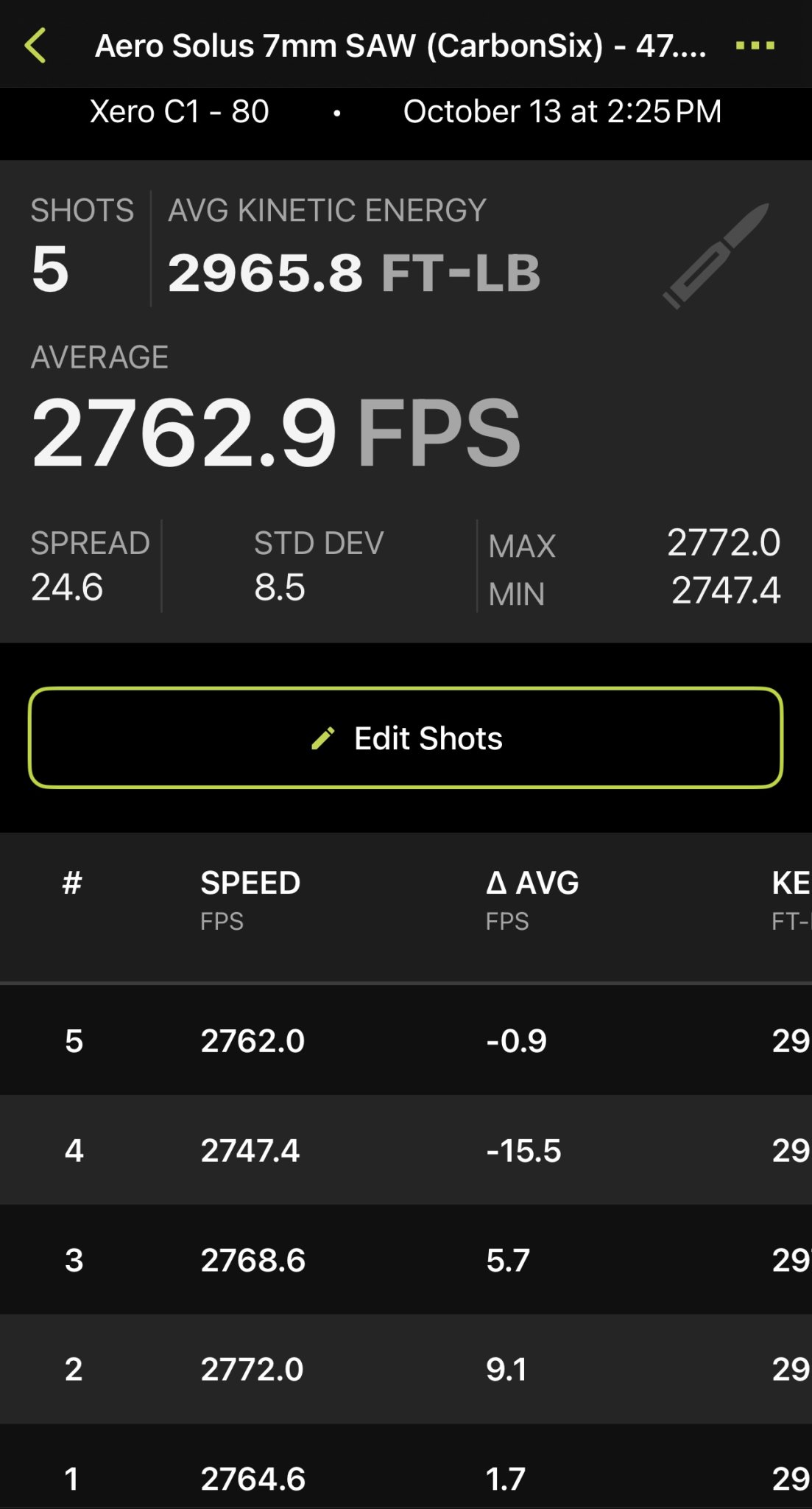

Damn... That's super slow... I think you can get more out of it than that by swapping to a faster powder. I guess StaBall HD is a tad on the slow side for the PRC/7mmRM/.300WM sized cases. I'd try some IMR 7828 SSC or H1000, if you can get your hands on some. Some other good ones to try would be Alliant Reloder 25 or 26, and Vihtavuori N565 or N170.
That 2,775 is really slow from a 7 PRC. I'm getting only 12 FPS less from a 7mm SAW with a 20" barrel using 47.5 grains of StaBall 6.5 and Berger 175 Elite Hunters... With an ES of 24.6 and SD of 8.5...
