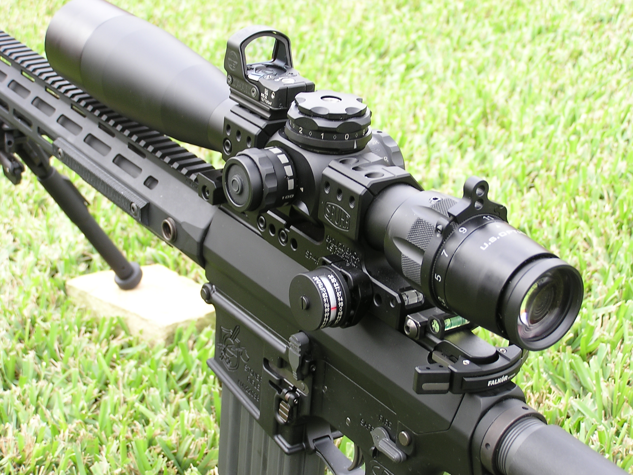

I found on my application that I also could not see the level in the Spuhr mount so I add a Knights Armament Anti-Cant Device. I don't know if you have the room but there are other options out there. I also have a bubble in the scope but sometimes it is difficult to see.
