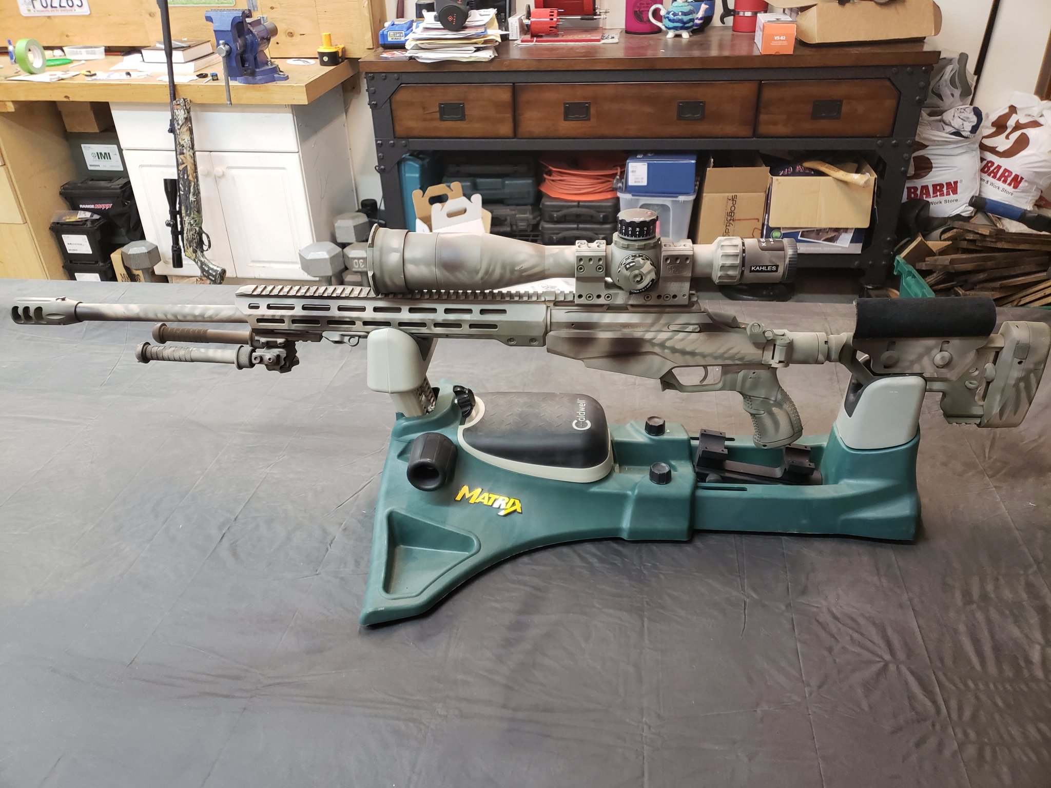

That's a good solid setup you've got going. The Spuhr mount you want is a Sp-4602. It is a 20 moa mount. Your Tikka has a zero moa rail. You will have plenty of room on the scope to adjust to zero at 100 yards. The height of the mount is just enough to clear scope caps. The cheek rest on your stock will line you up very nicely behind the scope. See picture for the exact setup you are considering except that is a K525i on the rifle.
