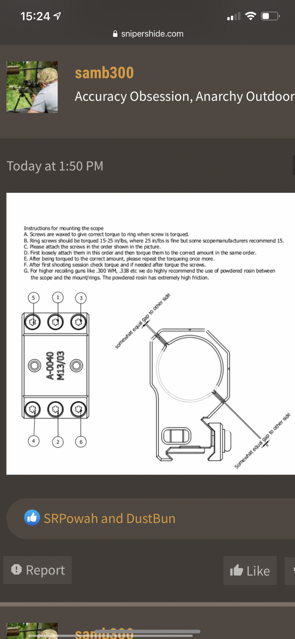

Here’s the torque pattern. It’s weird you didn’t get a piece of paper that sits on top of the foam when you open the box. Has all the info minus the torque order.
But here’s the torque specs and the order in which to torque the screws on the cap. The pic rail screws are numbered, start at 1 and go on through 4.

I have a Spuhr ST-3701 and a Vortex AMG
Spuhr ST-3701 Base Screws - Spuhr recommends 45 in-lb So that’s what I torqued to
Ring Screws - Spuhr recommends 15-25 in-lb but Vortex recommends no more than 18 in-lb which is what I torqued to

And obviously you had no issues right, I think our scopes are pretty much the same so ill try it, I wanted some feedback before I torqued it up. Thanks alot!
None whatsoever, I have had two different AMG scopes (different reticles) in that mount using those torque figures with no issues. Note that I did not/do not use Loctite on any of those screws.
