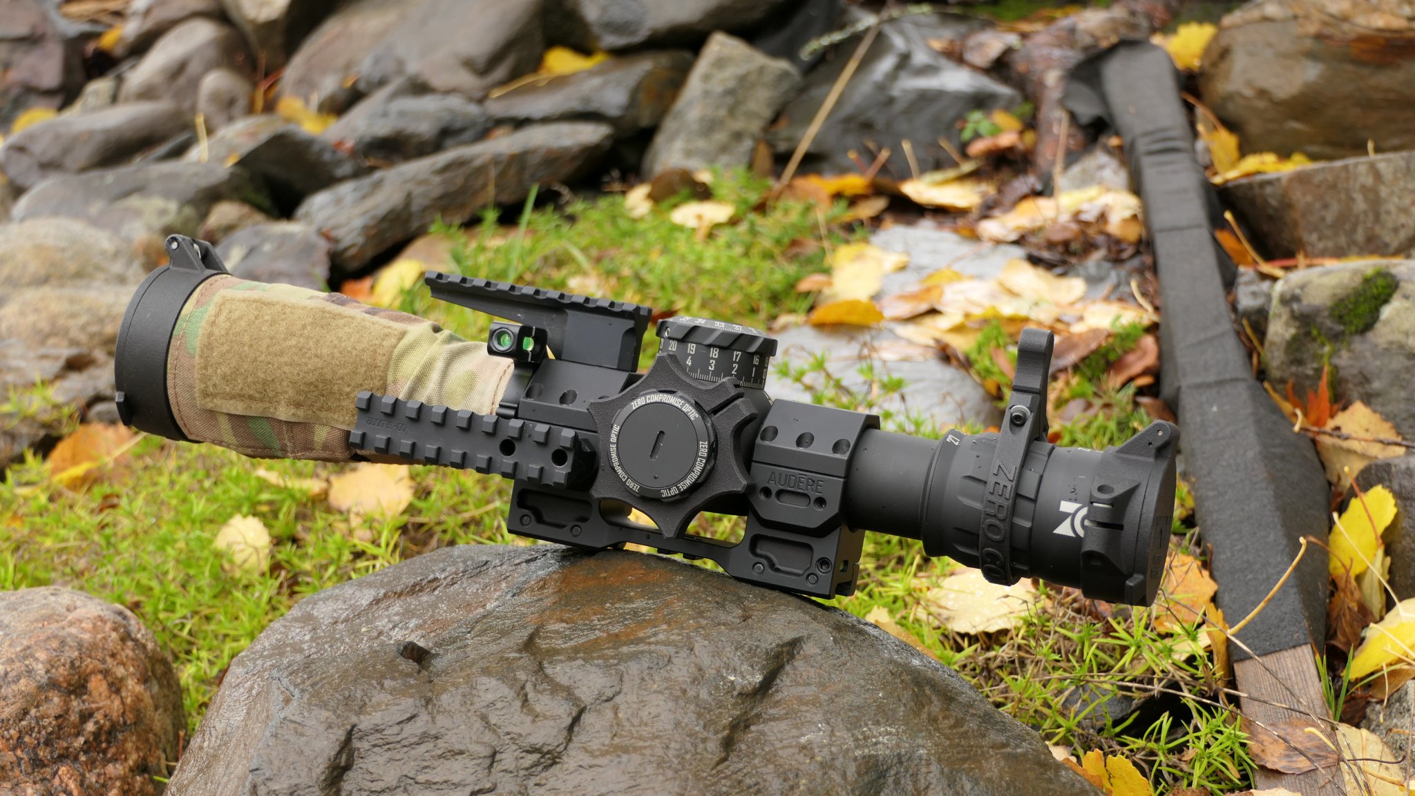

Here is my ZCO 527 sitting on a Adversus mount.
MKMachining does import these to US.
