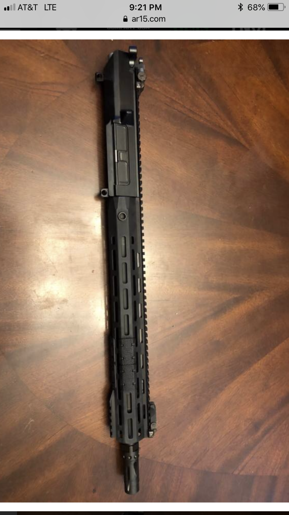

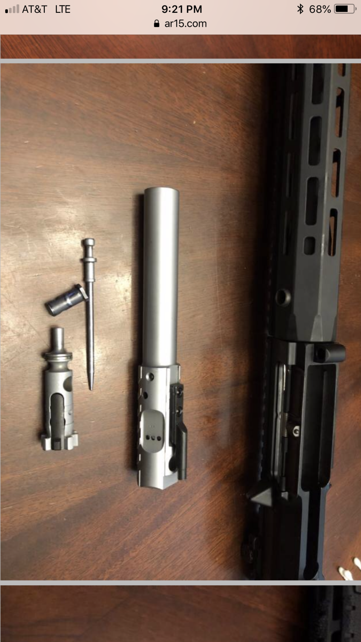

    So I broke down and bought a KAC SR-25 complete upper , PC, with the intention of getting the complete lower as well.
    I sold an Aero 308 that I pieced together recently and sent funds today. Supposedly has 20 rounds through it and in as new condition.
    I’ve read I can run it on my Mega Maten until I find the KAC lower. I’ve also found an LMT MARS-H lower today and read those fit as well.....I’ve been looking today and haven’t had much luck finding a complete KAC lower for sale. Anyone know of a source?

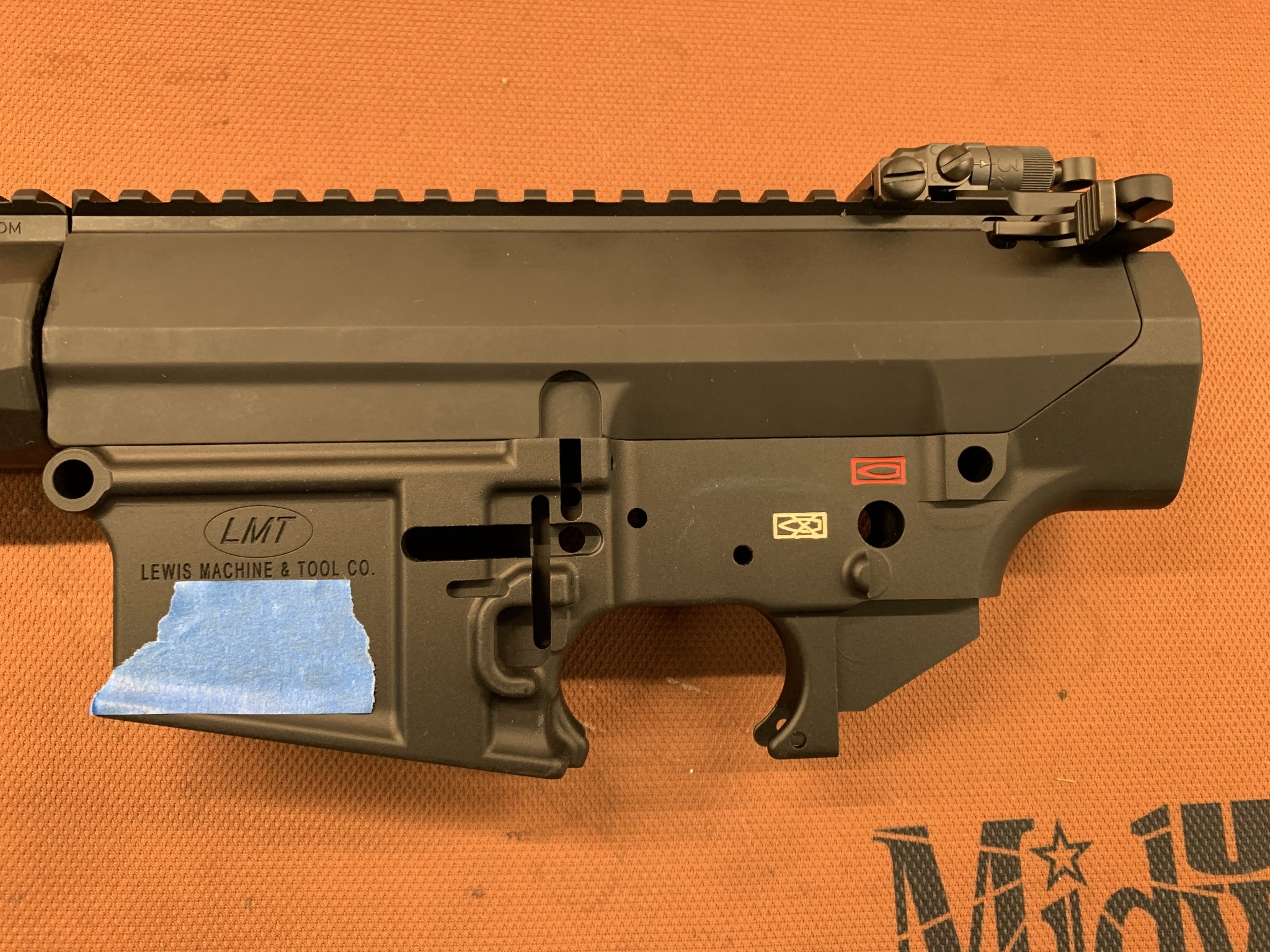

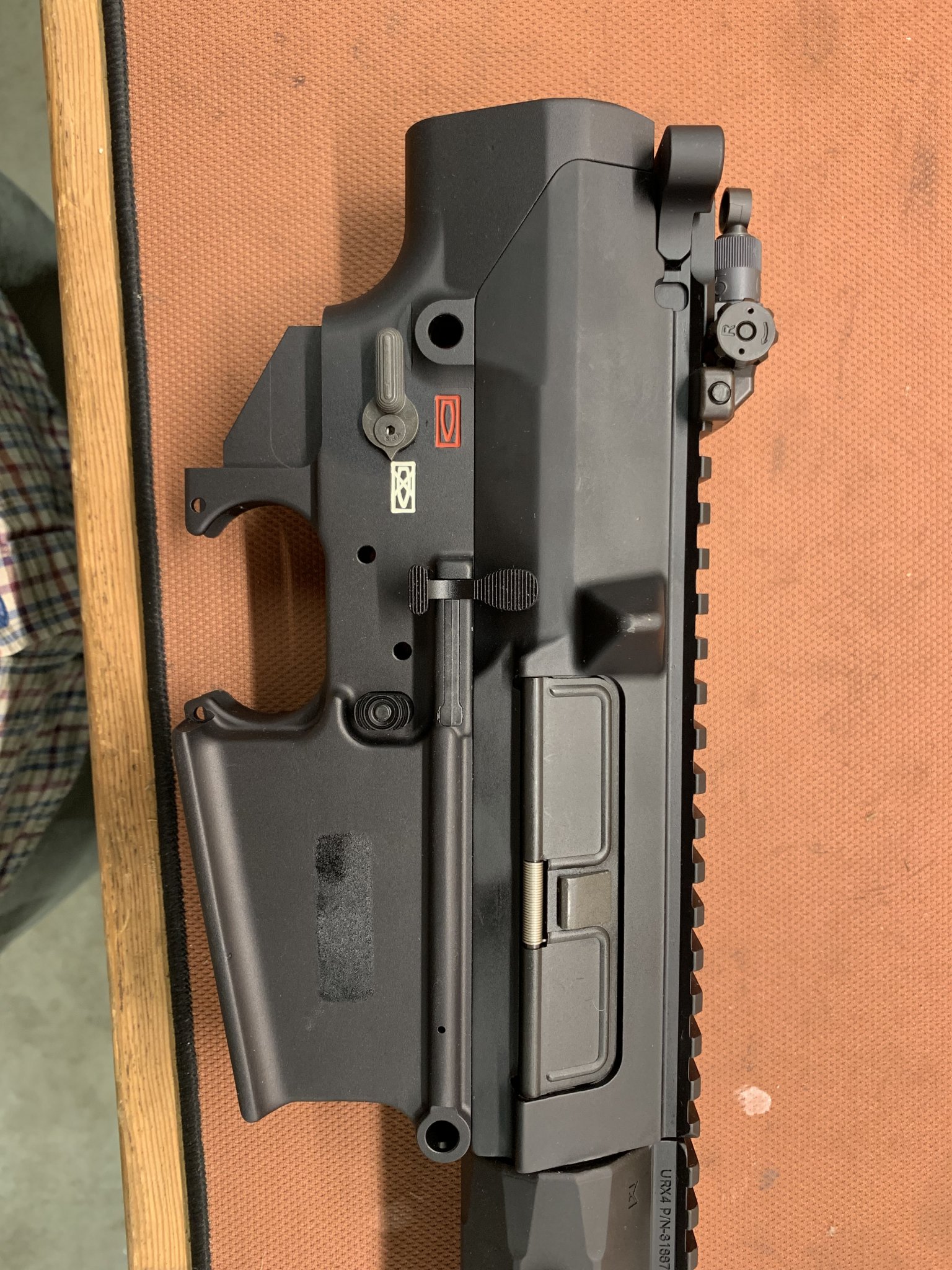

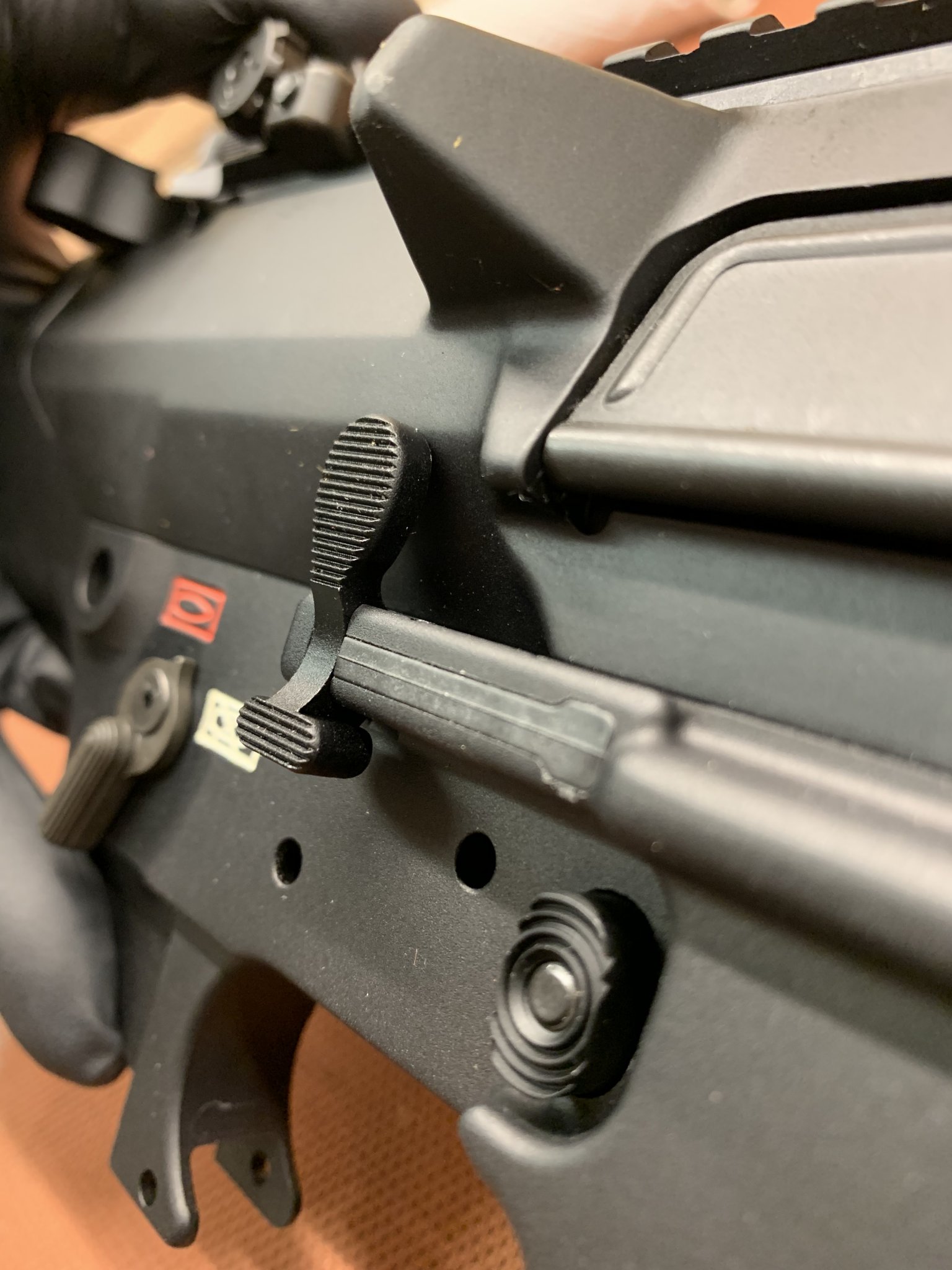

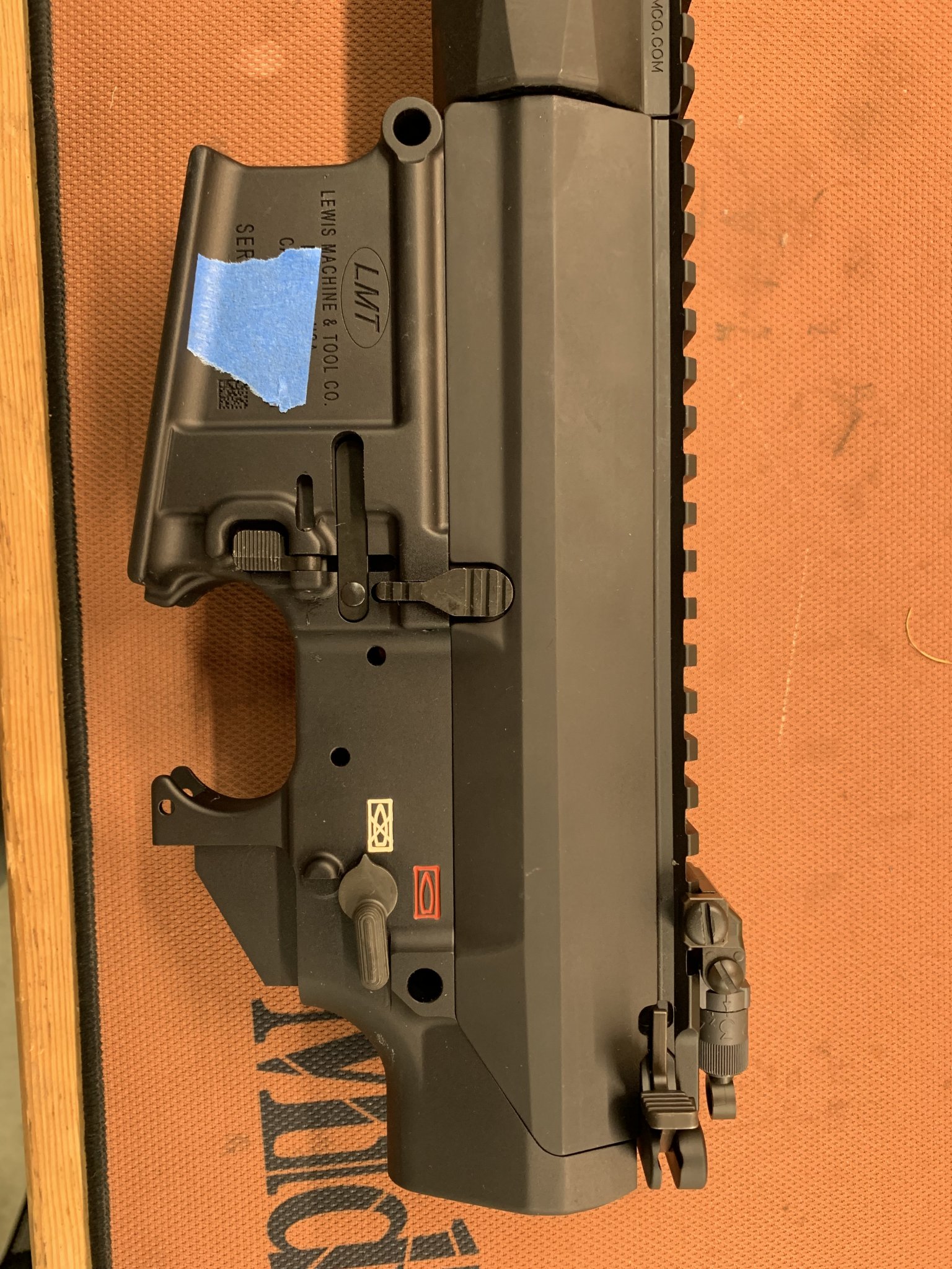

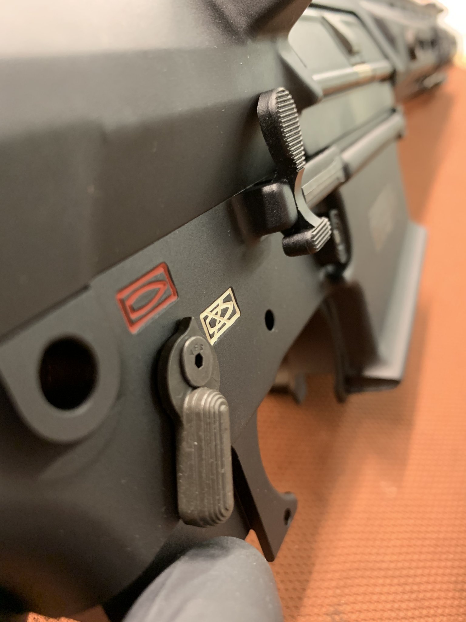

    Ok, here is the knights upper with LMT MARS-H lower. Note - this is a stripped lower that I have not finished yet.

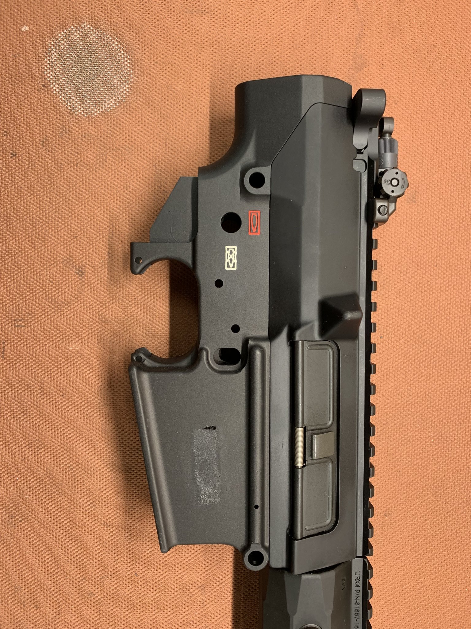

    Here is the knights upper with LMT MWS lower. Again, stripped lower but you get the idea.

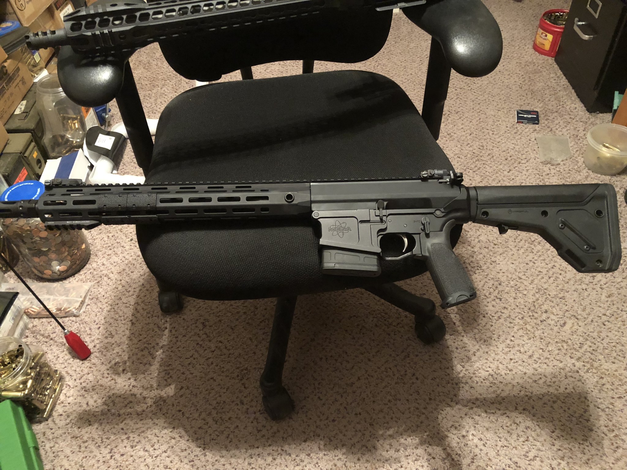

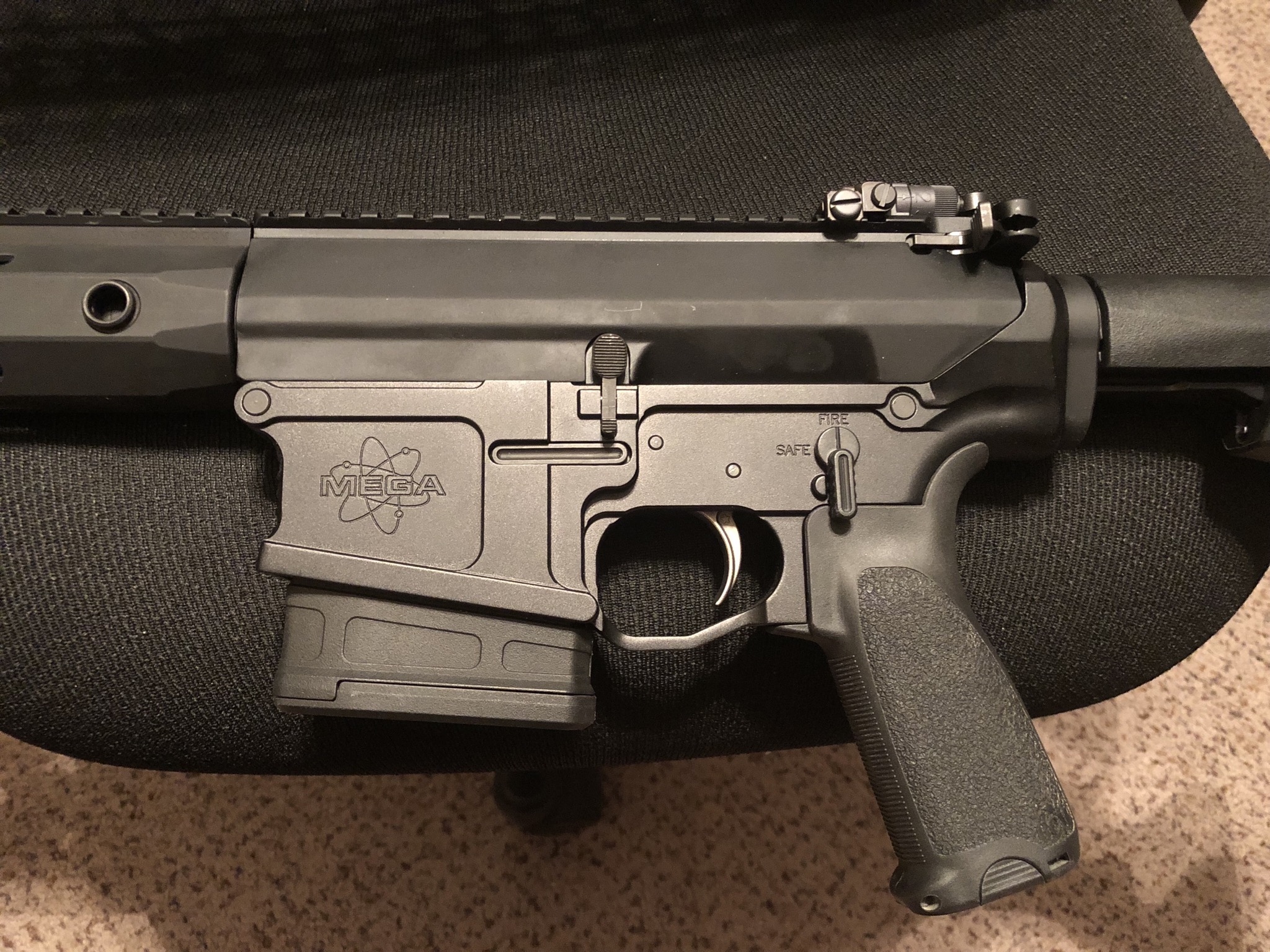

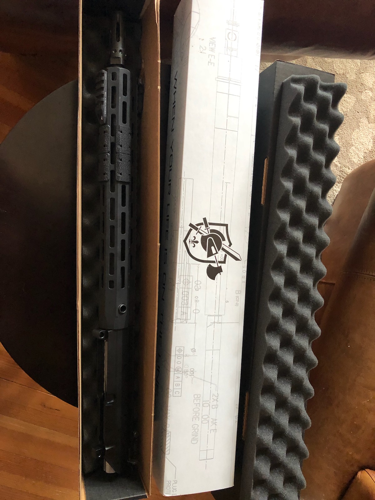

    Well, it arrived. I installed it on one of my Mega Maten lowers and quickly learned SR-25 bolt carrier will not allow the use of a BCM trigger. The fit between the upper and lower is very tight and I had to tap the take down pin in the last 1/4” or so. Looks a little funky but I ordered the MARS-H lower today. I ordered the stripped lower but it comes with all the controls already installed. I also ordered the push pins and an enhanced trigger guard.
    I’m adding an SSA-E and already have the rest of the parts on hand to assemble the lower. EXCITED, to say the least!
