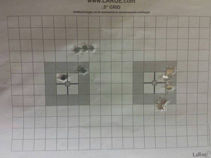

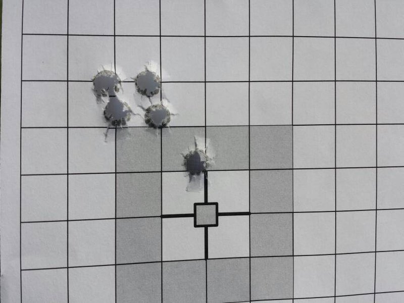

I have a 2012 20" SR25, I did a lot of testing, and found that it worked the best with Lapua brass and 175 SMKs. It didn't like Hornady 178s or Winchester brass. It probably could have, if I had played with longer seating depths. It is surprisingly easy on the brass, and shoots great. My loads could still be dialed in better, but any bad shots are all my fault and not the rifle. Maybe I got a good one, but this rifle shoots and it isn't going anywhere.

What did it shoot with factory ammo? I had people tell me the same with the REPR. On anything factory it was a 1 MOA gun at best, but with a few months of work and finding a solid hand load, I could get some good 1/2-3/4 groups mixed in with some that had a flyer here and there. I was just hoping to get a gun that starts Sub MOA so I can work it from there... uphill battle with an "average" rifle. Most of the 6.5 guns I see seem to be lasers, I just hate to order something with a 6+ month wait time because who knows what I want or will be into before it ships.
I was trying to find a load with Hornady 178s and Winchester brass for a long range course. I was never able to get anything I was happy with, so when the class arrived I used some HSM M118LR factory ammo they had available. I shot about 200 of those during the course with excellent results at all distances. I got home and instantly ditched the 178s and the winchester brass.
I also had really good results with some FGMM 175s that I had done a little bit of testing with.
These are 200 yard groups with my reloads. The rifle shoots better than I do.
My best groups on the REPR was with 43.2 gr of Varget with Federal brass and 2.800 OAL, Federal primers. The same load was only average in my HK and Scar, still shot MOA, but it was great in the REPR. It would do 3 round groups fantastic, 5 round groups good most of the time, for fun I did a 20 round group and had a few flyers... could have been my fault, maybe not.

Edit - had a few of my chrono sessions saved, this was 43.3g Varget, 178 amax, Federal primer, FC brass, 2.800 COAL. Altitude was true, not DA.
Created: 11/09/16 08:47
Description: Repr 20 inch
Notes 1: 43.3 gr varget 178 amax
Notes 2:
Distance to Chrono(FT): 5.00
Ballistic Coefficient: 0.595
Bullet Weight(gr): 178.00
Temp: 80 °F
BP: N/A inHg
Altitude: 2400.00
# FPS
10 2529
9 2523
8 2531
7 2545
6 2547
5 2546
4 2533
3 2532
2 2532
1 2523
Average: 2534.1 FPS
SD: 8.9 FPS
Min: 2523 FPS
Max: 2547 FPS
Spread: 24 FPS
Shot/sec: 0.1
True MV: 2536 FPS
Thanks for the info. Isn't the 178 amax a g1 bc of .495?
I don't remember, I pulled it off Hornadys site, but its no longer on there as the 178 ELD is up now... I checked my ballistics app and it does show .495 on there, so may have just fat fingered it in my cell phone when I was entering data. Its pretty irrelevant for chrono purposes anyway since I don't use that software for anything except FPS and recording data.
I will have to see if I have my targets around from when I was testing loads, there were two sweet spots using the 178 amax with one being 42.X grains, and the other being 43.2 that I ended up keeping for the velocity if youre using Varget. I went all the way to 44.0 grains, but anything above 43.5 wasn't picking up any velocity and started having some decent extractor marks on the brass. Other than flat primers, there weren't any pressure signs at 43.2 and SD was around 5-9 on the groups. I haven't tried the 185s, and I would have to dig up the 168 stuff. 155s I ran with 47 gr but never had time to chrono them as I only had 150 bullets and just loaded them because I had them. 175 and 178 load data is pretty close, but as always, start low and work up. I tried some CFE223 as well when I couldn't find varget for a while and it had some great velocity, I just couldn't find a solid number that would group as well as the varget, and it had pressure signs pretty quick.
Notes 2:
Temp: 80 °F
BP: N/A inHg
Altitude: 2400.00
# FPS
10 2529
9 2523
8 2531
7 2545
6 2547
5 2546
4 2533
3 2532
2 2532
1 2523
Average: 2534.1 FPS
SD: 8.9 FPS
Min: 2523 FPS
Max: 2547 FPS
Spread: 24 FPS
Shot/sec: 0.1
True MV: 2536 FPS
Thank you.
GAP and KAC have the exact same guarantee. Less than 1MOA; could be .99MOA and still pass though.
Differences are these: GAP will use a standard receiver set, KAC uses their proprietary receiver set --full ambi, all built into it. Both use cut rifle barrels. GAP uses a standard gas block while KAC uses a new proprietary gas block that slides over the barrel and has a locknut that threads onto the barrel itself in front of the gas block. The GAP uses it's own rail system or one they prefer. KAC comes with either keymod or m-lok, your choice, or you can always buy a rail and change it out but it'll be heavy. The new KAC rifles dropped some weight with the new tubes (one piece designs, are awesome) and they only use SOPMOD stocks now. This bothered me at first, but I only use SOPMOD stocks on my carbines anyway, figured I'd give it a shot before I bought the KAC fixed stock... Turns out I LIKE the SOPMOD on a 20" 7.62 rifle! Comes with tons of shit, I put a USO scope on it for the time being and an Atlas bipod and PEQ and called it a day. Oh, I bought more mags, got 10 or so and the can to fit it, but still waiting on the can. The KAC comes with a 2stage trigger I figured I'd have to change (the GAP comes with a Geissele) but turns out the KAC 2stage trigger ain't nothing to snot at, so I decided to leave it all stock. It's the only rifle I have that is 100% stock, but if I have to buy more AR's I'll be using KAC now that I know their triggers are good and all their new rifles have the new full ambi lowers with SOPMOD stocks. Nothing to change.
KAC makes good shit that is both accurate and reliable. They have always been my go-to for parts and most of my stuff uses their tubes or sights or rails. GAP makes a good rifle, one like I'd probably make actually, but with a different rail, backup sights, etc. That'd all be KAC.
Only other possible choices would be the new FN rifles (but I only know they look cool, may have a 1MOA guarantee) they are modified, accurized SCAR17's. The other one I considered was the HK 7.62, but since you can't get the G28 configuration, why bother spending more for it? It's also shorter (I wanted 20") and costs more than KAC or GAP to get basically what I didn't really want. For a gas piston operated 7.62 AR, the HK is really the go-to maker IMO. KAC is the go-to for DI rifles, hell, they invented it.
95% of your accuracy from any AR platform will have to do with the barrel, period. A fine cut rifle is what I prefer, but I don't snot at Lijla button rifle barrels either. With KAC or GAP, you'll be getting a cut rifle barrel. I think FN and HK use chrome lined hammer forged --stronger and they can be damn accurate, just not generally known to be as accurate as the cut rifle SS barrels.
KAC makes one 16" model, the lightest one, with a thinner barrel profile and it has chrome lined cut rifling. Which is damn rare and best of both worlds I guess.
For prices and CS, it was hard to beat KAC. Now I know some of you are laughing at that last line, but I actually know a guy there that I deal with as well as a few other contacts at KAC, and I get spot on CS. As a disabled vet, I get discounts and they even opened a military account for me. They've traded in TRASHED parts for NIB ones, shit run over by tanks and my fault. Never let me down, in or out of service. They do take their time putting orders together, but hey, rather 'em do it right than hurry it up and fuck it up. Besides, what's another week, you been waiting this long?
If I have to take something untested into a fight or I need to depend on it, then KAC is also my go-to. I expect their shit to work right out of the box with nothing more than a loaded mag and a spray of CLP on the BCG, and it can generally hold off on the CLP for a while. Their new receivers were the big game changer and what puts them in front for me now, 5.56 or 7.62.
