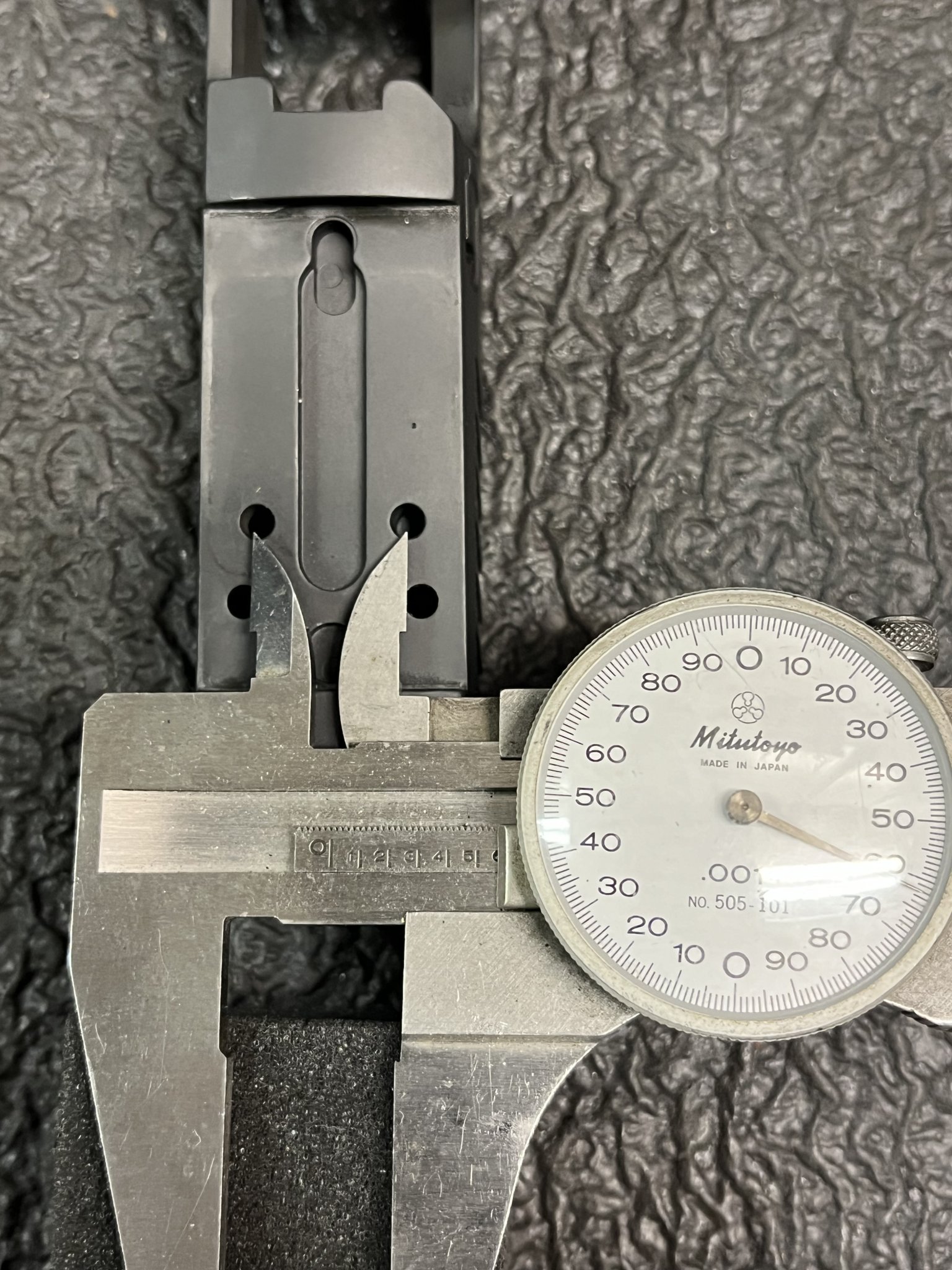

    Have looked at older threads regarding correct mount or sealing plates for an SRO on 320 X5, but as most of those threads date back to 2021, what is current recommendation for solid mounting solution for this application? Figure better tech has come along in 3 years, and my eyes have sent me a clear signal it’s time to go dot. Here’s pic of slide top-threaded holes are about .562 on center. Appreciate the assembled wisdom.

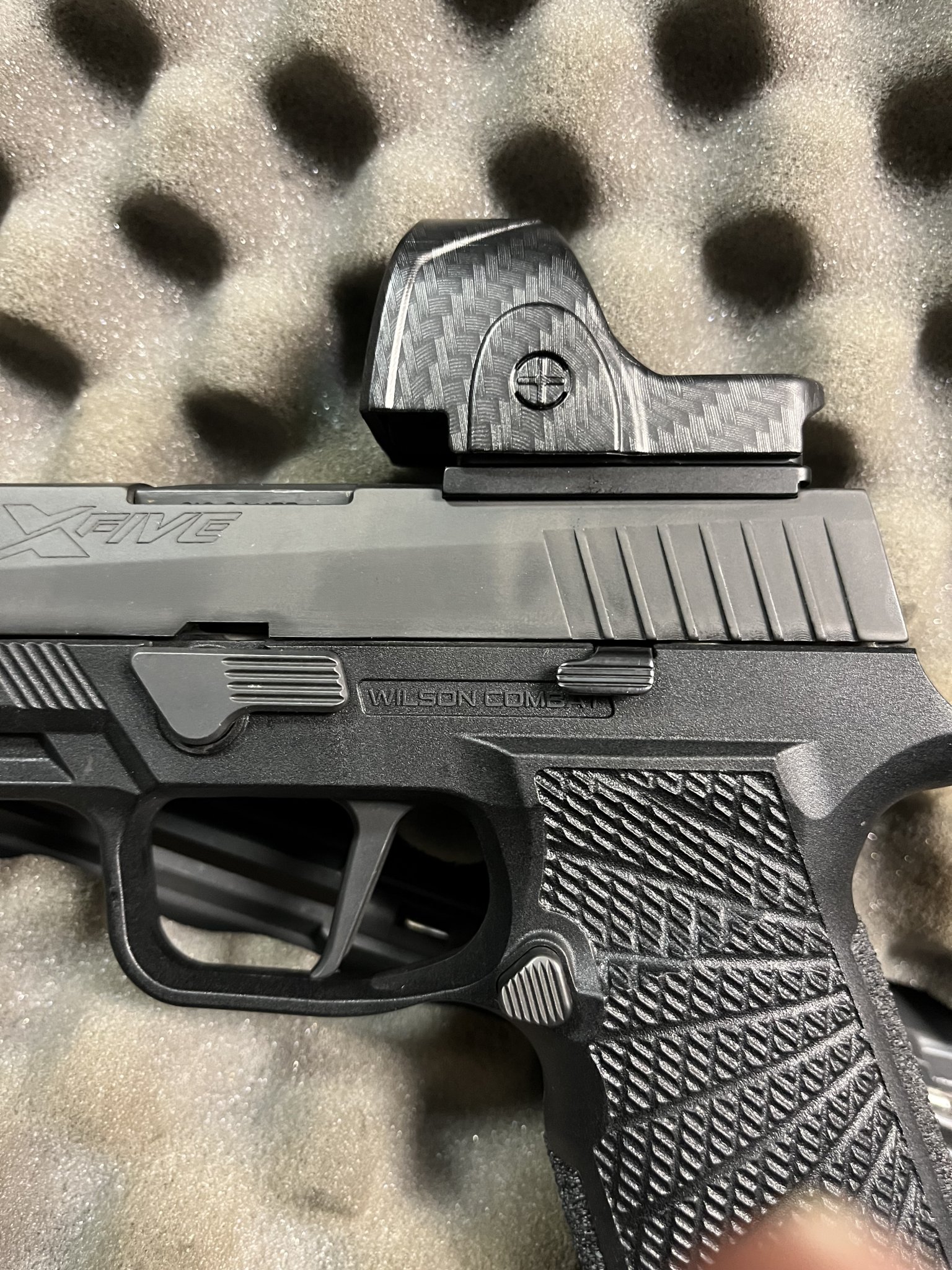

    Appreciate the comments. Athena shows a plate for Legend and a straight 320, though what they show would not work on the older X5 I have in hand. I’ll see how this holds up in match and regular use and keep these links for reference. Thanks.
