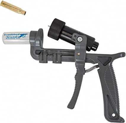

    I like this little handheld tool and it's cheap. Don't have to stand at the reloading press either. It's also pretty quick.
