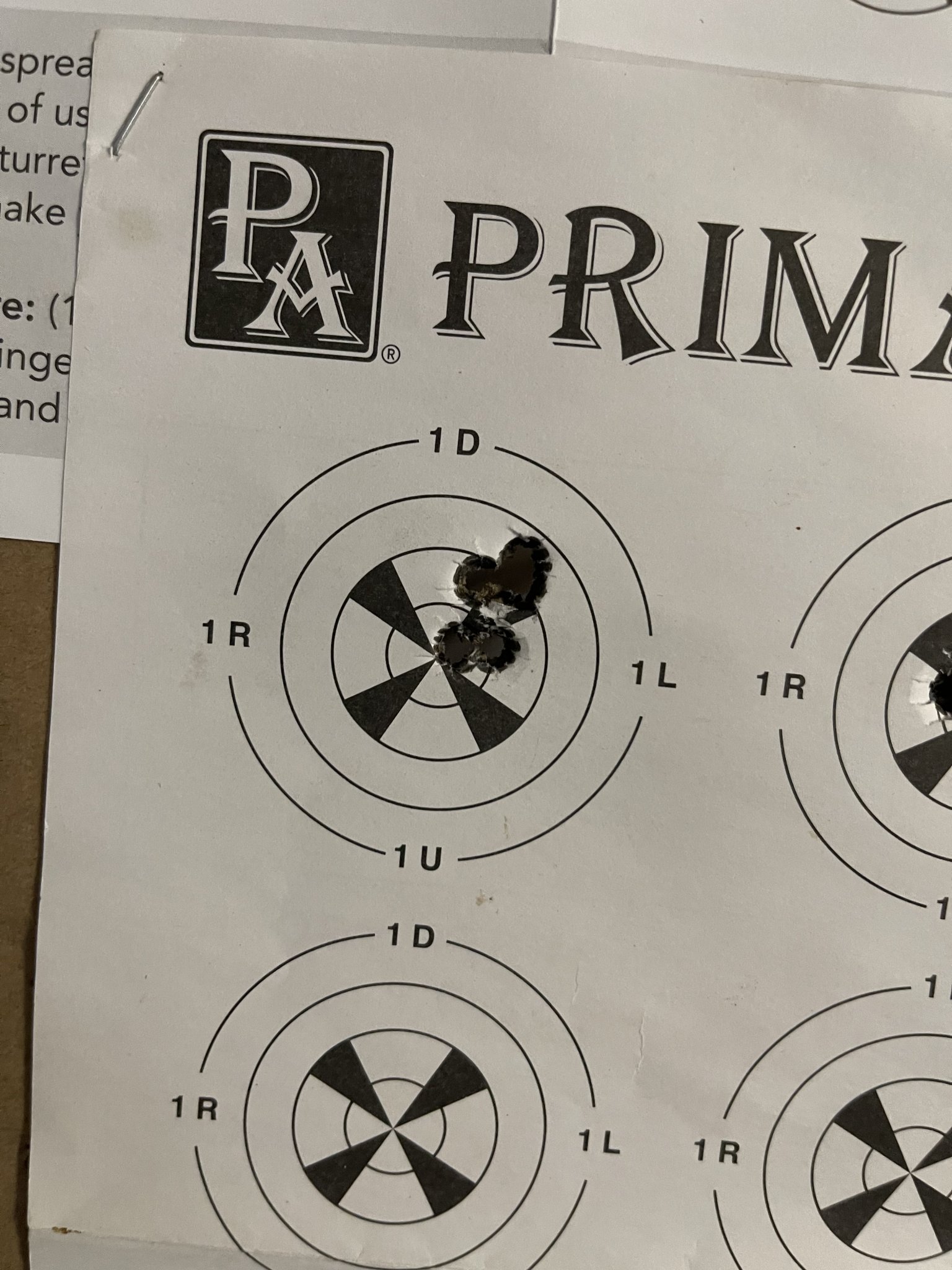

    I wasn’t having much luck in my tikka with staball and 147eld. Had 44.3 gr shoot about 1” with good ES and SD loaded at 2.800, decided to mess with seating depth, and loaded up 5 rounds at .005” increments… well, 2.805 ended up shooting .49” at 2738 fps with a SD of 3.7 and ES of 9.
    Shooting off a bipod and rear bag.
    Crazy what a difference something so small as .005” can make. I’m wondering if the mirage off my nomad caused me to pull the bottom 2 shots slightly low… we will see next time I shoot without the MagnetoSpeed.
