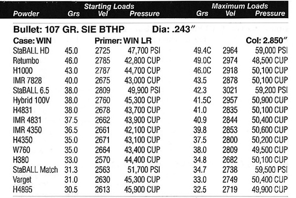

There’s an article about it in the new Hodgeden 2023 manual.

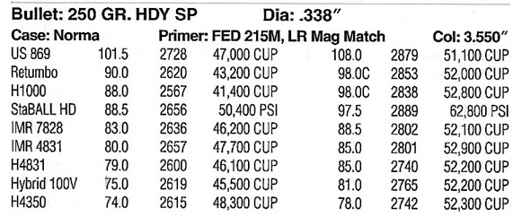

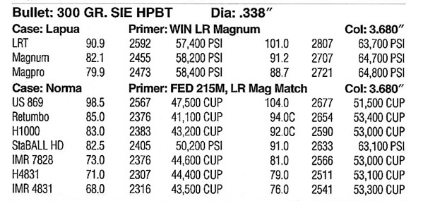

Apparently it’s temp stable for 6.5 PRC, 7mm PRC, 300 PRC, and others. Similar burn rate to Retumbo.
