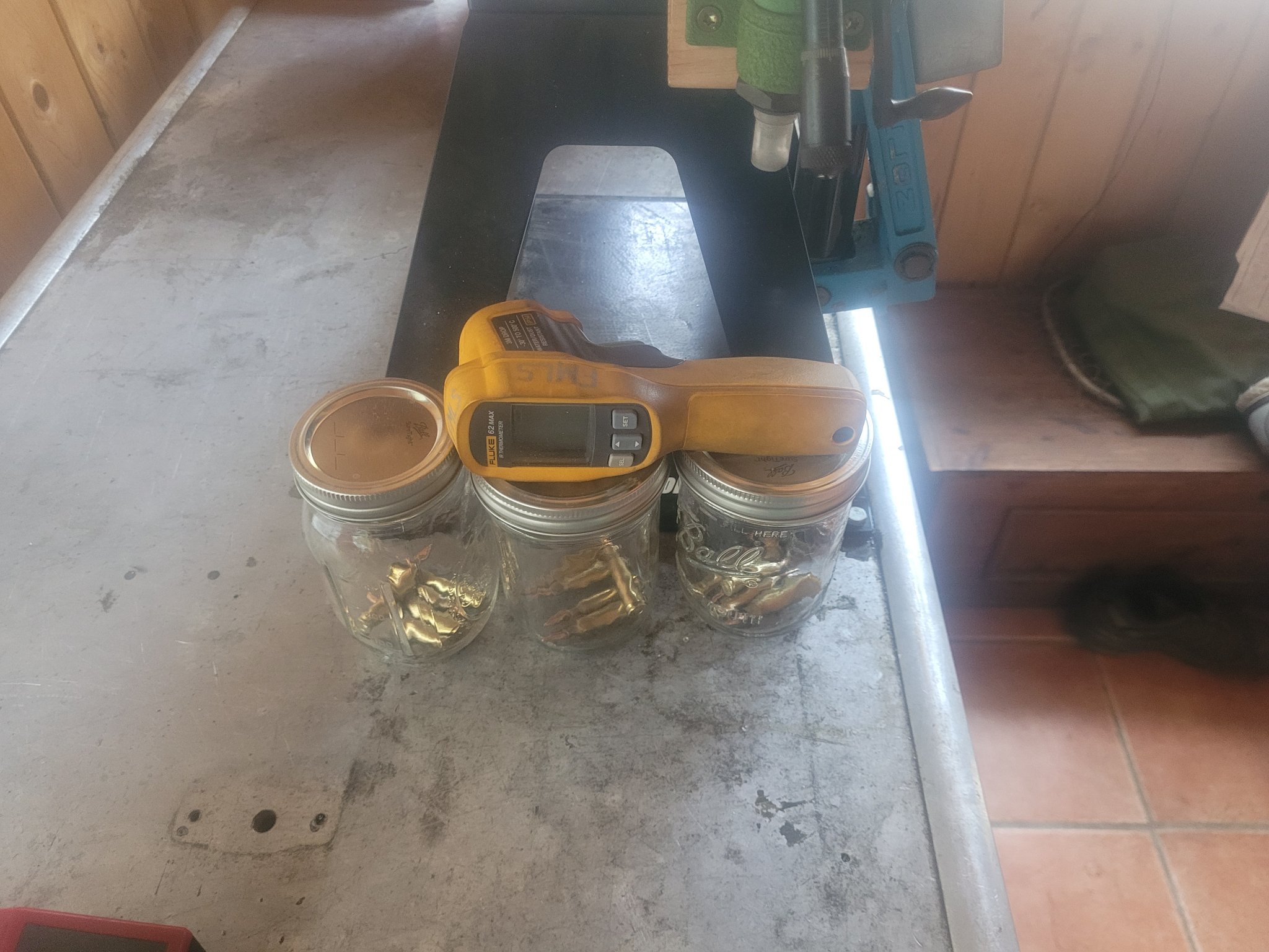

Update.
Reloaded a batch of stuff today. Same as before.
Temp testing begins tomorrow.
5 rounds in each jar. Laser temp scanner.

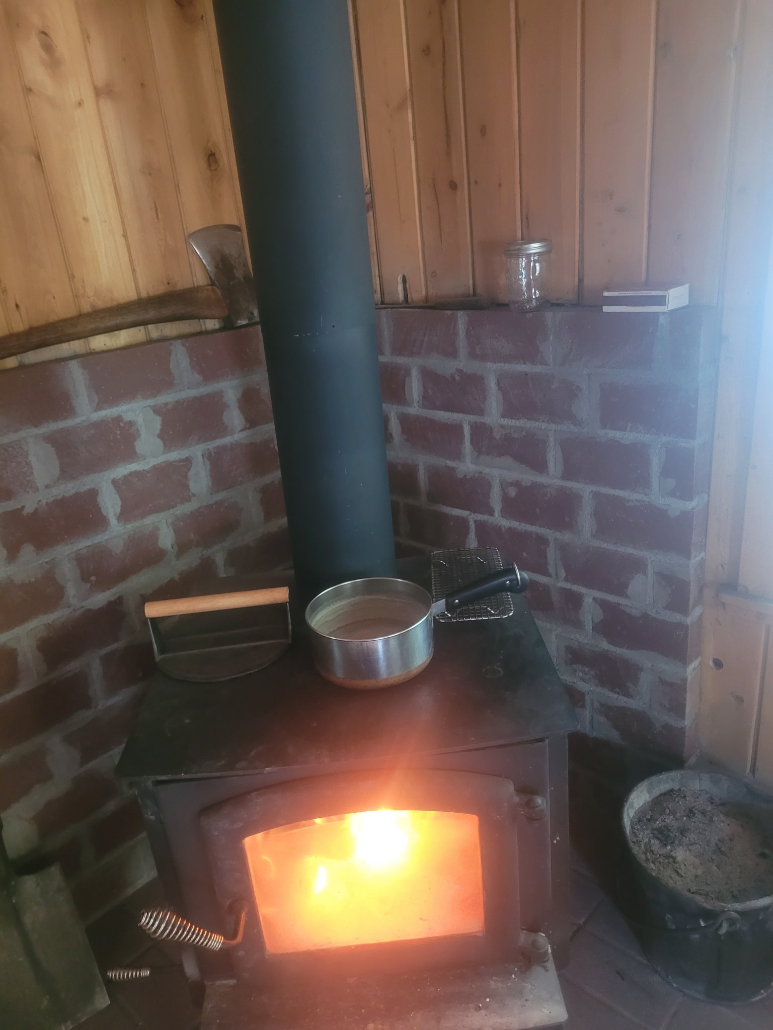

5 rounds will stay behind the stove overnight at about 105 deg
The other 5 rounds will stay on the bench at room temp.

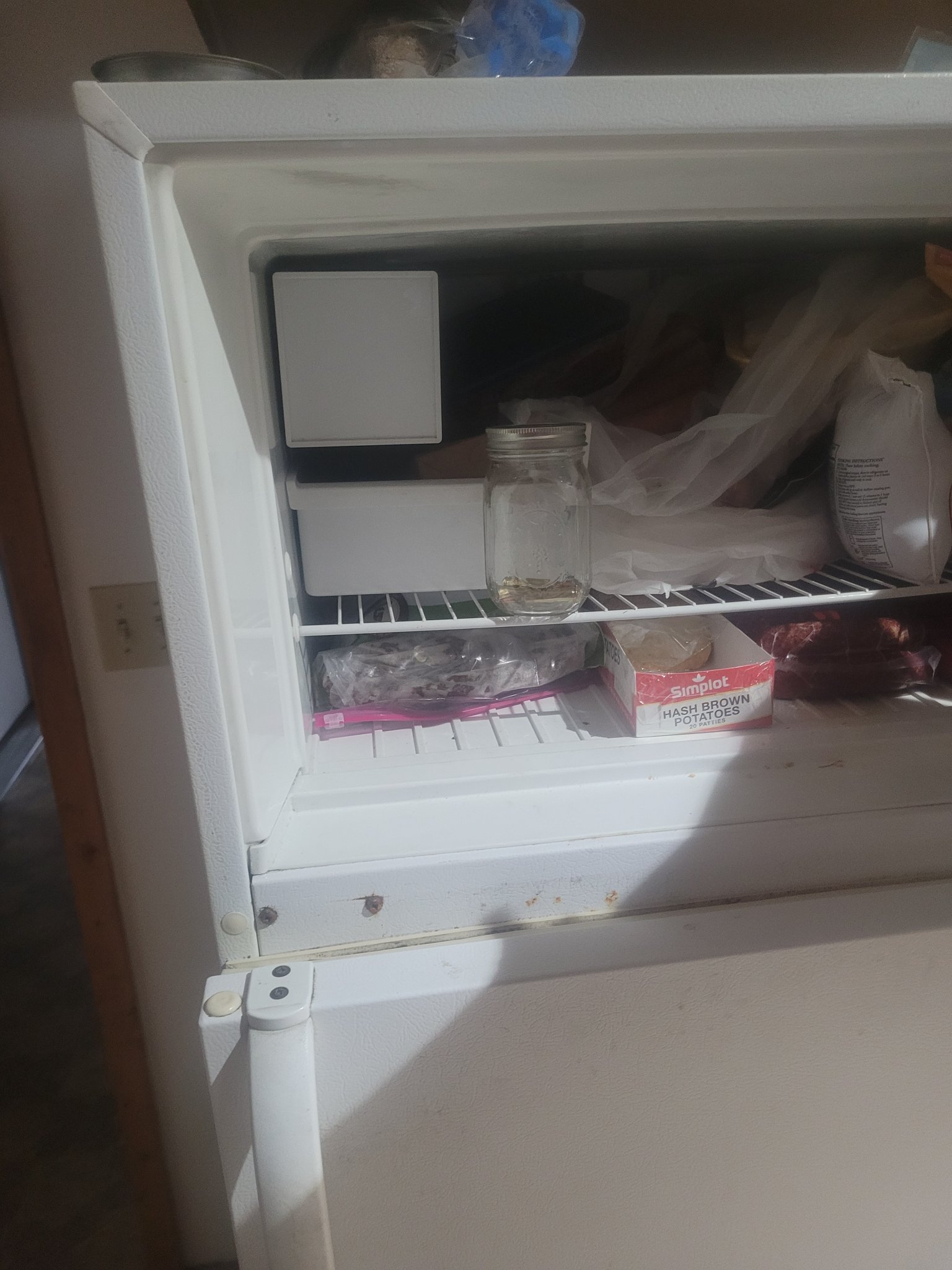

The last 5 rounds will stay in the freezer overnight.
I'll post up tomorrow with results.
UPDATE:
Frozen rounds
5 deg F
2794 fps
Room temp rounds
60 deg F
2786 fps
Heated rounds
150 deg F
2860 fps
Looks like this powder is a winner, gents.

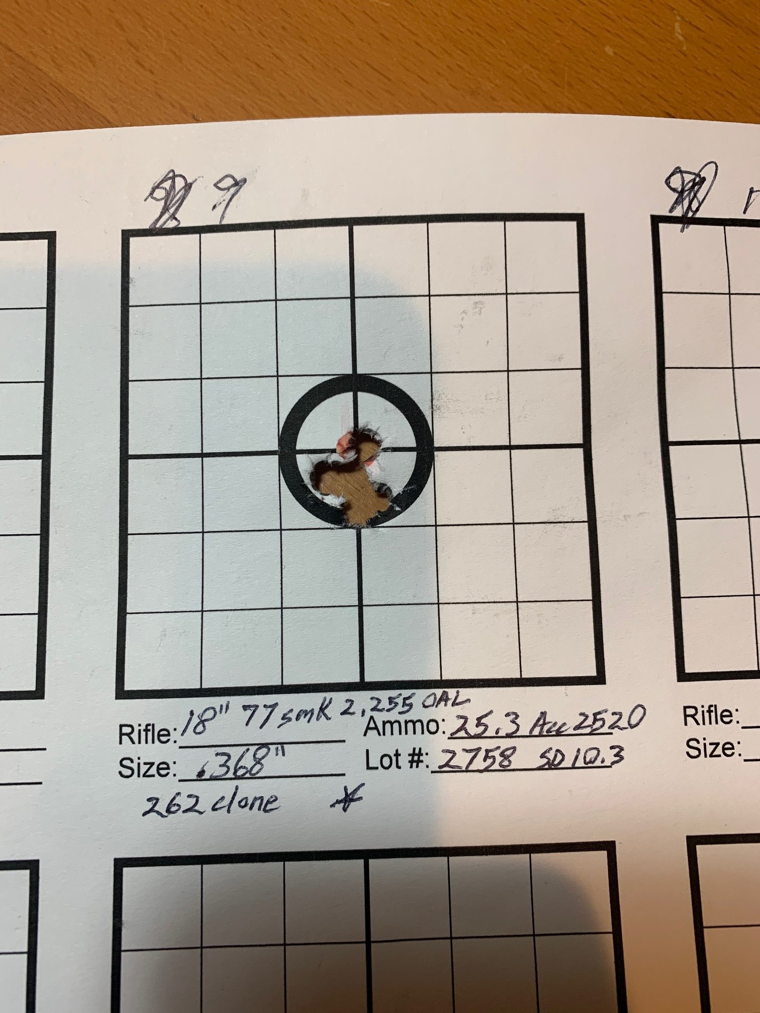

Follow up to my post #40 from the range today.
I8" Proof with Vltor A5 H2 bi-pod/bag.
Previously with Mk262 clone loads I'd only shot 3 shot groups checking speeds & looking for workable loads.
Best were
Staball Match
25.1 2772 / 3.6 / .822" No bolt lock on empty
25.4 2804 / 11.5 / .819" No bolt lock, no swipes, no flow. Will try at 25.7
Accurate 2520
25.1 2735 / 6.0 / .464" Bolt lock
25.4 2786 / 10.0 / .175" Bolt lock. Nothing ugly on brass.
Today I shot 5 shot groups & tweaked loads a bit hoping to get a little better accuracy from the match & succeeded. Hopefully SD's will improve with fire formed brass & GM205AR or cci #41 primers.
Changed OAL from 2.255 to 2.265. Still using all virgin 223 IVI Ruag primed brass.
77 SMK Staball Match
25.2 2737 / 16.4 / .535" Locked back on last round. Brass GTG. Still faster than the Black Hills 77.
Also Confirmed my gun just plain likes Accurate 2520 better with these MK262 loads.
77 SMK @ 2.255 Acc 2520
25.3 2758 / 10.3 / .368" Lock back & brass GTG.

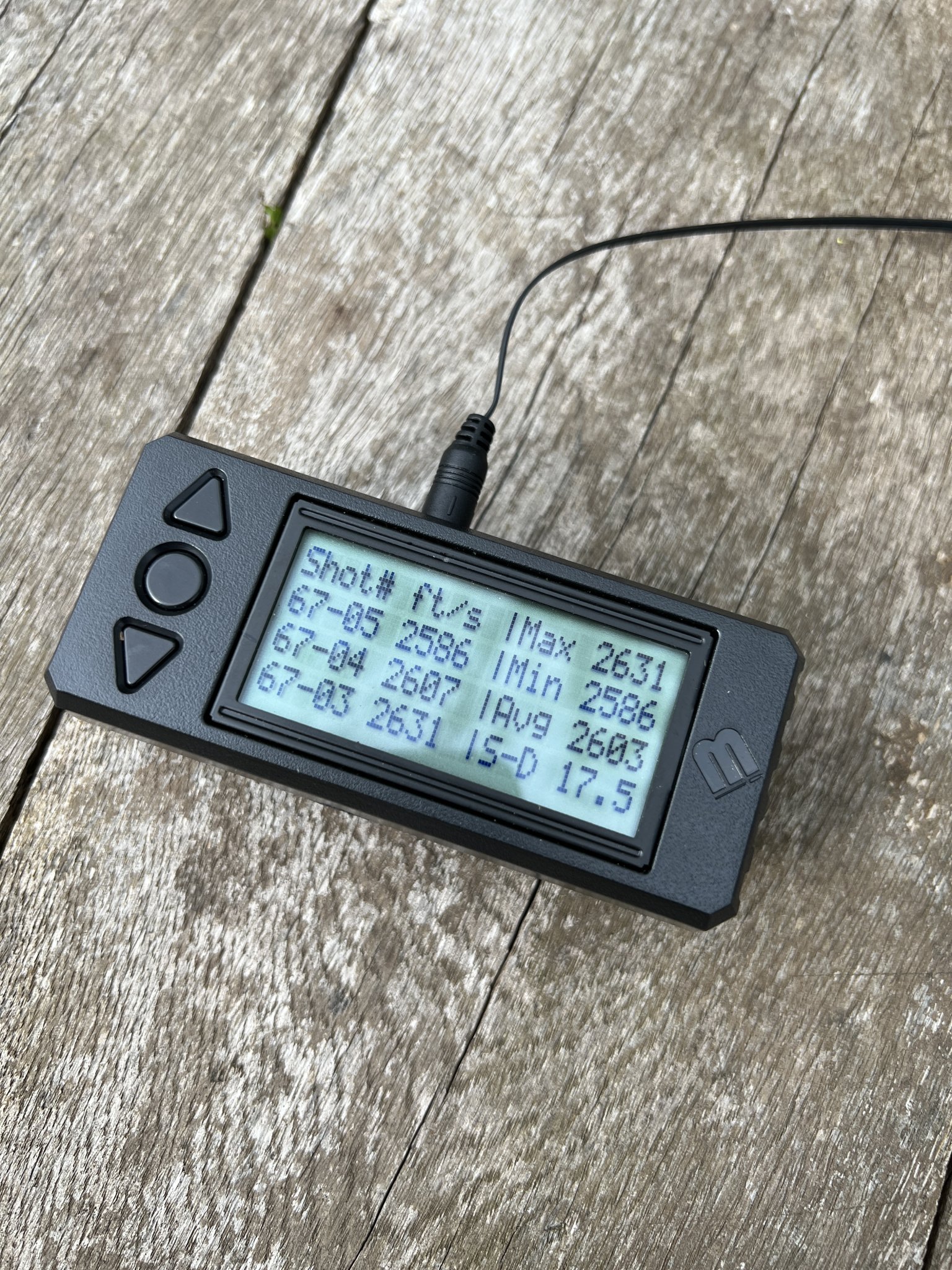

I just got my jug of Staball Match in today and ran some loads through my gun to just test velocity.
I will be ordering more of this stuff.
Here are the specs.
18" WOA SPR running a H3 buffer.
LC cases.
Win primers
75 gr Hornady BTHP
Hornady's starting load gave me 2600 fps
25.0 gr 2730 fps
25.3gr 2818 fps
25.5 gr 2824 fps
25.9 gr 2832 fps
I saw an ejector swipe on the 25.3 but not on any higher charges, so idk. Primers looked fine on all. The higher charges were flat, but not overly so.

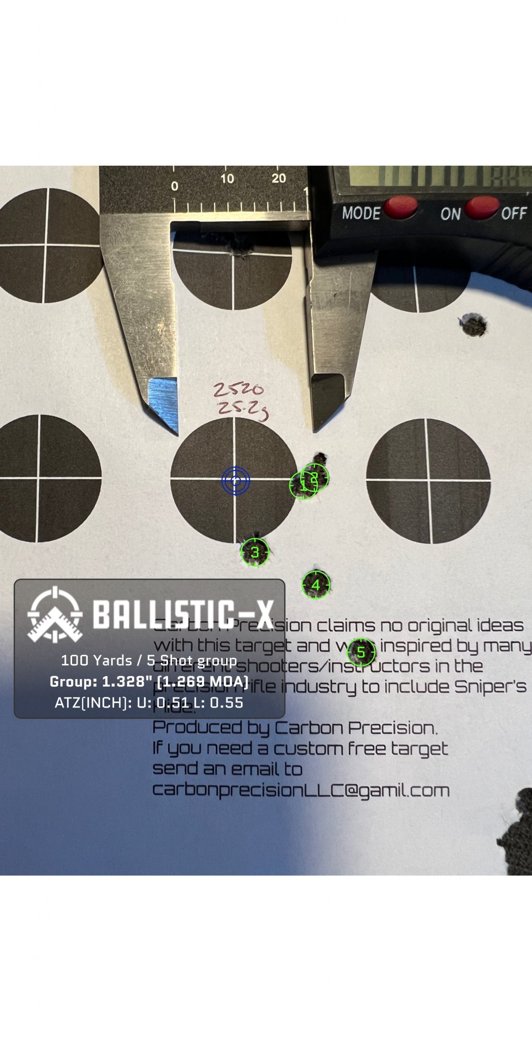

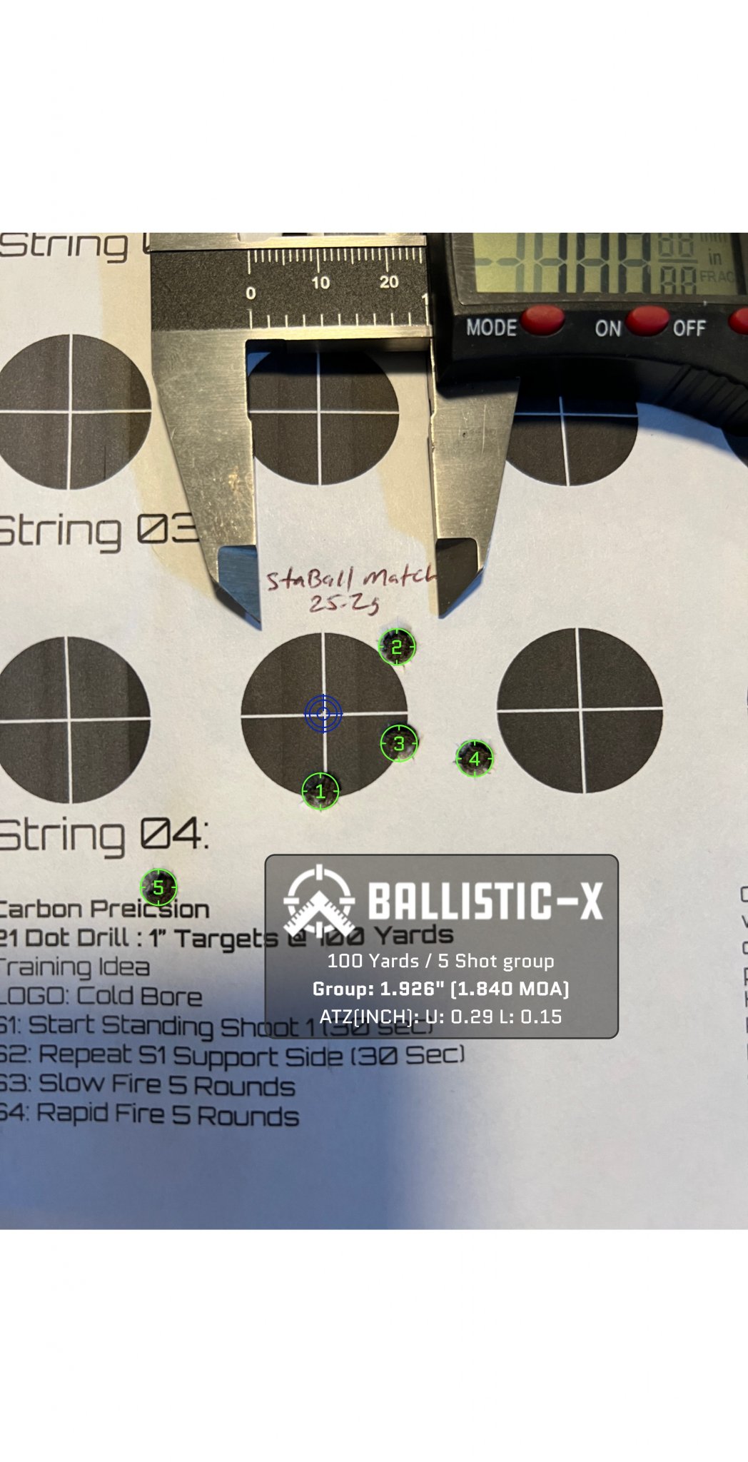

Compared StaBall Match with Accurate 2520 today on my quest for a Mk262 clone.
Both loads were 25.2g of powder, tested back to back with CCI #41 primers, Sierra 77g OT match kings.
Out of a 13.7” 5.56.
StaBall is the top, Accurate is the bottom. Pretty darn close lol.
A few ejector swipes on a few pieces of brass, but nothing overly concerning. :)
Accuracy test in the next few days.

Testing went pretty good.
These groups were shot @100 yards with a 1-8 ATACR so read into them as you may. But they were as about as I expected them to be.
