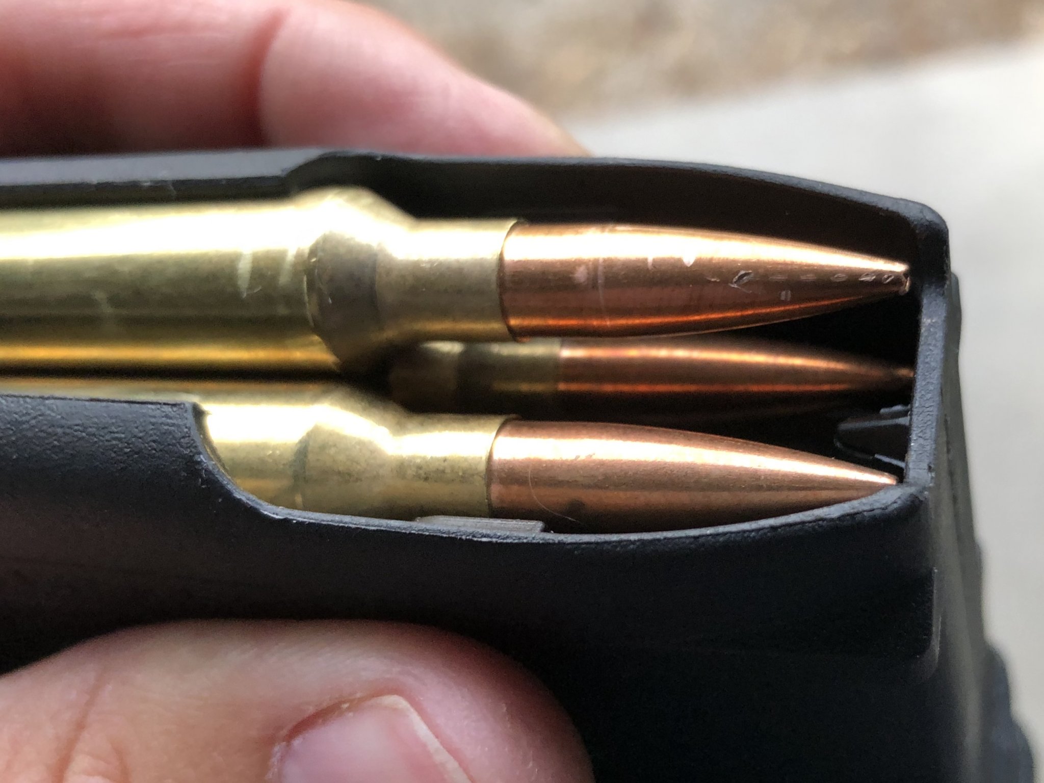

Hey guys,
I'm a new shooting, just built a Stag10 with a 20" 6.5 Creedmoor barrel, Brownell's BCG, Stag buffer spring, and Superlative adj. gas block.
Took the monster to the range for break in this morning and after 4 shots had the gas block adjusted to spit out brass at 3:30ish. Shooting great, but the brass looks a little rough. The bottom of each cartridge has nicks and chew marks on it from (I'm assuming) ejection?
Is there anything I can do?
Also, I removed a chambered, none fired cartridge and the bullet had a few deep scratches on it, from chambering I'm assuming? As it slides into the chamber maybe? Not sure?
See pics & Video
Is this normal?
Thx!
VIDEO OF EJECTION

Can we get a picture of the claw on the extractor? I'm guessing it's super sharp.
Also sharp feed ramps.
Is that something that can be “filed” without screwing anything up? I’ll get some photos tonight

I’m going to snap a few more pics tonight and hopefully that will help with the diagnosis
