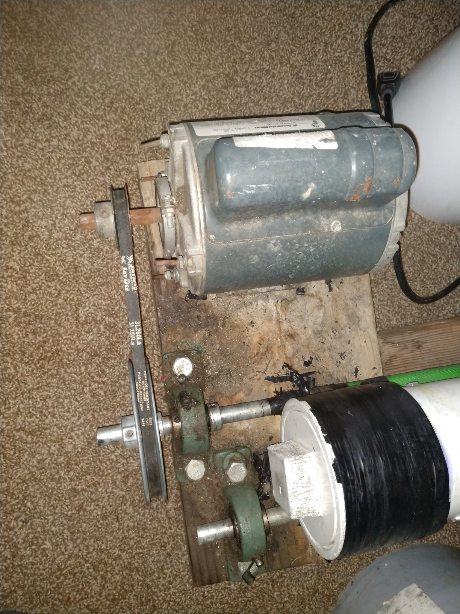

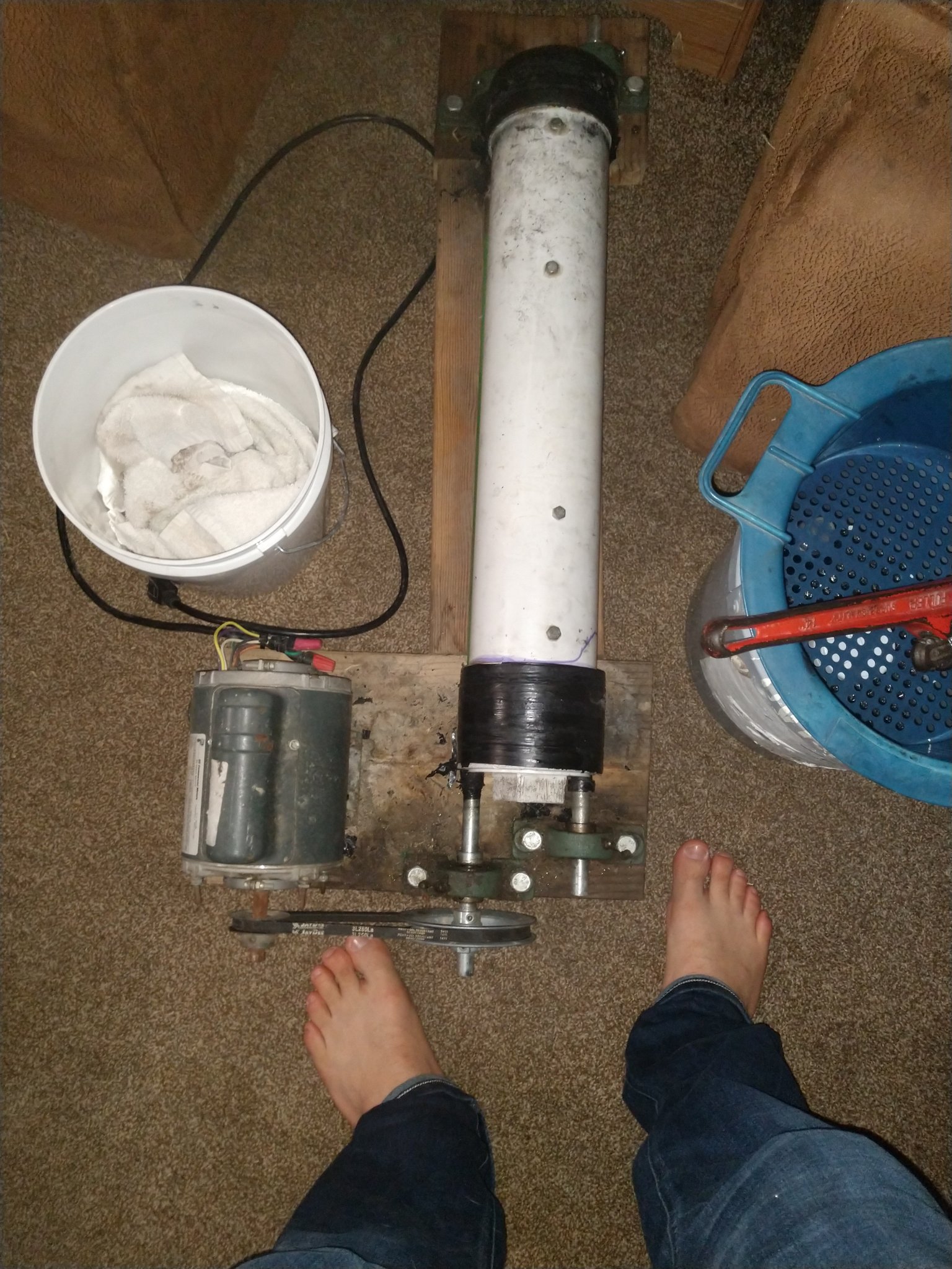

I only run my brass through my home made tumbler for about 30 min.... pockets are clean so are the cases... its nothing more than a barn fan motor and 4 inch pvc pipe with baffles inside... case mouths are acceptable to load after....

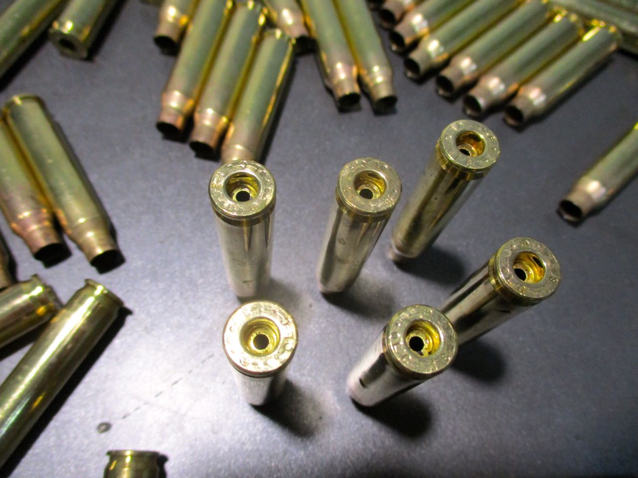

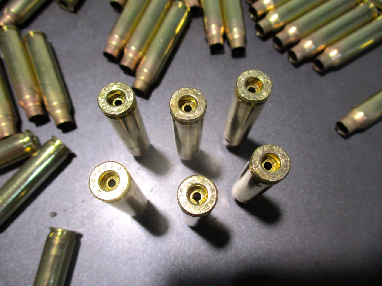

I'm a rookie at this but I tried the steel pins in the tumbler technique once and it sure beat the edge of the mouth opening. Didn't like that so got a RCBS ultrasonic cleaner and their case cleaning liquid. It works great so far with no damage to the brass. It seems to come out as clean as with the pins in a tumbler. I run it for three 30 minute cycles. Here's a couple photos after rinsing them off and before drying:
