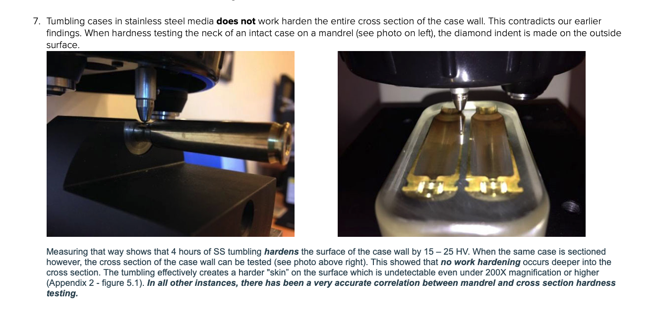

I like SS pin wet tumbling as it completely cleans the primer pocket, in and outside the case with the least effort. Most loading I do is for auto loaders so the brass gets dirty, and I dont like handling dirty brass during the prep inspection stage for a multitude of reasons.
I ask after reading this and trying to wrap my head around it? How I understand what information is presented above that it only does so to a very thin outer layer, while the inside remains unchanged.
Is this enough to be detrimental? If so how have you come to this conclusion?
Reactions: spife7980
What exactly is the risk in this Peening you mention?
The risk? The risk is you have oversized case mouths that cant feed in a trimmer or a sizing die. If you leave them in to long, you run the risk of ruining the brass.
Here is an example. I was cleaning 500pc of 6.5cm Lapua in the tumbler. Had it set for 30 minutes and went upstairs. The timer broke and when I came down the next morning, all the necks were peened. Since they were already pretty much trimmed to min length, I had to trim them about .010-.015 under that. But since the necks were peened, they would not slide over the case pilot on henderson. So I had to hand ream 500 cases and cut enough out of the inside so it could fit over the pilot so the henderson could cut the peen off the otherside and chamfer the case mouth. This took many many hours and some carpel tunnel syndrome later.
Also seen this start with some alpha brass after being in there for a little over an hour.
Its not worth the risk, and not needed to leave them in there more than 20-30 minutes. They get more than clean enough and your brass does not risk getting damaged.
Reactions: Timo Turl

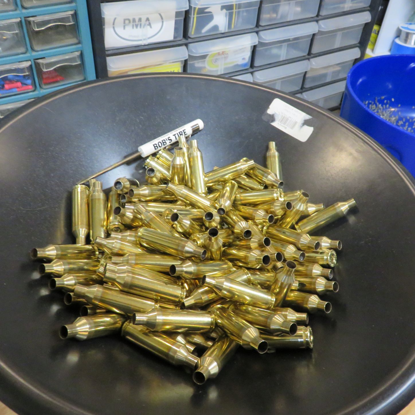

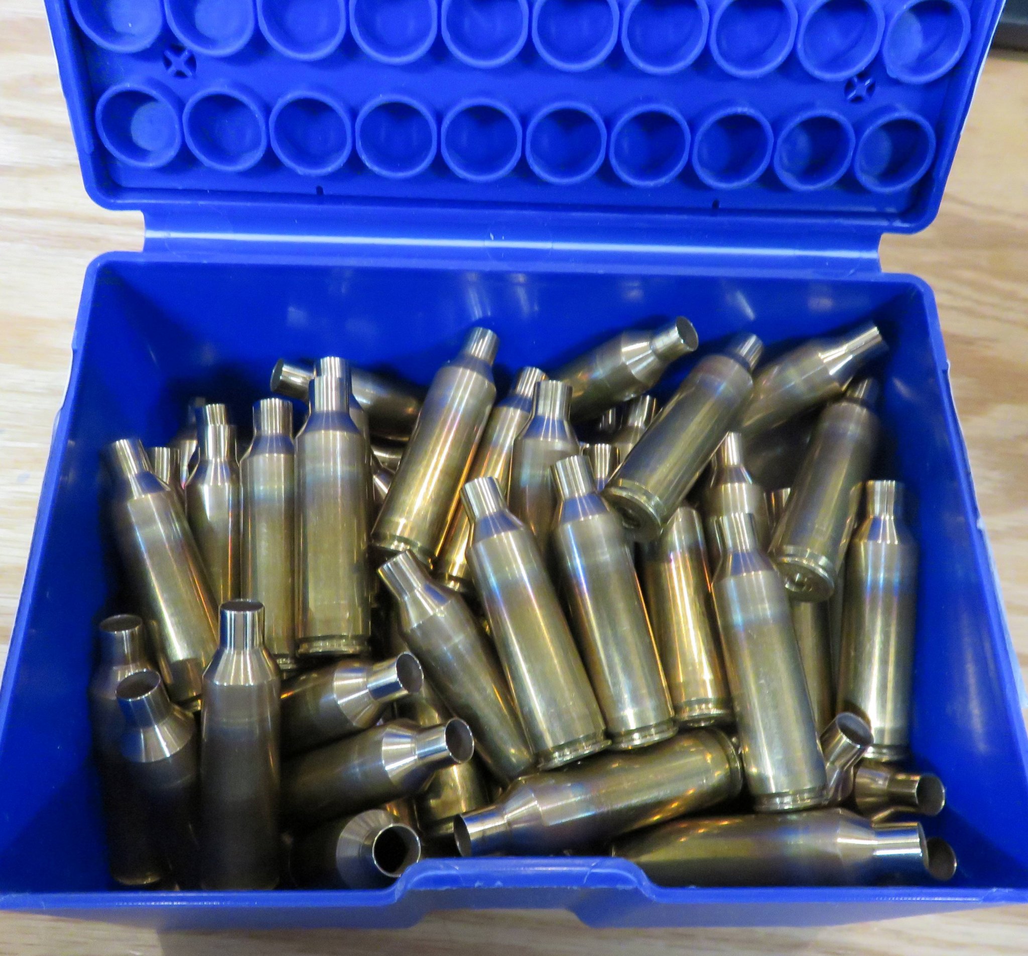

My brass never gets ejected into dirt or mud, so they don't get very dirty. After depriming, I anneal my brass then use 000 steel wool to remove the oxidation layer left behind on the neck and shoulder (just 2-3 twists). I use Imperial Sizing Wax for lube, so after sizing I tumble in the rice to remove the lube. Typically, I only run the tumbler for ~30 minutes and the result looks like the picture of brass in the blue box below. If I run it for a long time (like 2 hrs), the brass looks like the other picture below (both pics are the same brass):

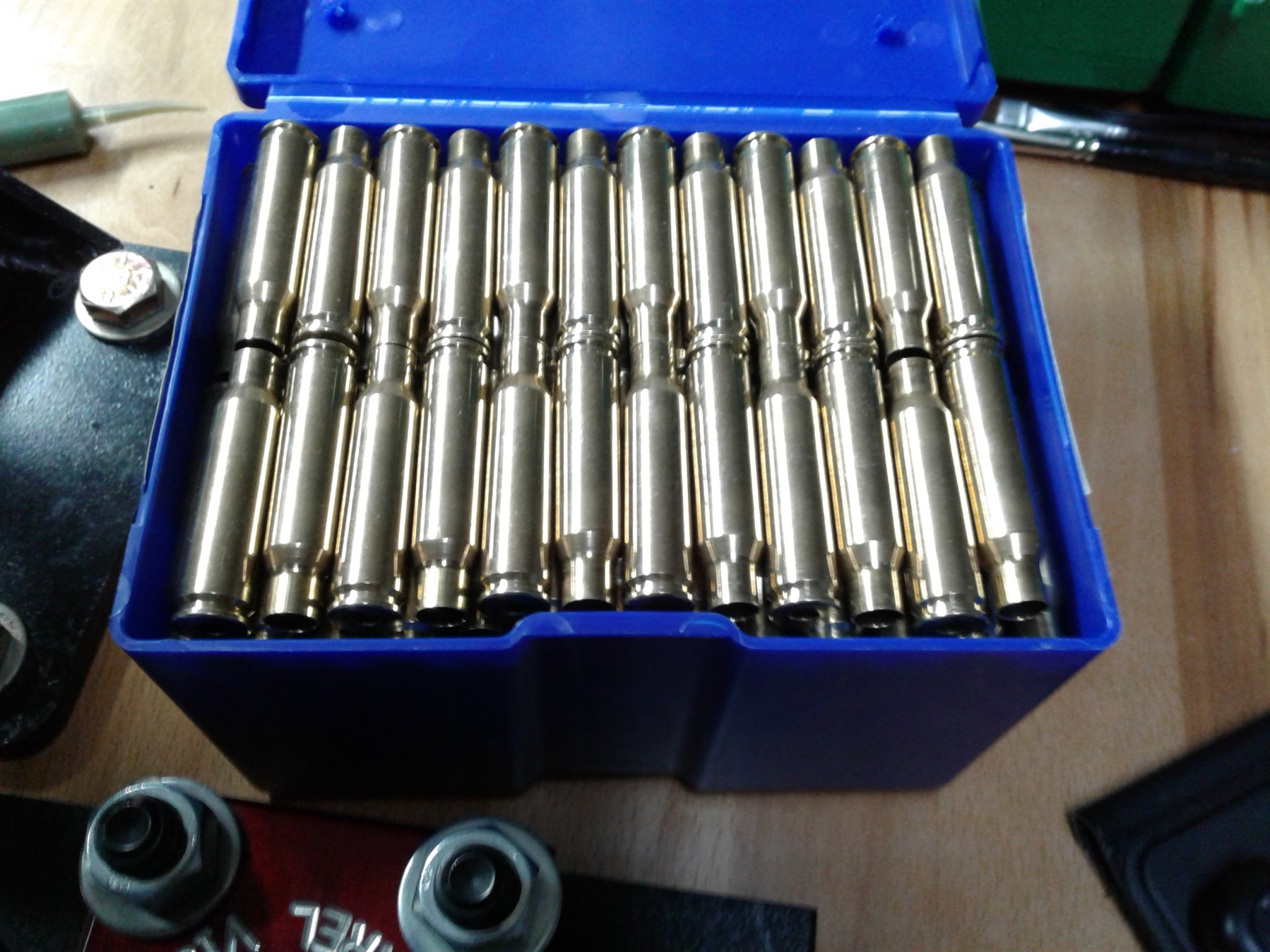

I can't recall the last time I shot a rifle unsuppressed. How does your bolt action chamber get dirtier with a suppressor? Automatic rifles begin unlocking with positive chamber pressure, bolt actions do not. To answer your question directly though, no, I don't have any of those issues.
3rd firing, never cleaned, always suppressed
My lapua palma brass necks look just like that after 4 reloads.
I will size with just a lee collet neck die for 4 reloads and at that point just start to feel restistence on the bolt.
Then clean in walnut media and full length resize.
The bass after a tumble in walnut looks much brighter and cleaner than any new brass ive ever bought.
Pic below is after 4 reloads without cleaning then tumbled in walnut before FL sizing and carbon still in the necks.
