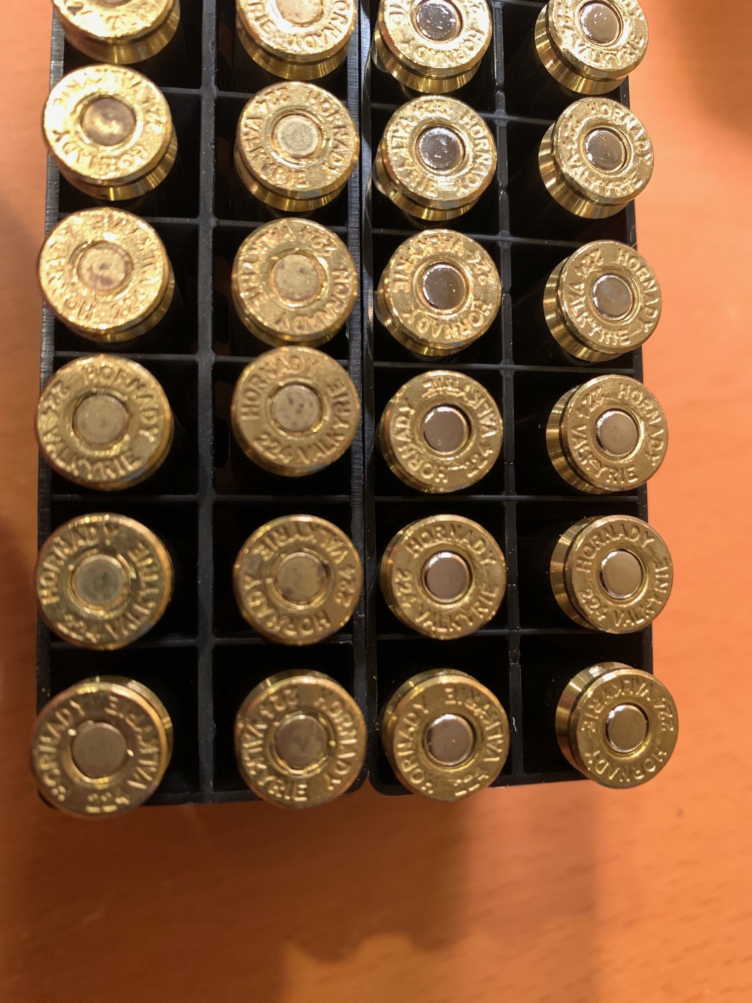

Well I've got 2 different lot #'s of the same Hornady Match .224 Valkyrie 88 ELDM's
One lot is staked primer & these primers look like crap. Other lot not staked with normal shinny primers.
Why the hell is Hornady randomly staking primers??
