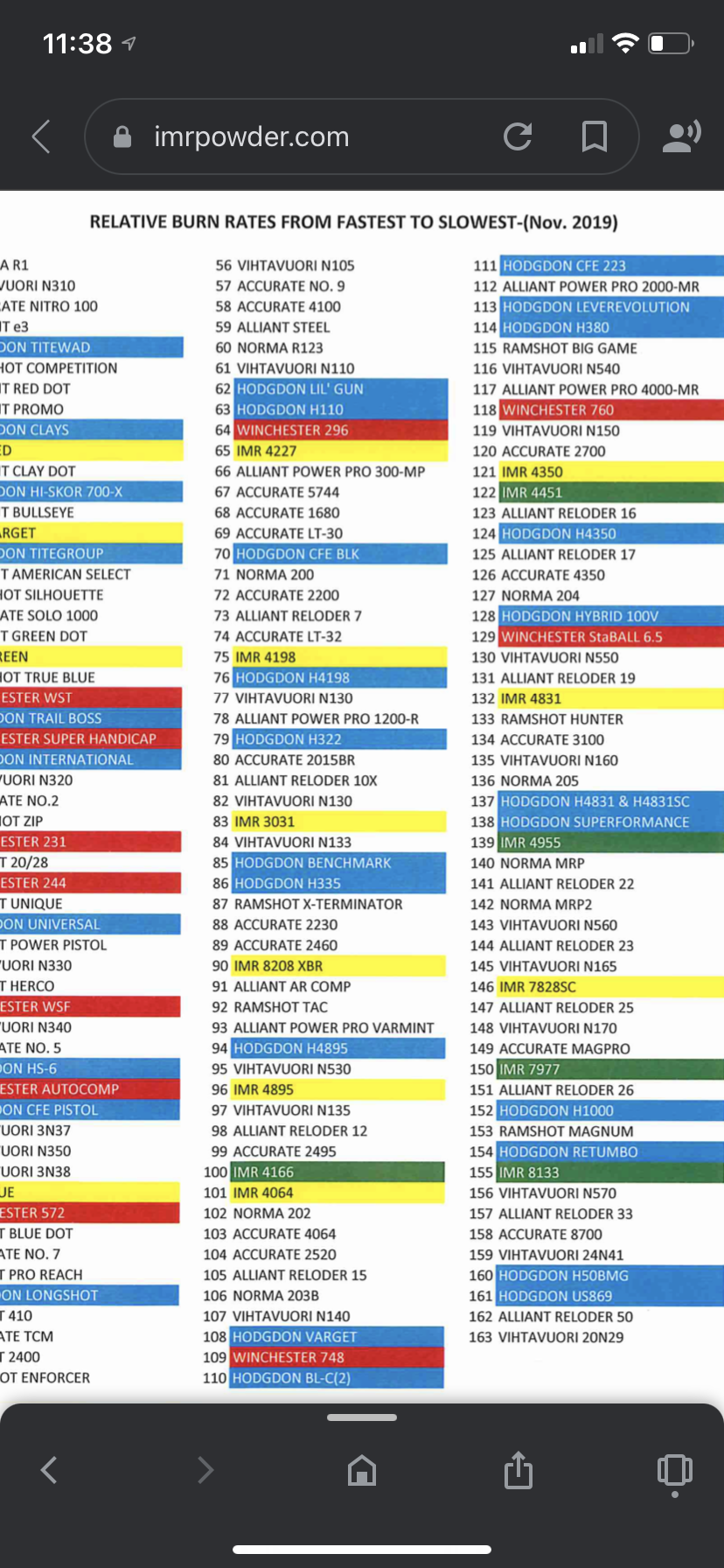

Anyone want to share starting loads for 6GT with RL16 and Shooters World Precision Rifle? Varget has disappeared, but I have some of each I would like to try. Using 109 Berger Hybrids. 26 inch 1:7 barrel.

Don't remember what I worked up from, and working out of town this month, but I settled on 33.8 gr of SWP. That ran 2920 over my labradar. 34.2 or so of Varget ran the same 2920. I think the SWP runs a little cooler than Varget, but that is only my impression, I don't have hard data to support that. Haven't tried the RL16 yet. Overall, pleased with SWP, plus it is available. Varget is like unicorn teeth.
