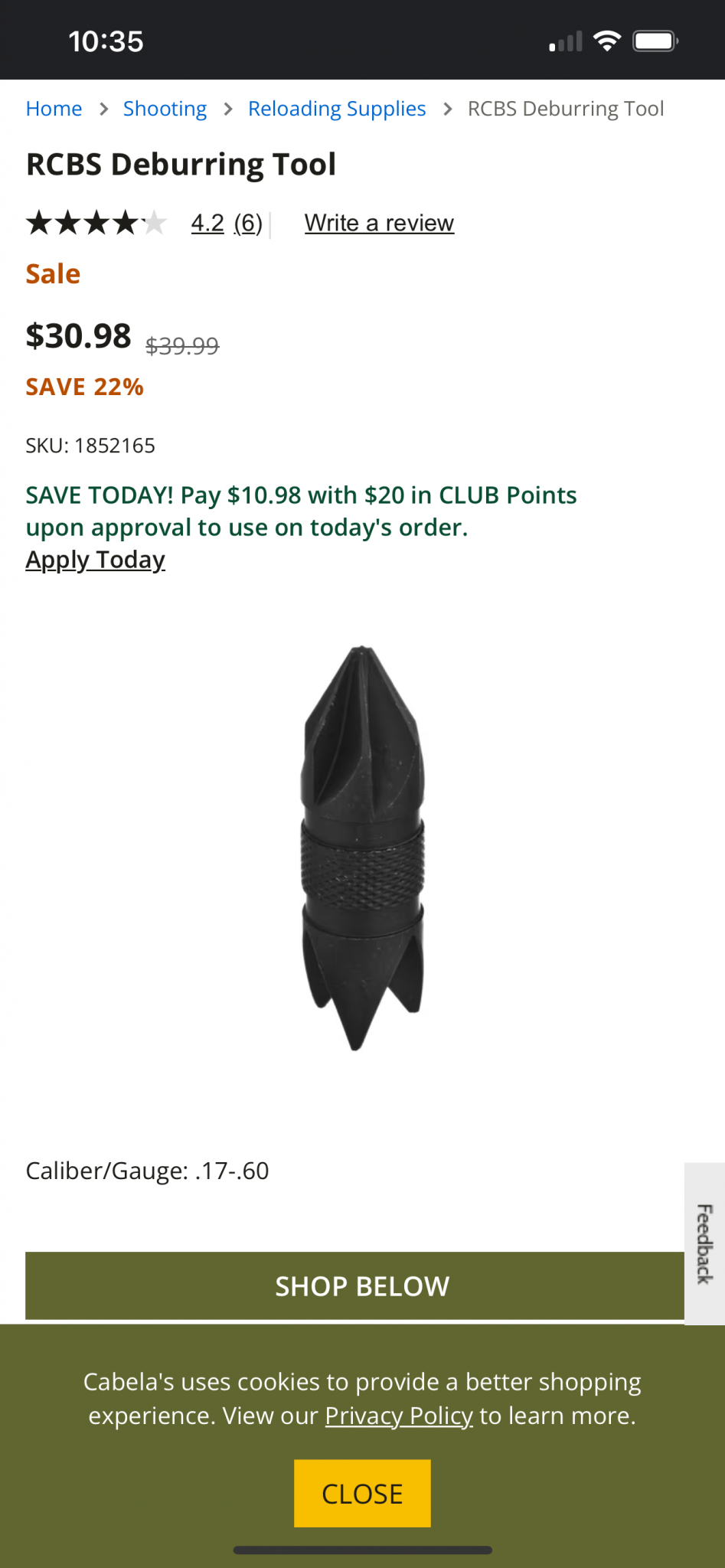

I personally like the tool linked below vs the longer type. Find it easier to hold/turn in hand because of its shorter size. You could also spring for a rcbs case prep center as well. You’ll also want a brush for the inside of the necks
Also add a trimmer
Is that for deburring the inside of the case mouth? You wrote,
Do you literally hold it in your hand, stick it in the case mouth, and start twisting?
How well does that work?
I was looking to buy one that I stick in an electric drill.
Yes that’s how it works. Inside and outside. I twist back and forth with the casing in one hand and the tool in the other. Easy peasy
