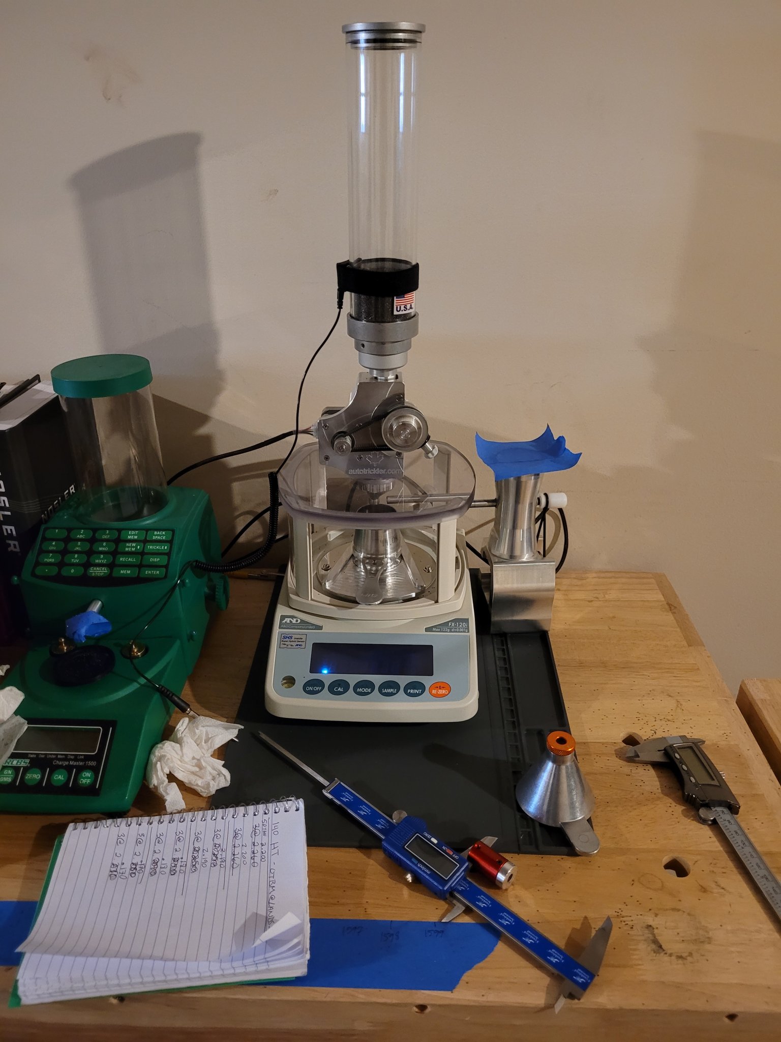

Static is making me crazy!!!
BuildingConceptsllc
Don't Start None, won't be none.
  • Nov 13, 2020
    7,199
    7,409
    Alabama
    I have got to figure out a way to keep static from killing my production with my V3. I have it on an antistatic Matt, and have the little ground wire. I can't get through charging 25 cases without static making me stop and messing up the scale. There's got to be a way to do this???
    Is the static coming from you? Perhaps standing on an anti static mat and/or a grounding band for you is needed.
    Examples, I'm sure there are less expensive mats out there:
    Code:
    https://www.amazon.com/Rhino-Mats-CSE-3660-Dissipative-Anti-Fatigue/dp/B00EQC732Q
    https://www.amazon.com/Rosewill-Grounding-Alligator-RTK-002-Detachable/dp/B004N8ZQKY
    Is your home older ?
    Many older houses are not grounded with the now common 6 foot copper rod driven into the earth with a bare copper wire to the main electrical panel.
    If so your ground wire does nothing.
    Hey, sorry, it's the first thing that popped into my head and it is worth checking.
    I have a ground rod, and it's a pretty good ground at the panel.
    Code:
    Possibly. I don't really know. It just starts popping up on the scale and is very hard to get rid of. I've tried staying away but that doesn't have any immediate effect anyway.
    What issue exactly are you running into?
    I will start charging after letting my scale warm up for a while. Everything is good, until I charge maybe 10-15 cases , or sometimes it's less sometimes more. Then my scale starts creeping in the negative. Sometimes I can get rid of it by wiping everything down with a wet paper towel but most of the time I have to wait for it to go away, and that can take anywhere from a ew minutes to 10 min. It totally screws up charging my cases.
    So untill you get personal grounding straps, antistatic mat and ozone machine?
    Take off one shoe and sock.
    Will that help, just going barefoot or is the one shoe and sock needed? It happens when I have what I use as my house shoes and don't have socks on but I am rarely barefoot in my loading room. I am fine with that if it works though
    One or both feet doesn't matter you will drain static from everything you touch to the floor.

    Send us a picture of your set up.
    I had a lot of esd training maybe I can help.
    They make wrist straps (that get in the way) and ankle / shoe straps that dont much bother you.
    Touching that mat under your scale should help.
    It's dry here today, I'm shooting blue arks about an inch if I don't drain down.
    If the scale sets on rubber feet the mat may not help much. That insulated gap needs closed / connected.
    Yeah I have a wrist strap for it but it did t seem to matter. I will post pics shortly when I get back. 5 min

    If your static bench pad is grounded well then the probably rubber feet of the unit is insulating it.
    A jumper from unit to ground will fix that and you being grounded will help.
    If the unit is choked up and you touch it and ground it should quickly bleed off.
    You would think that scales had an official ground connection provided. Especially the more advanced ones for the price.
    Why specifically do you think this is a static issue? I’d put the scale on the wood, use a decent power conditioner, and leave the scale on full-time.
    The feet are plastic feet I believe

    On the back of the scale there's probably somewhere I could clip that alligator clip to the scale itself. You think that would work?
