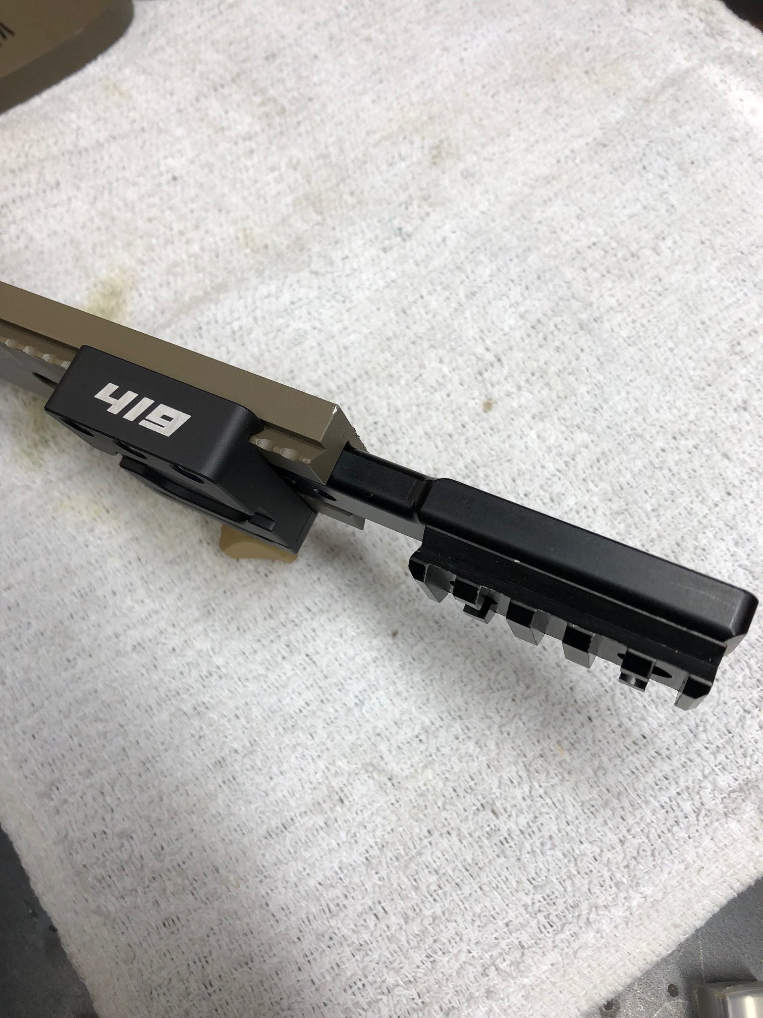

Area 419 has one with brass weights in it.
Ive seen this and various other weight adding options from other manufacturers. But why pay extra for a lighter aluminum rail and then add additional weight to it if you could just use a heavier denser material and not mill most of the material out to lighten it up from the beginning.
pyplynr hit the nail on the head. If you've seen this as you said, you would know he's referring to the one made of steel which has brass weights that are heavier than the equivalent steel. I have one that came with my Manners TCS.
Reactions: db2000 and PAYDIRT
I believe you are referencing this?
This is still an aluminum rail with a bunch of operations done to it and then hard anodized. Then weights are added to it. End max weight is listed at 23.6 oz.
A similarly sized and milled piece of steel of comparable length without any additional operations to lighten it will weigh 21.75 oz.
Now I understand that the steel option isn't tunable. But if you just want to add ass much weight as possible you are paying for a lot of extra time and materials to end up with something that could be done much simpler with nearly the same weight gains.
That's it. I'll back up a bit and say that I assumed since either steel or aluminum is available on the TCS that area419 would be offering this the same way. That's to be seen at this point. The steel version with the brass weights would be a heavy bugger and be close to what you are wanting.

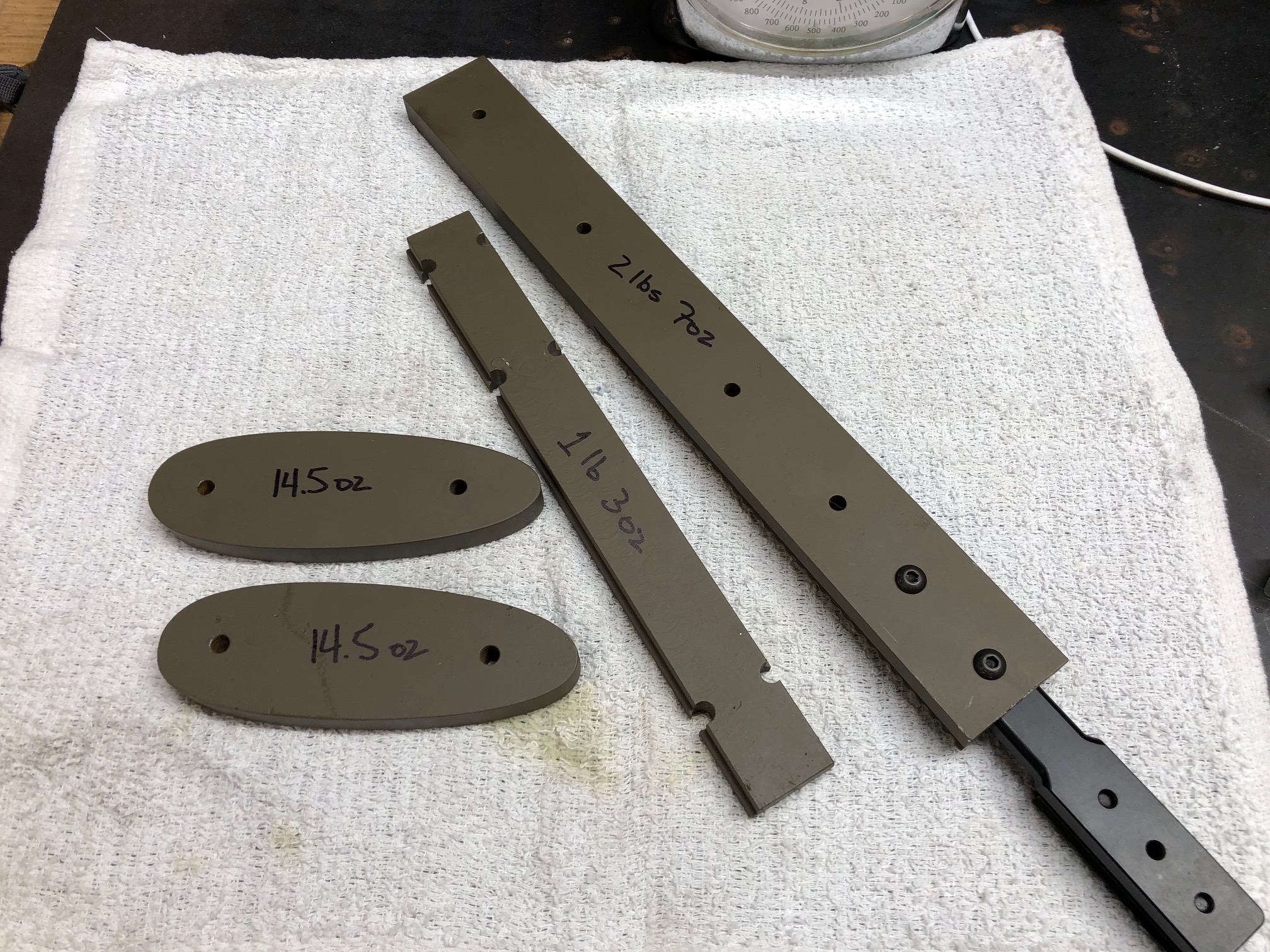

I made this stuff over the winter for 2 of my Bravo's.
Your on the right track with some 1018 bar stock and a 45* dovetail mill.
I've got a lazy winter day in the garage making this stuff.

My plan was to start long and cut it down until it felt right. Got an ACC now this is waiting to be built into another rifle. I’ll cut it down then.
That's a nice rail, but I was going to ask about flex. Seems like 2" beyond the fore end would be about the max?
Otherwise I really like what you did.

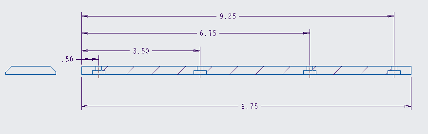

Originally I was thinking pretty simple. Basically just the flat stock with the corners taken off at a 45 to match the arca spec. I was planning on a 12" length. It could easily be cut down and holes drilled for mounting. Maybe I would have them mill a recessed area down the center.

I put the order into the shop today to make some of these up.
They will be 12" long and with no holes drilled for mounting. 12" length should weigh in around 19 oz. I could cut it to length for you and drill some holes for mounting if you don't have the capability to do it.
Send me a message if you are interested in one. $25 to cover the cost of the rail and shipping.
