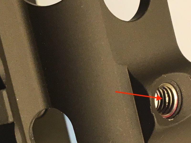

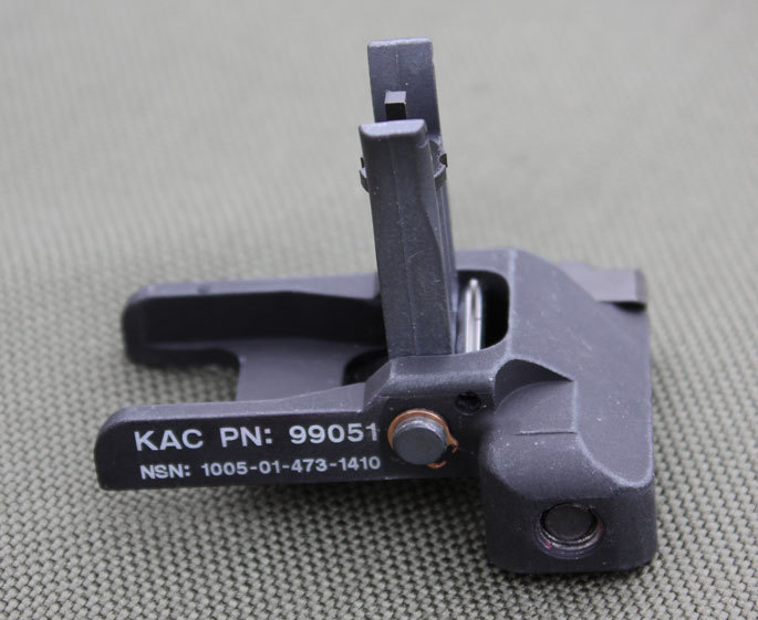

    I want to put some steel screws into an aluminum rail for an AR type weapon. I know the big manufacturers put a small sleeve into the hole, to avoid any galvanic response. You can see this in the following photo, looking at the screw threads, and again in the 2nd pic, and the bottom right screw. Typically, what I see is some pink or purple colors, so there must be an epoxy that is also applied.
    1) What is this called ?
    2) If I wanted to do this, where would I send work for some small screws?

    Longshot, that is a 'locking' Helicoil. The flat indicated in the below pic is a telltale. The red stuff is their flavor of a dry lubricant for anti-galling. Most Helicoils are stainless so if you use stainless fasteners there might be some issues. There are a dozen types of inserts but unless you're constantly threading/unthreading things then it should not matter enough to use an insert. If you're worried about galvanic corrosion use stainless fasteners in Aluminum. For aluminum it's best to use coarse threads too, not fine.
