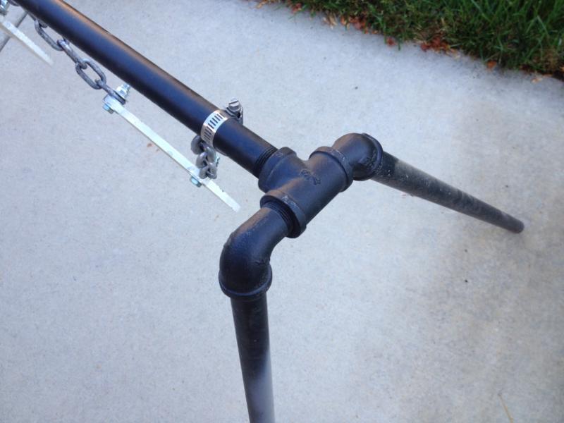

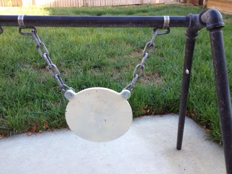

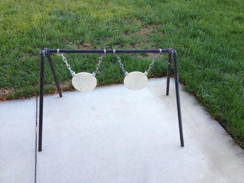

I bought 2 AR500 1/2" steel gongs from shootsteel.com a while back and they have worked great. I used 3/4" black pipe and a few T's and 90 deg elbows and made a portable stand that I shoot both .223 and .308 at a distance of both 100 and 200 yards. It works very well and have no issues with it all. It does get a bit heavy having to lug it out on the range but it works great. I'll try and set it up and get a few pictures of it up for you later today.
My only advice would be not to use chain, pretty sure 4 out of the 5 rds you mention will make short life out of chains. I suppose those connector links may work for a quick fix, but chain repair usually wont be done in the field, belting or strap will take a crap load of hits.
Here is the stand I cam up with, I do you use chain to connect to the targets, after thousands of rounds I've only hit the chain once. I keep spare parts in a tool box with me and can fix any broken part while at the range. When I bought the chain and was making the chain links, I made sure I made extra so I can have them ready if needed. The only parts I can't fix while out shooting are the stand itself and the pipe connectors.
