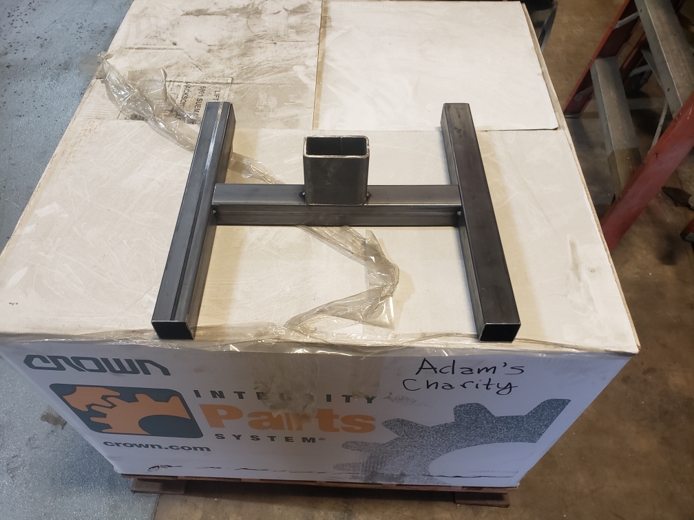

I have a few different setups. But this is my favorite. It is by far the easiest and most stable "portable" rifle steel setup Ive bought or used. 3 pieces easily thrown in the back of your car, truck or SUV. Drive out, throw the stand on the ground, dropped the protected 2x4 post into the stand, then drop the top mount/steel onto the top of the 2x4 post. We are talking setup or tear down in 30sec.
I take these to my local range so portable and easy to setup was my goal and this is it. Now if I had a permanent range where they stayed there then I probably would be using something else.

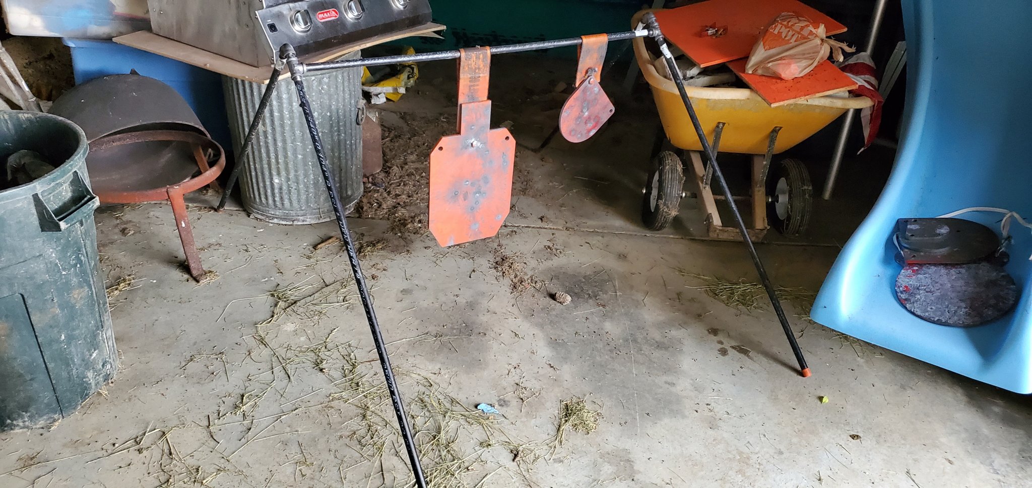

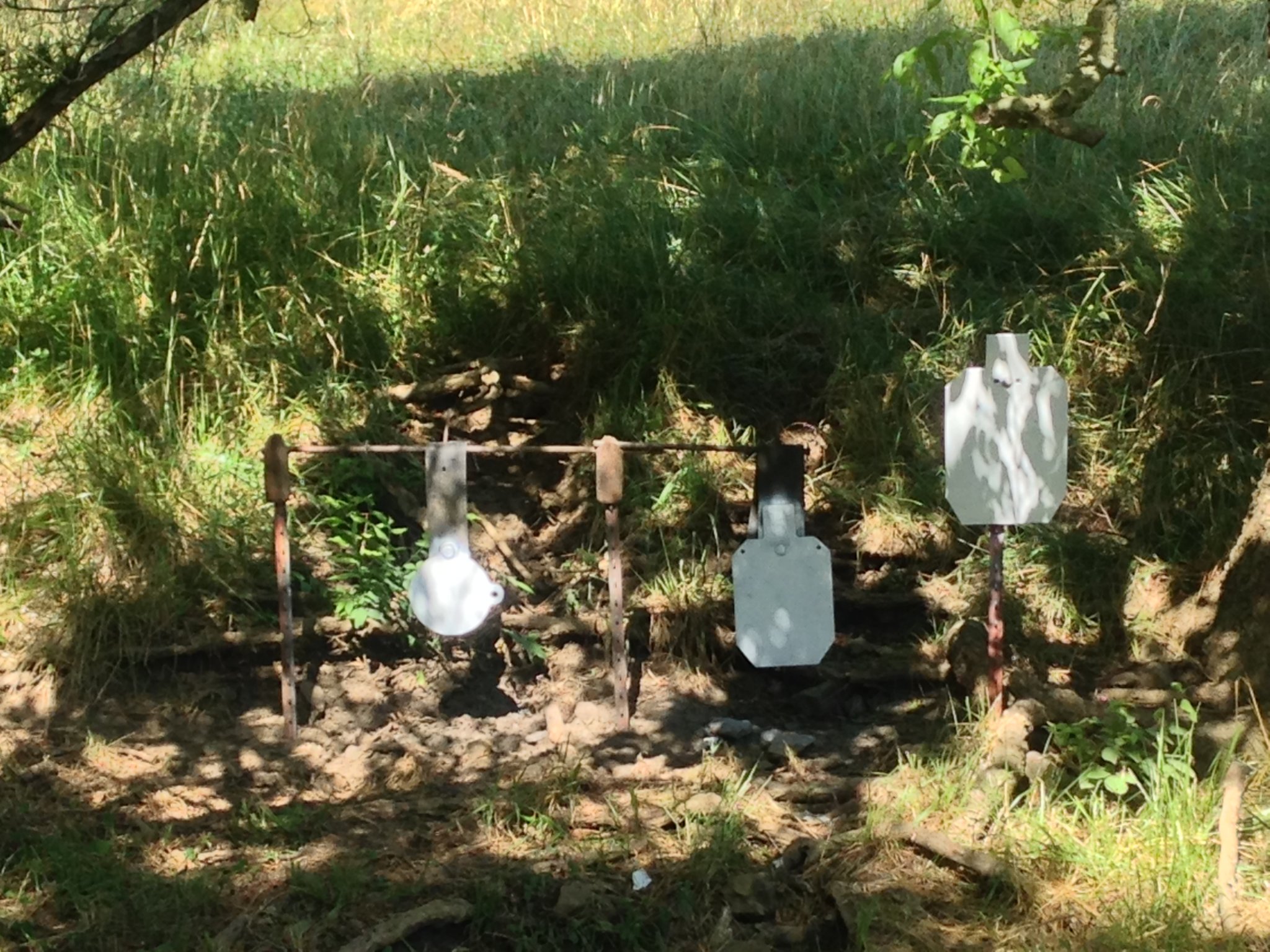

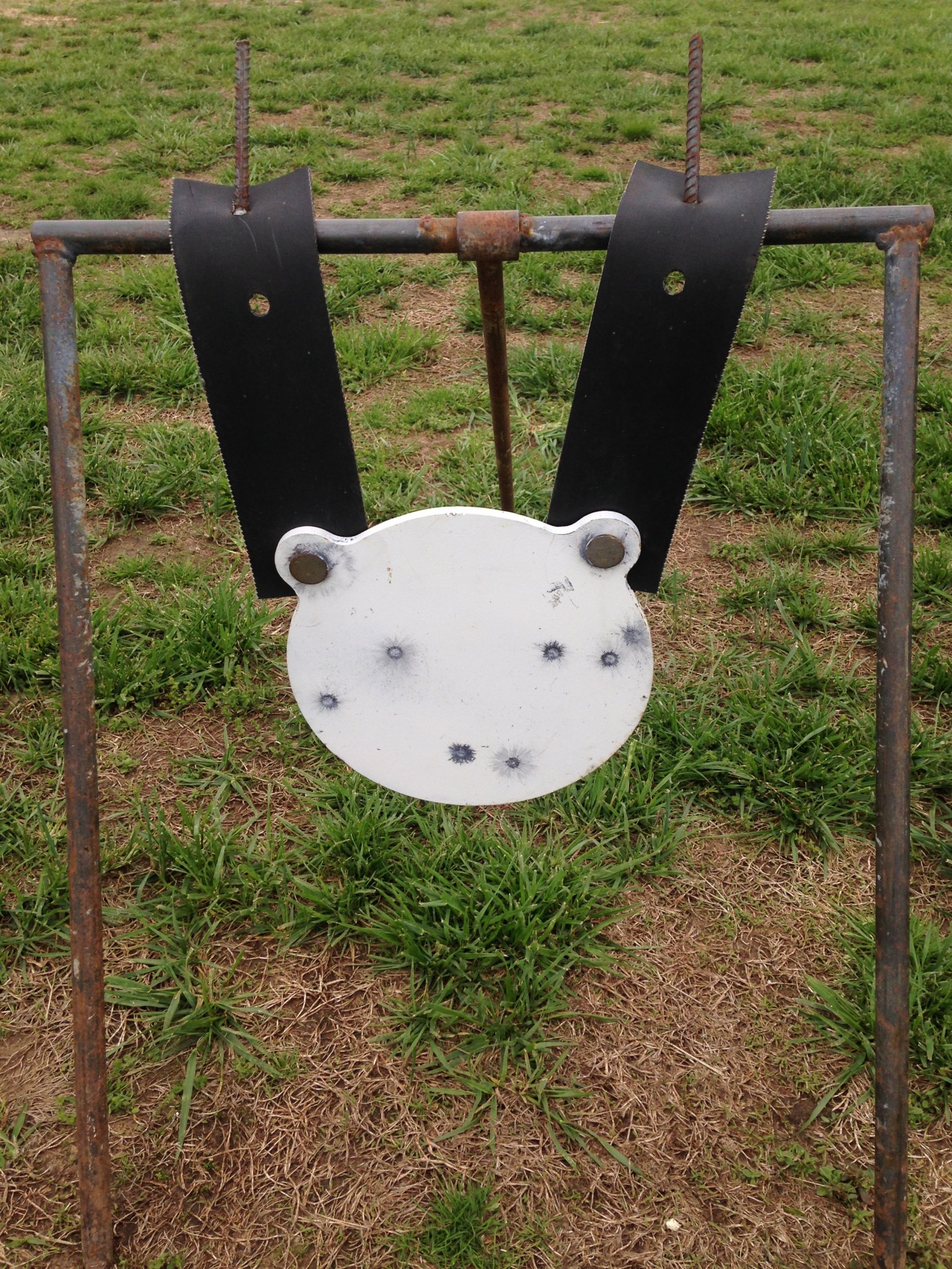

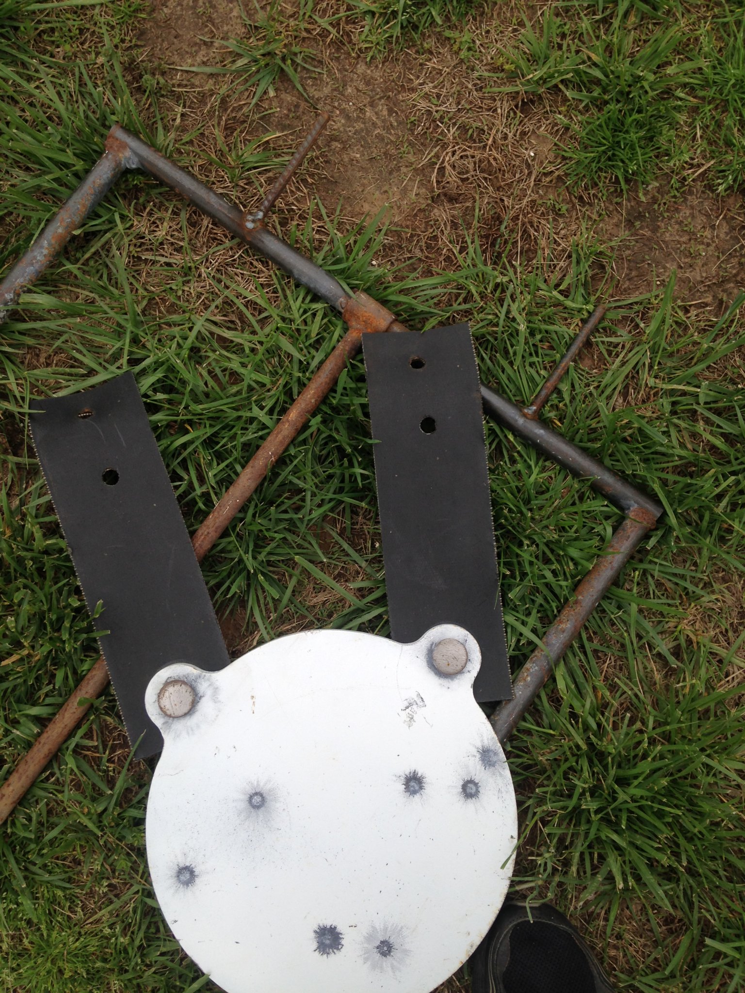

I've settled on the following...
Start with two ~8 ft lengths of rebar. Heat a short section with a torch to make a sharp bend. Cut two short lengths of rebar to weld across the sharp bend on the inside of the bend.
Those are the legs of a stand. For the cross member (to hang the target from) just slide another piece of rebar between these two legs.
If you have short lengths of tubing they're better welded on the inside of the legs' sharp bends for keeping the cross member in place.
Cheap, easy, light.

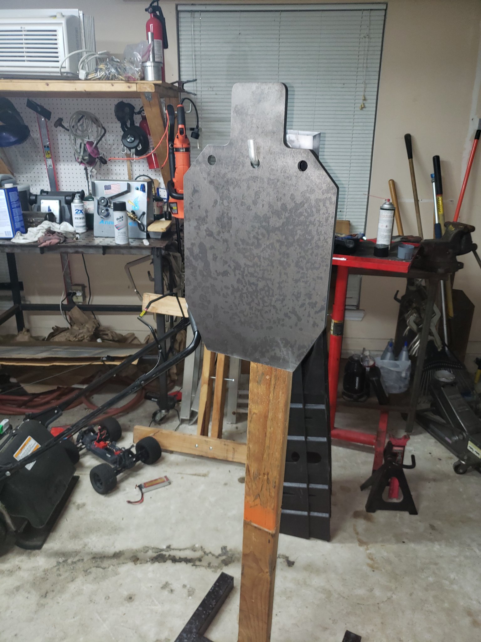

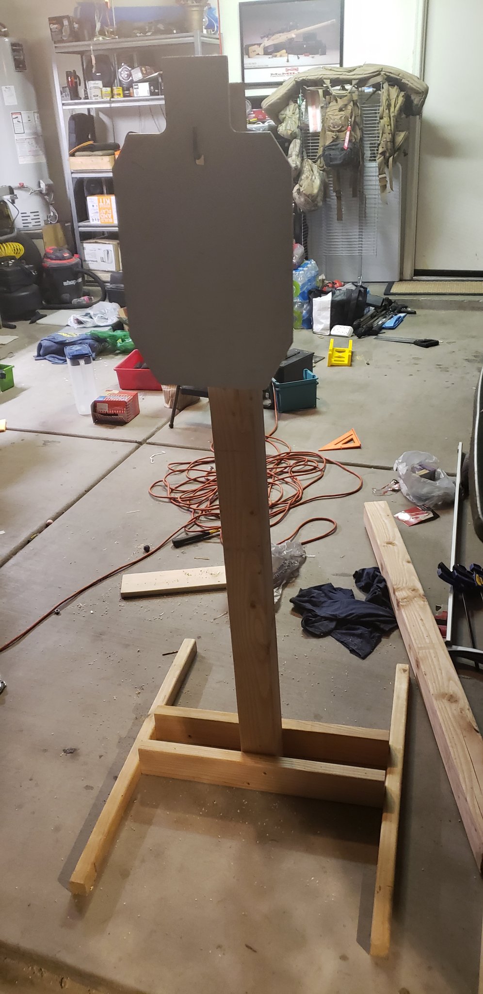

I built my own out of some scrap would pieces I had laying around. Used a 4x4, 2x4, 2x2s, some #10x 3in deck screws, and a bike hook lag that I had to heat up and bend so the target would go on. Semi lightweight and sturdy hit it with a 6.5 and 308 at 200 and it held up perfectly

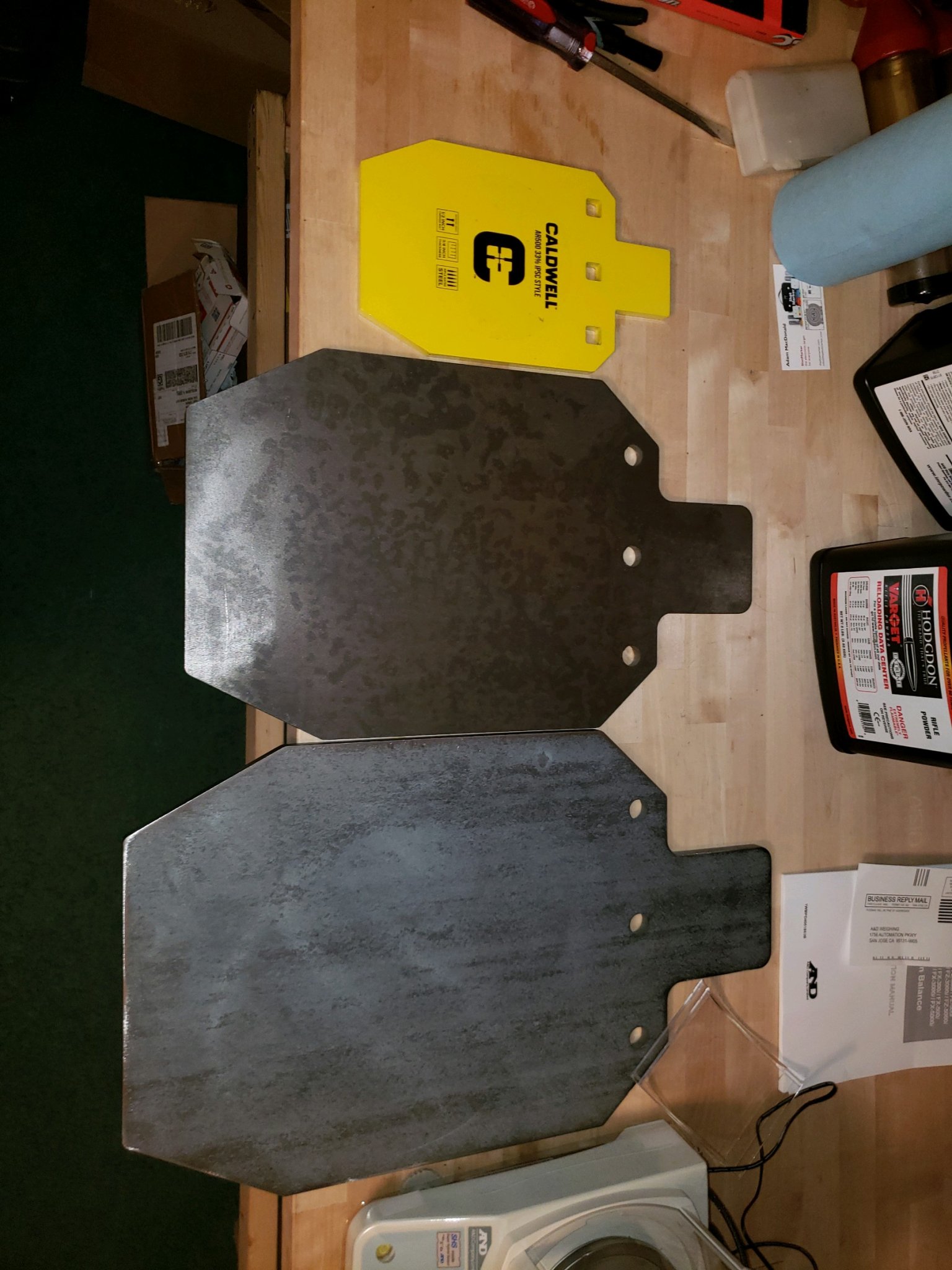

Thanks for all of the recommendations. I picked up a surplus 3/8" thick 12x20" static target package, a surplus 3/8" thick 5" plate, and a shepherds hook.
Easy

If you're referring to Bradford's people bring the post and stand types, I would try and stick with stands those posts can be a bear to get out. I built 5 20x20 bases that use a 2x4 for a post and picked up a set of targets off Amazon. They work pretty good and are fairly cheap to make. I've got enough to go every hundred yards or so, which makes it nice so you dont have to move them constantly.
Is the ground soft enought to drive in a T-post and extract it without too much difficulty? Easy peasy.
You'll need to pick up one of JC's targets with the slot, too. Best system going.
T-Posts all the way with a hanger on top. No issues with slopes or uneven ground. I shoot on farm fields so the ground is generally soft enough to get them in the ground easily. Rock them back and forth and they'll come out without much of a fight. I usually set up at least 4+ at a time, so carrying a small sledge hammer is still lighter than 4+ stands.
If you have the extra coin, go for the flasher on the distant targets.
I use two T posts driven with a post driver about 24"apart. Two pieces of 12" chain holds the steel gong in between the posts. There are some AR500 brackets on Amazon that are about $25 which connect chains to the posts. Works really well and easy to install/ set up, good movement on bullet impacts.

Floral hooks. That your wife hangs her potted plants from. They’re like 7 bucks at Home Depot. I hang 8” all the way up to 24” 3/8” gongs on them. 2 for each plate. They’re super light, and hold up surprisingly well. I’ve hit them with creedmoors, 308s, 300 winmags. and they never fall or fold over.
Reactions: LooseGoose
Five 48" x 1/2" black iron pipe lengths
Two 90° elbows.
Two T fittings.
Two black iron nipples.
Old 4" ratchet strap for hangers
3/8" hardware.
Easy assemble/disassemble and around $60.

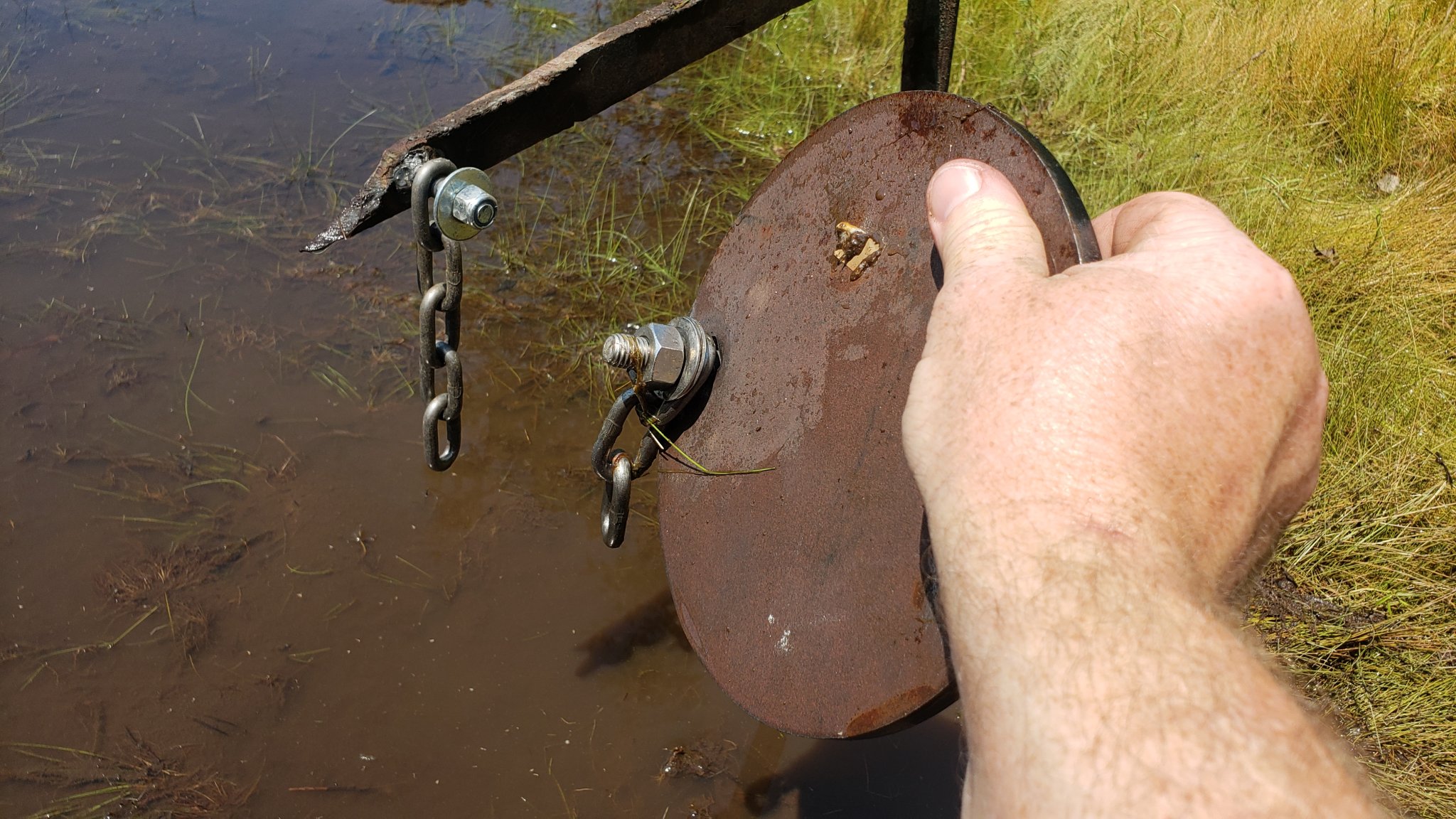

The fire hose/ heavy rubber strap seems to hold up better than chain.
So.....high tensile strenght chain became the MISSING LINK 😂🤣 Going to get rubber belting🙄
Fire hose, conveyor belt and HD straps are far better than chain
Local Agri Supply has 4"and 5" wide conveyor belt available, gonna pick some up on Monday!! Was thinking I could use a 2x4 mounted between 2 trees since it will be a semi-permanent installation to hang them from???

How are you hanging it that the frag touches it? Mine is bolted to the back and the frag doesn't touch it.
Might work on an ipsc where the "head" covers most of it but it doesn't work on a round plate. Probably more the fact that I tried it on my practice plate that gets about 100 rounds or more a week on it, some impacts are high because it's positional practice. The belts I use are hay baler belts, I have plenty I've kept throughout the years.
