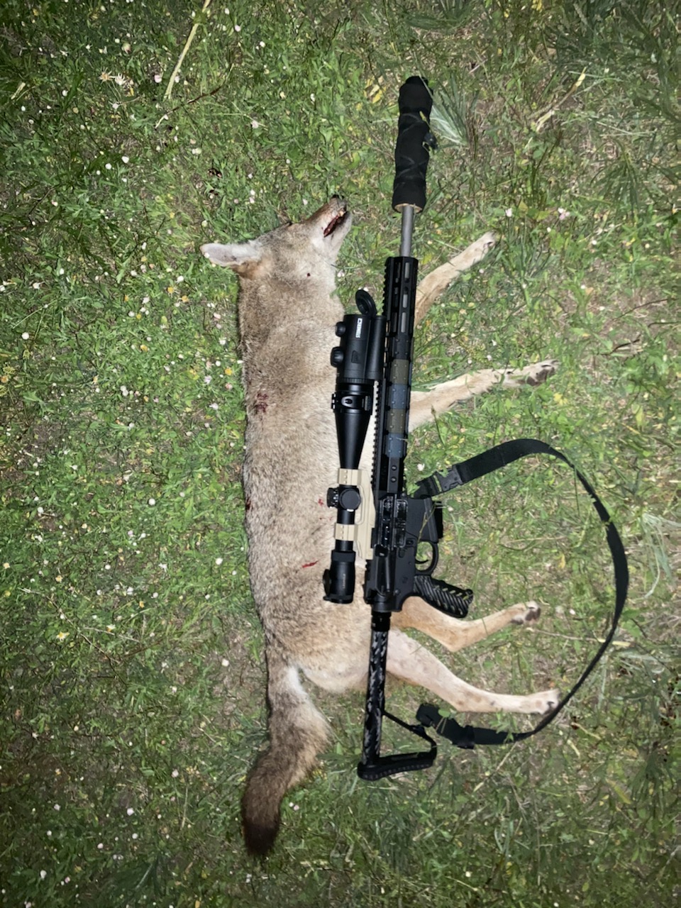

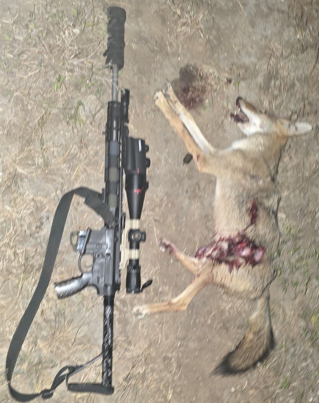

    In practice, in the field, we had a textbook coyote hunt. I'm using a 20" Grendel with Hornady 123 SSTs. Put a pig carcass from the afternoon hunt in a field, threw out a call, had two yotes come in. I told my buddy to throw out a countdown - he said he wanted me to get something with the new toy and that he would shoot on me. For the record he has one of the newer AGM 640 50mm dedicated scope type things and that is a pretty slick unit as well. I watched the coyotes work toward the carcass and was playing the with zoom. True story, I got up to 18X but was steady and was watching a 16 bit dog walk, sit down and look at me. I could make out the ears at 170 yards. I threw out a 3, 2, 1 and the coyote was DRT. My buddy had put down his gun down thinking they would carry on to the carcass and didn't get any shot as a result.

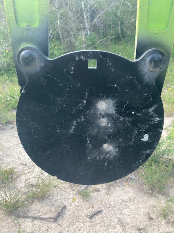

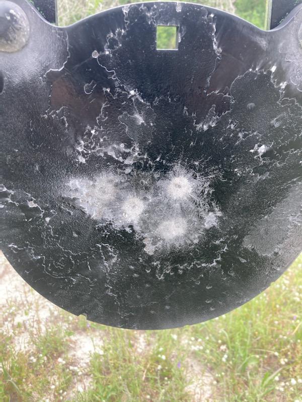

    When it comes to accuracy and return to zero - its good enough. All shots are 100 yards. I witness marked the unit and that keeps it level enough most of the time vs reticle reference. I zoomed into 18X and referenced off where the reticle fell under the letter A in the menu. If I made it a point to fuss with it and try to get very very close to the point I'd based an adjusted group from, it is MOA-ish capable across multiple remove/remount. The rifle is a sub MOA gun and makes everything involved look easy, so it had a running start. The smallest group was a series of removing and remounting 4x, shooting 2 rounds at a time at 18X with all the care. Basically the other groups represent various zoom and effort of alignment combos, but the real test is coming soon. Next range trip I'm going to shoot 50 rounds, one at a time, so 50 RTZ remounts using the external reference marks ONLY and taking what I get. I am going to note WHERE the reticle falls but I'm not going to correct. From there, I believe that I'll be able to figure out the approximate box where its 1, 2, 3, 4 MOA off based on the reference. From there I should be able to determine the ability to know I'm going to hit, say a 2x2" reasonably reliably. I'm very curious to see the results.
    Horizontal string was 1, remove, 1 remove, 1
    Called right flyer
    3, remove, 3, lower mag and only minor fussiness over reticle alignment
    2, 2, 2 with a little reference effort and 2, 2, 2,2 - every comma = remount until it was as good as I could hope for and then very careful pressss of the trigger.

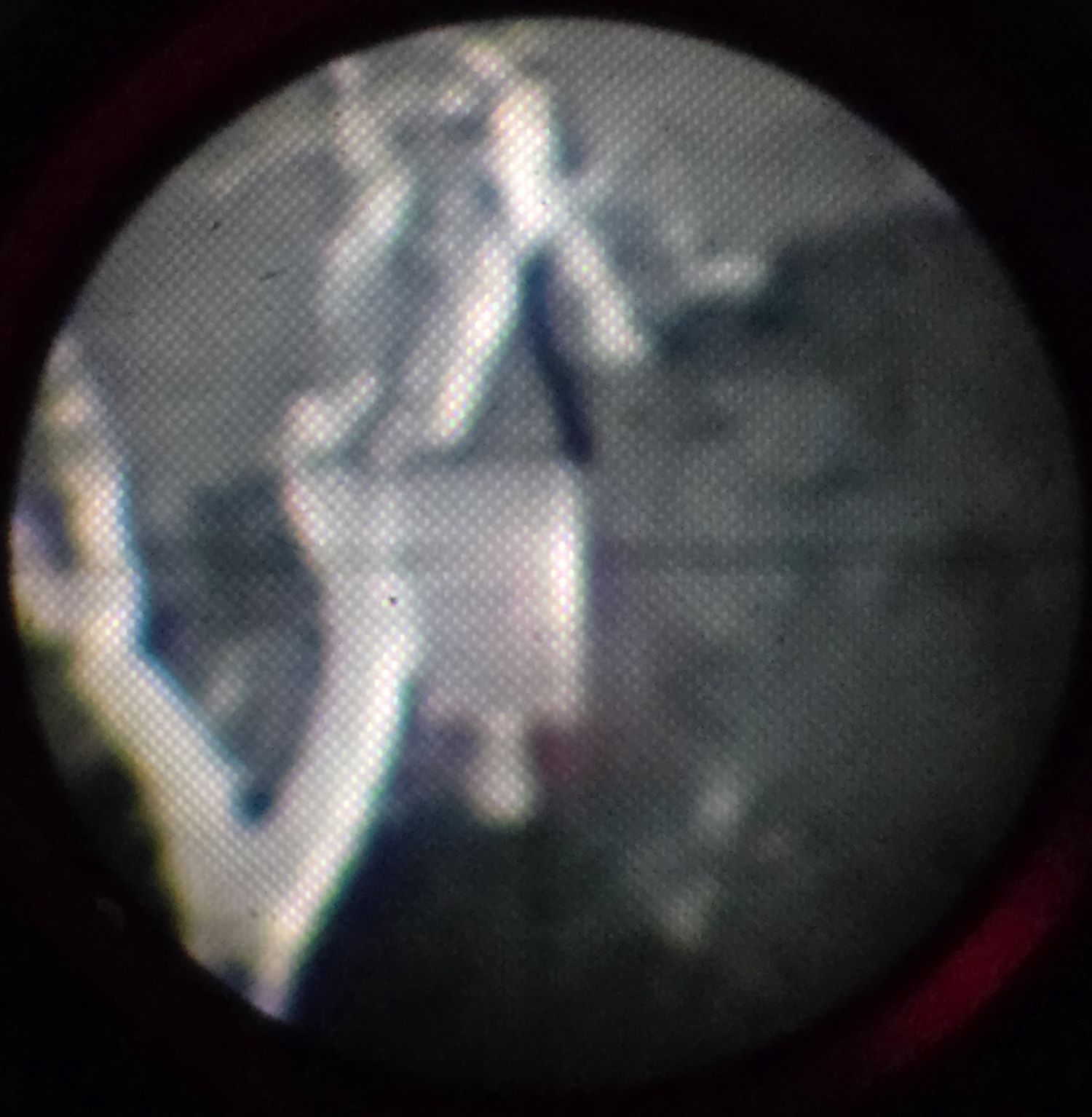

    I found and bought the Burris eyepiece adapter to see how it did as a spotter. The answer is "not great". The Burris eyepiece limits FOV and is mainly a thread protector.

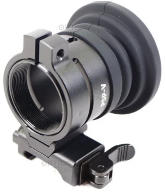

    The Pulsar PSP-V looks like it would have promise and I think non standardized thread pitches are the work of the devil in this kind of application.

    Looking at that mount, I don't see any threads in there - it appears to be a rubber insert?
    That would make me VERY nervous with the amount of meat involved. The slip on/clamp on has a lot of purchase on the bell but it is still in the back of my head that gravity can and will win in time.
    At the end of this rainbow, surely we can get a mount that is metal/metal with some sort of interface for locking in as opposed to clamping and hoping.

    That's not correct!
    When you look at the detailed photos, you can see the aluminum ring that has threads on its internal surface.
    The way the mount works is that you thread your device into this ring. The ring has a spherical surface on its outer diameter, allowing you to adjust the angle of the thermal device until it matches your scope. Then you tighten the clamp around the threaded ring, locking the assembly into place.

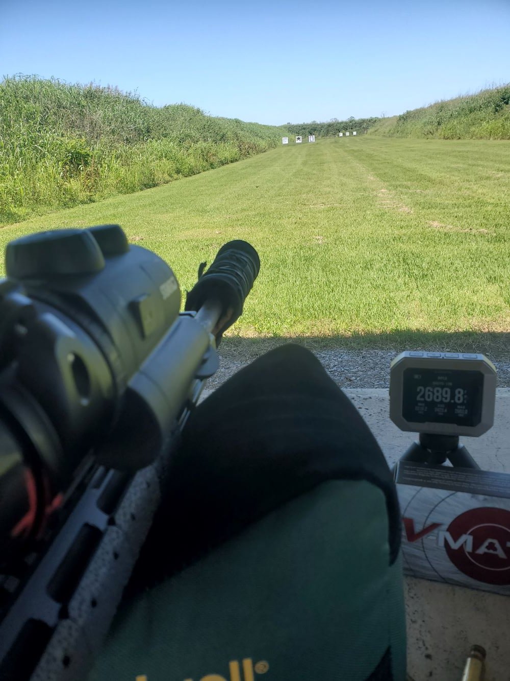

    Had a great range trip today. I didn't do extensive testing with the thermal, just some zero verification and then was working back to 500 with the rifle/scope combo that this thermal forced. That has worked out very well in that I didn't realize my VX-6 and Grendel were meant to be, but the reticle lines up *perfectly* back to 500 yards in practice so on some level I have to thank them.

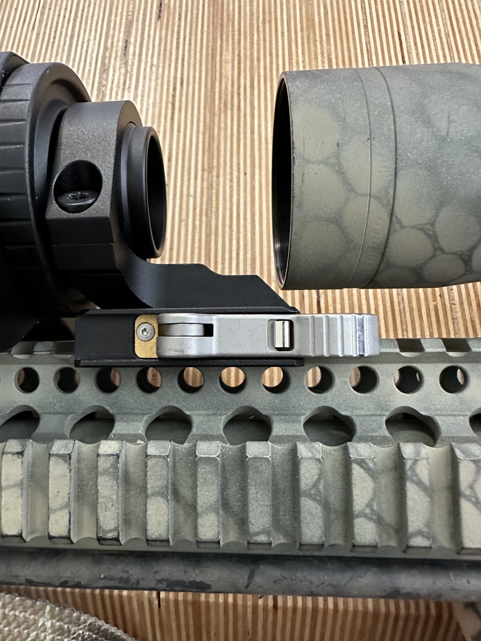

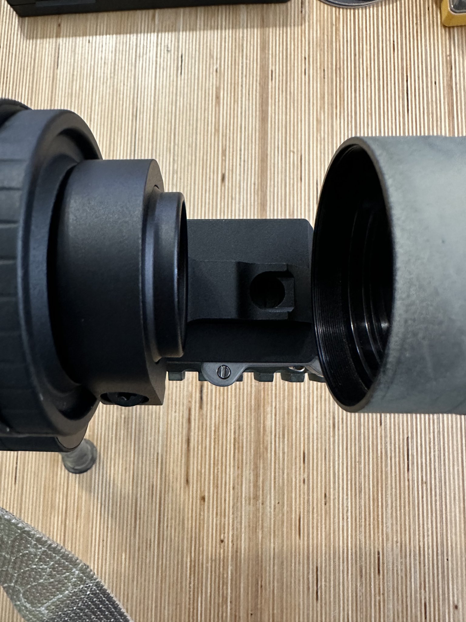

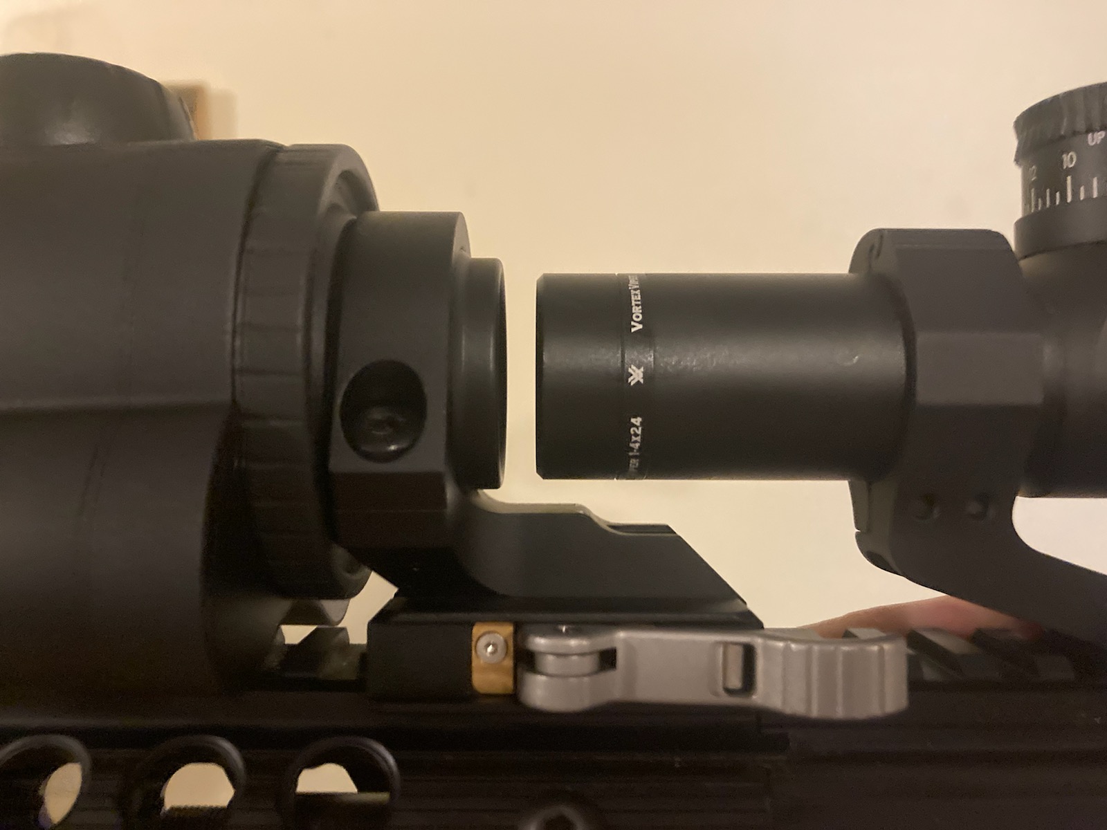

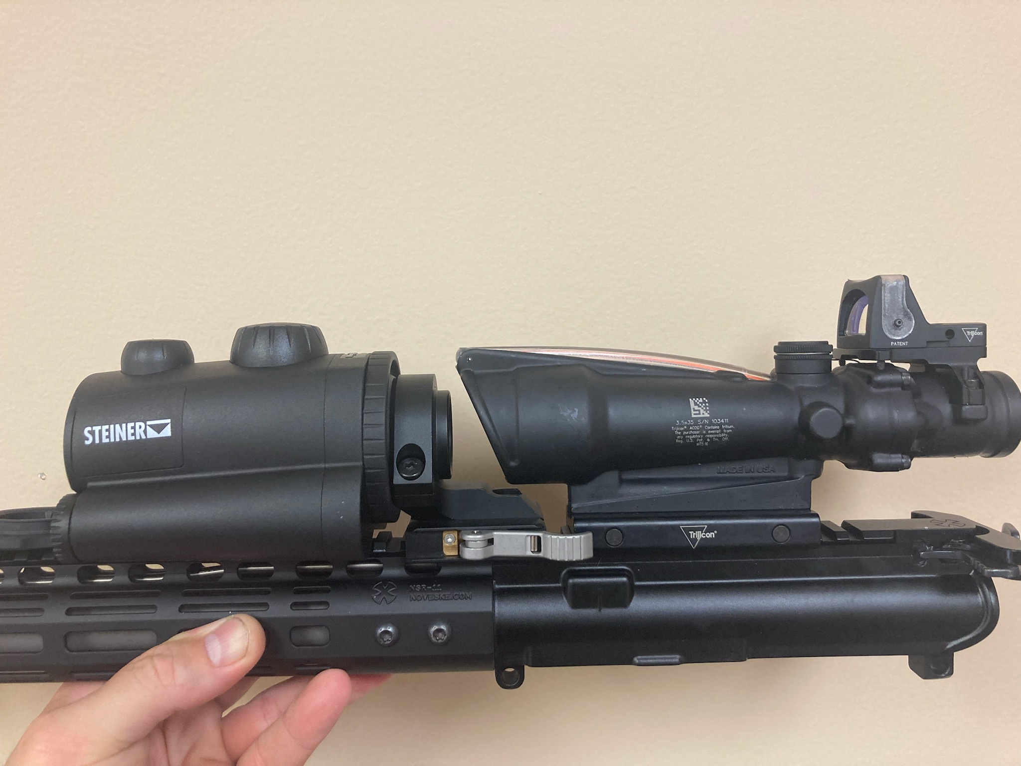

    I got the 30mm ring in and it can't be indexed.
    Steiner is sending me another one of the knurled rings for the back of the unit to give the depth necessary, and it should be able to be flipped to give some chance at indexing but :unsure::unsure::unsure: as to the thought process.
    Reactions: TrashPanda1776
    So what you're saying is it would fit under a 30/34/ACOG without modification....
    Those are my primary optics I'm trying to use at night - I can live with the slip on crap for the 50mm objective should it be time for that system.
    1.5"?
    Three cheers for Trash Panda. Wish I could get back another little bit on the ACOG but there are plenty of options that will work fine.
    For the money, it is still a great deal. While it has fleas, they all have fleas, and the screen resolution allows for use of 10X+if you have a good stable platform and aren't in a rush - but I think that usually applies to 10X magnification anyway.

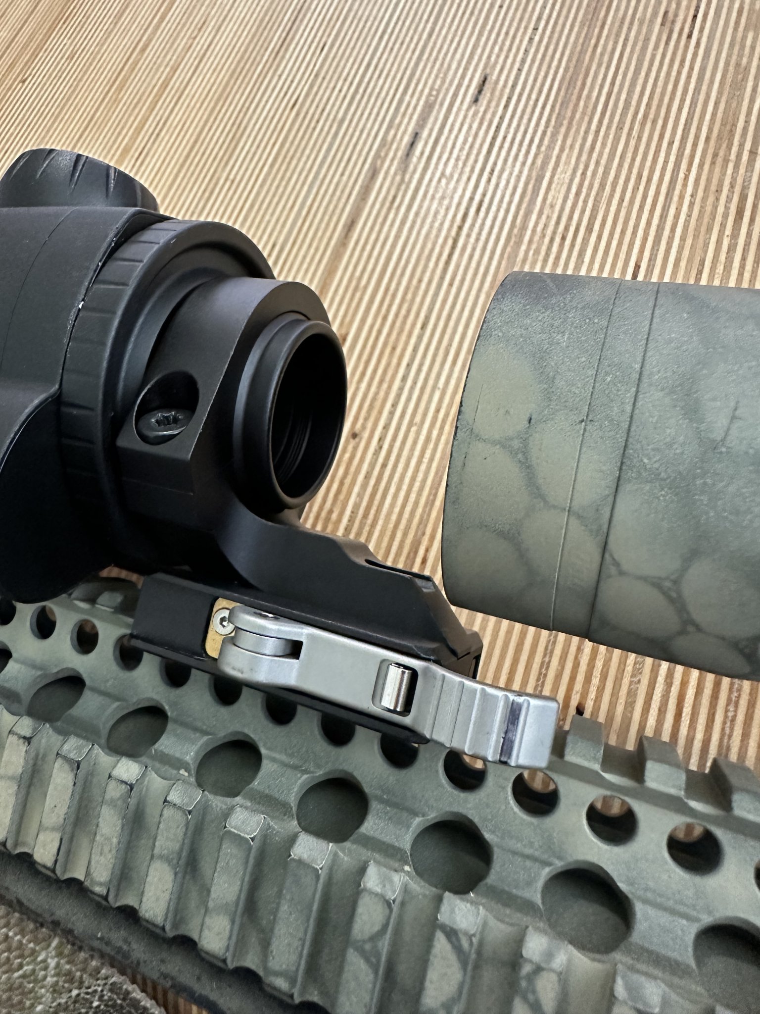

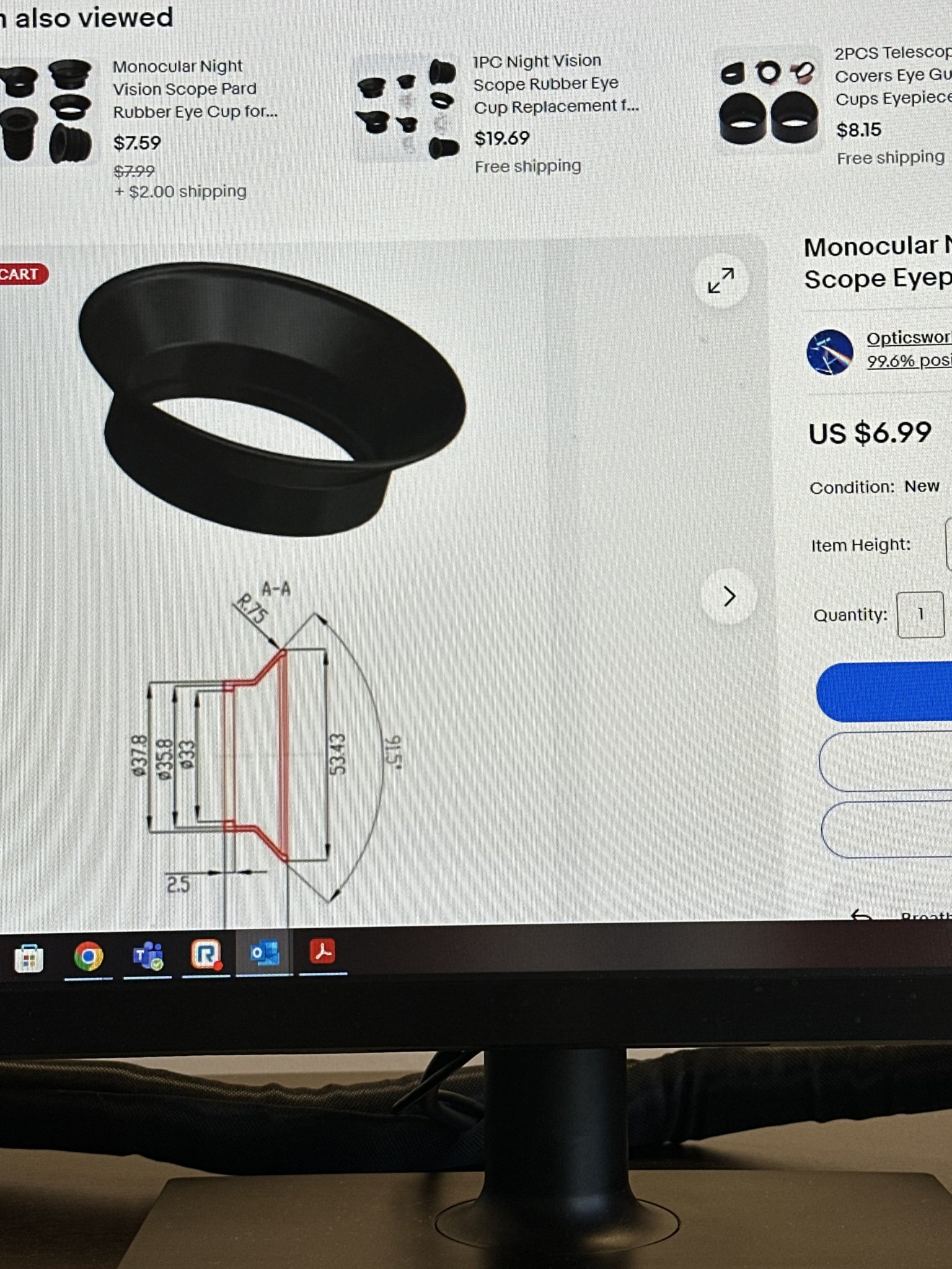

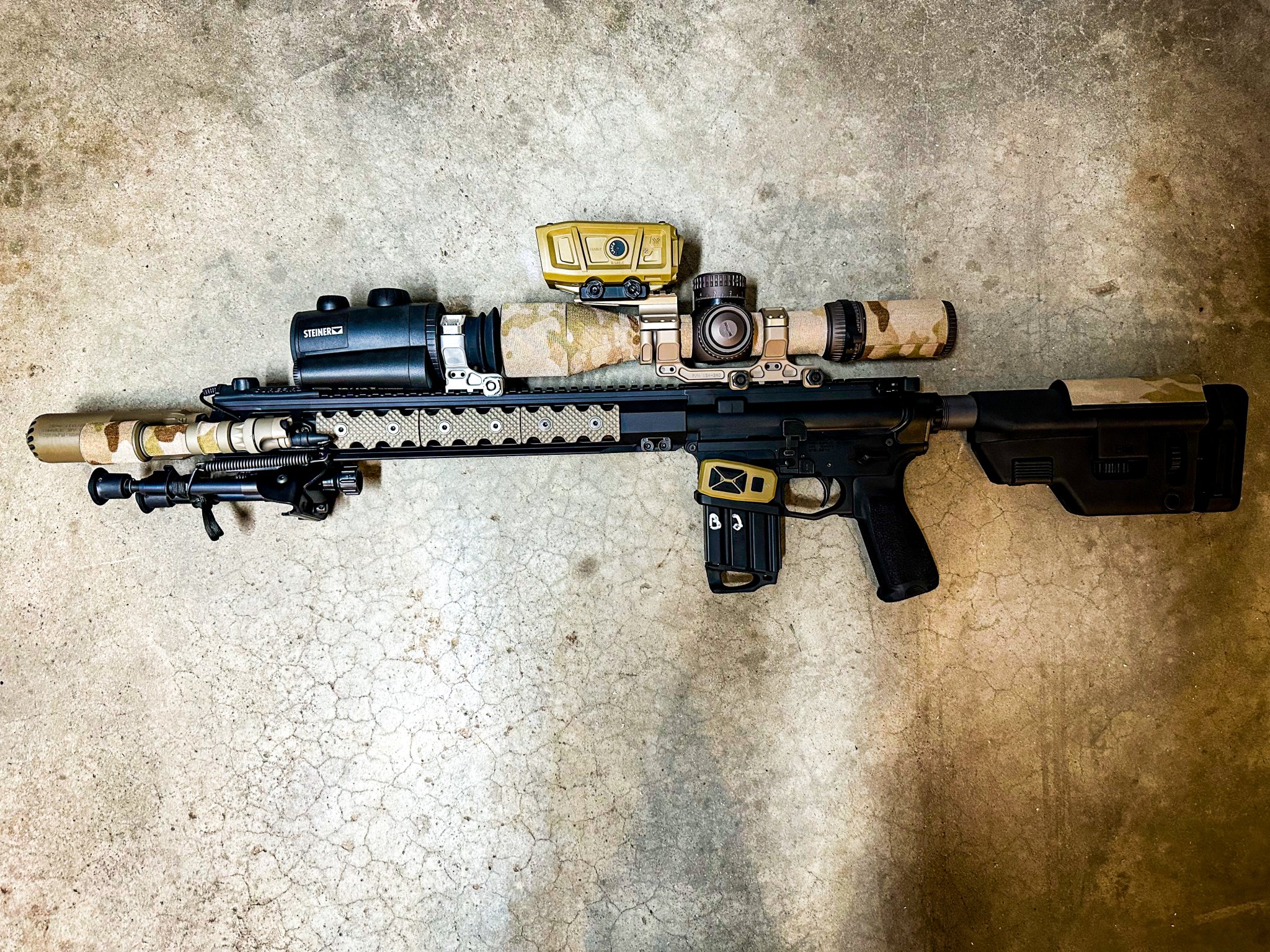

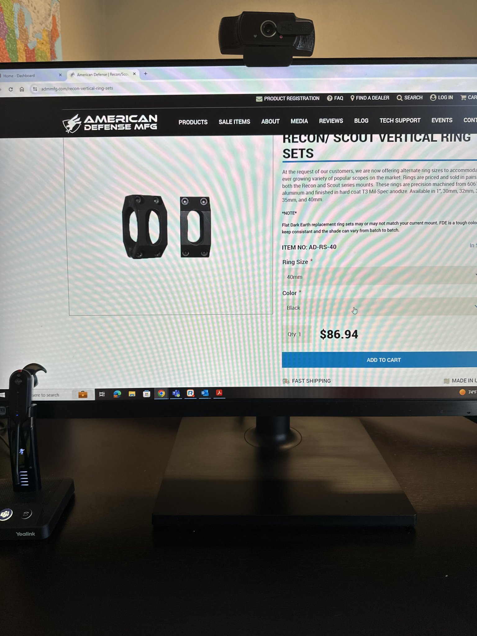

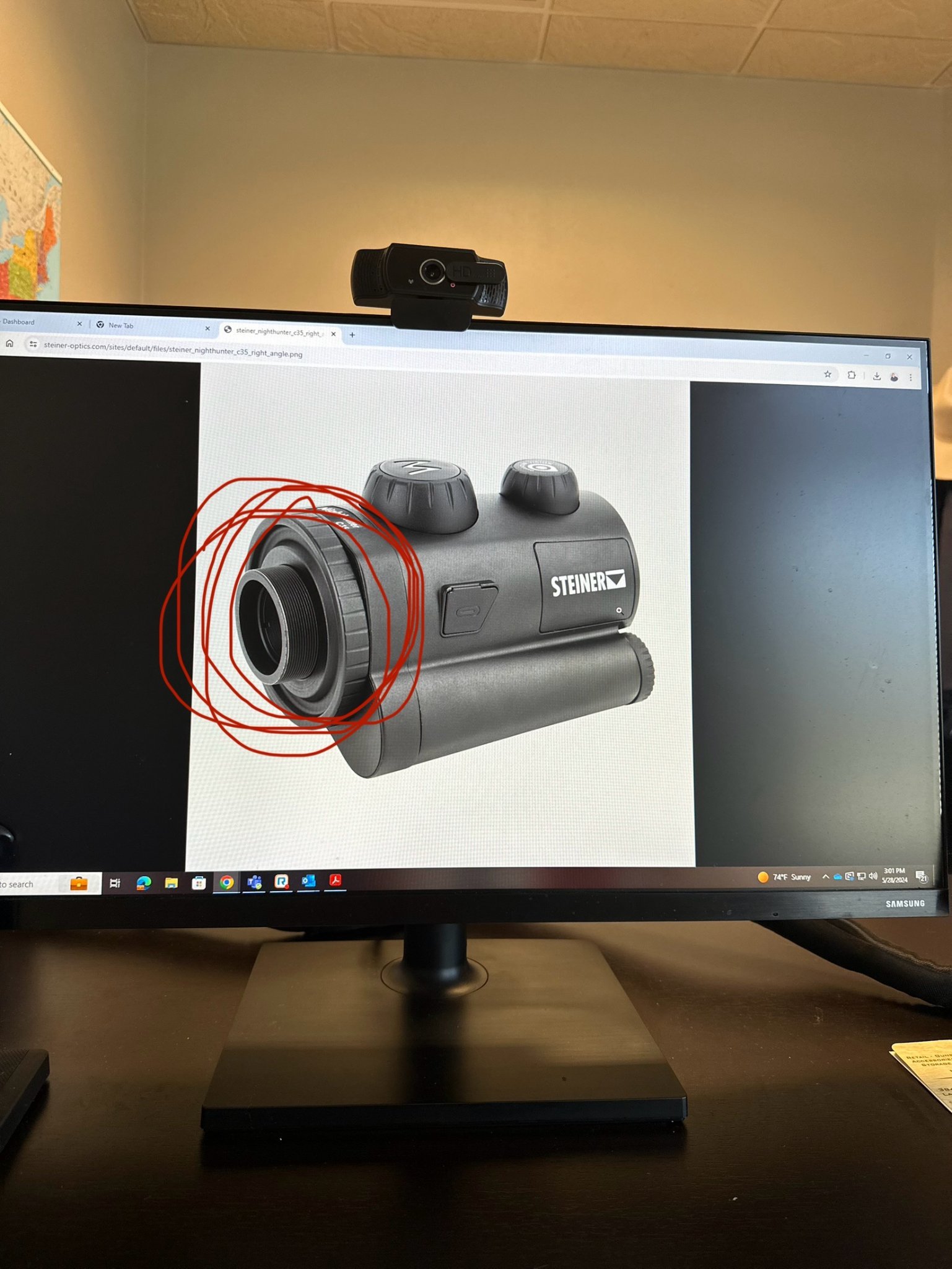

    Fellas, I found a solution that I hope will work. The plan is to spin an adapter (40mm outer diameter) that will thread into the 33.5x.75m part of the c35. This adapter will be cut roughly 2 inches long. The plan is then to use an adm aimpoint mount with upgraded 40mm recon ring to secure it to the rifle. With a lower 1/3 adm mount, this should sit level with a badger 1.70 c1.

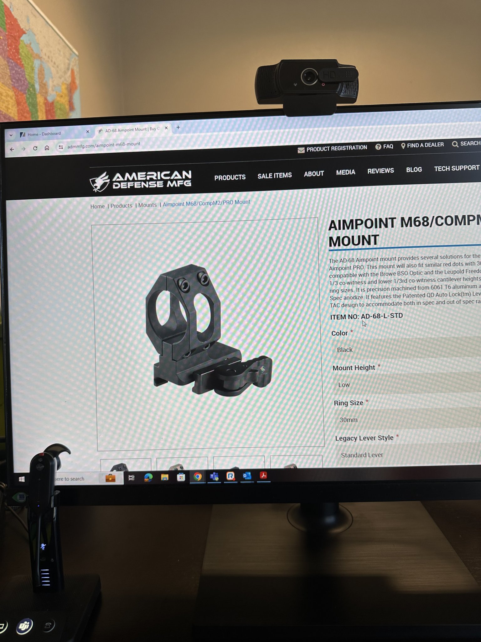

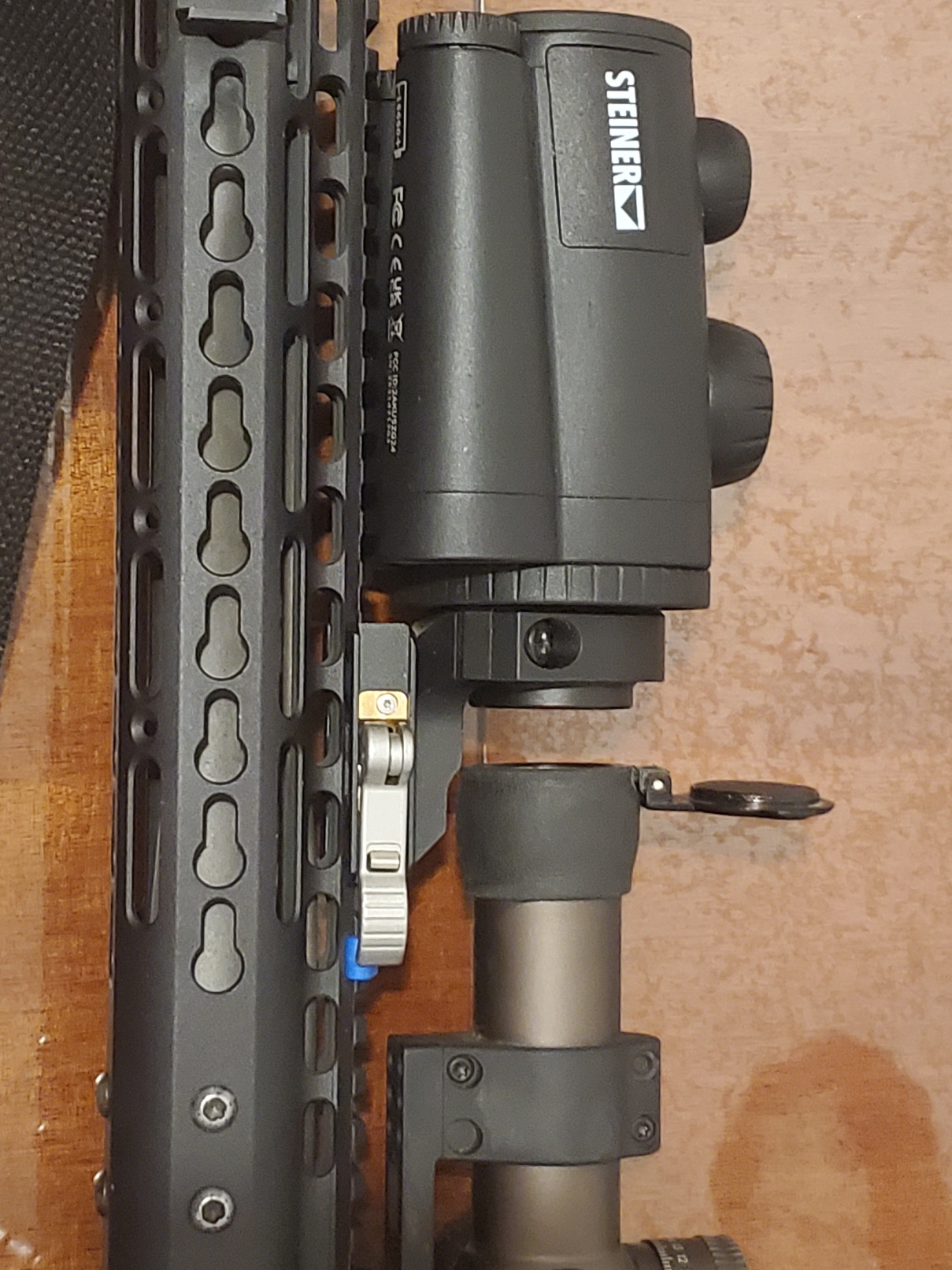

    Frustration with the rail mount situation. I'm looking at getting the mount milled a little flatter so that it can fit under a couple other scopes and hopefully to allow a second bolt to secure it - currently it only uses one due to being flipped.
    My last planned trip got cancelled due to work but I've got one coming up soon. I will likely put at least another 10-12 hours on it and will have more academic and practical feedback at that point.

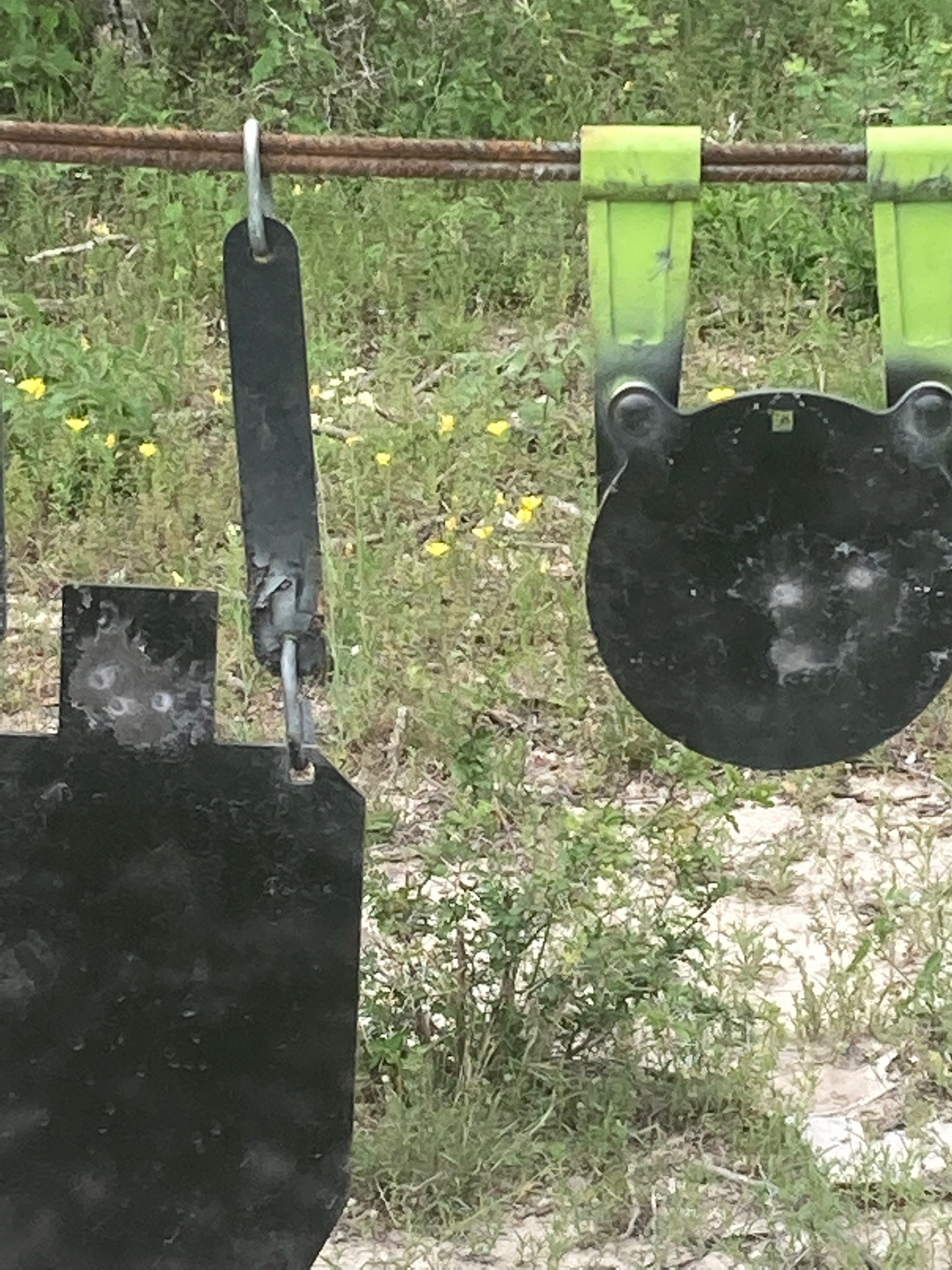

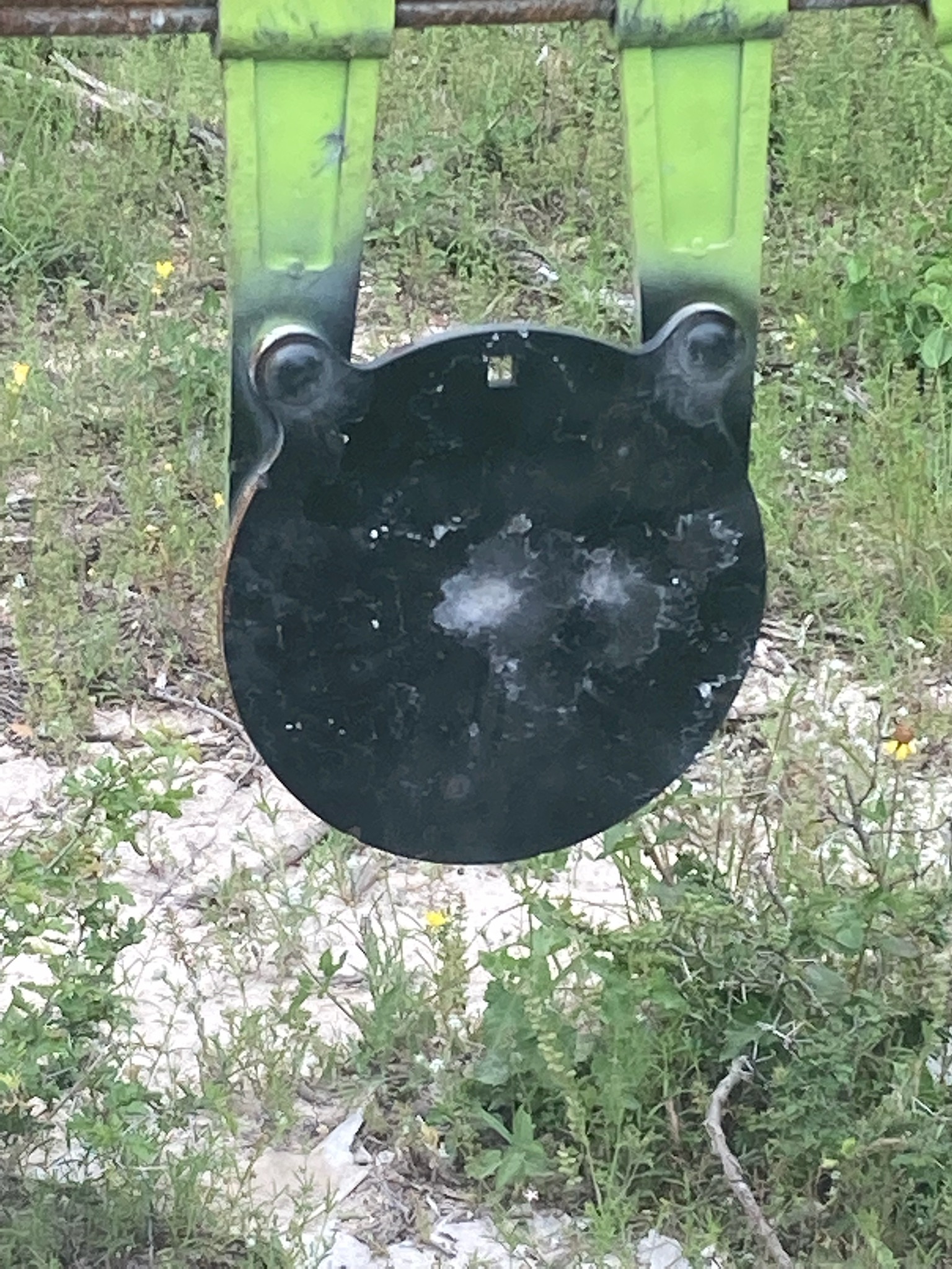

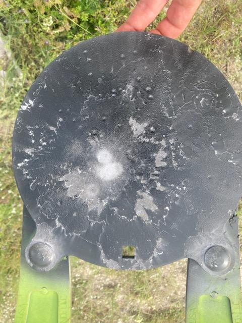

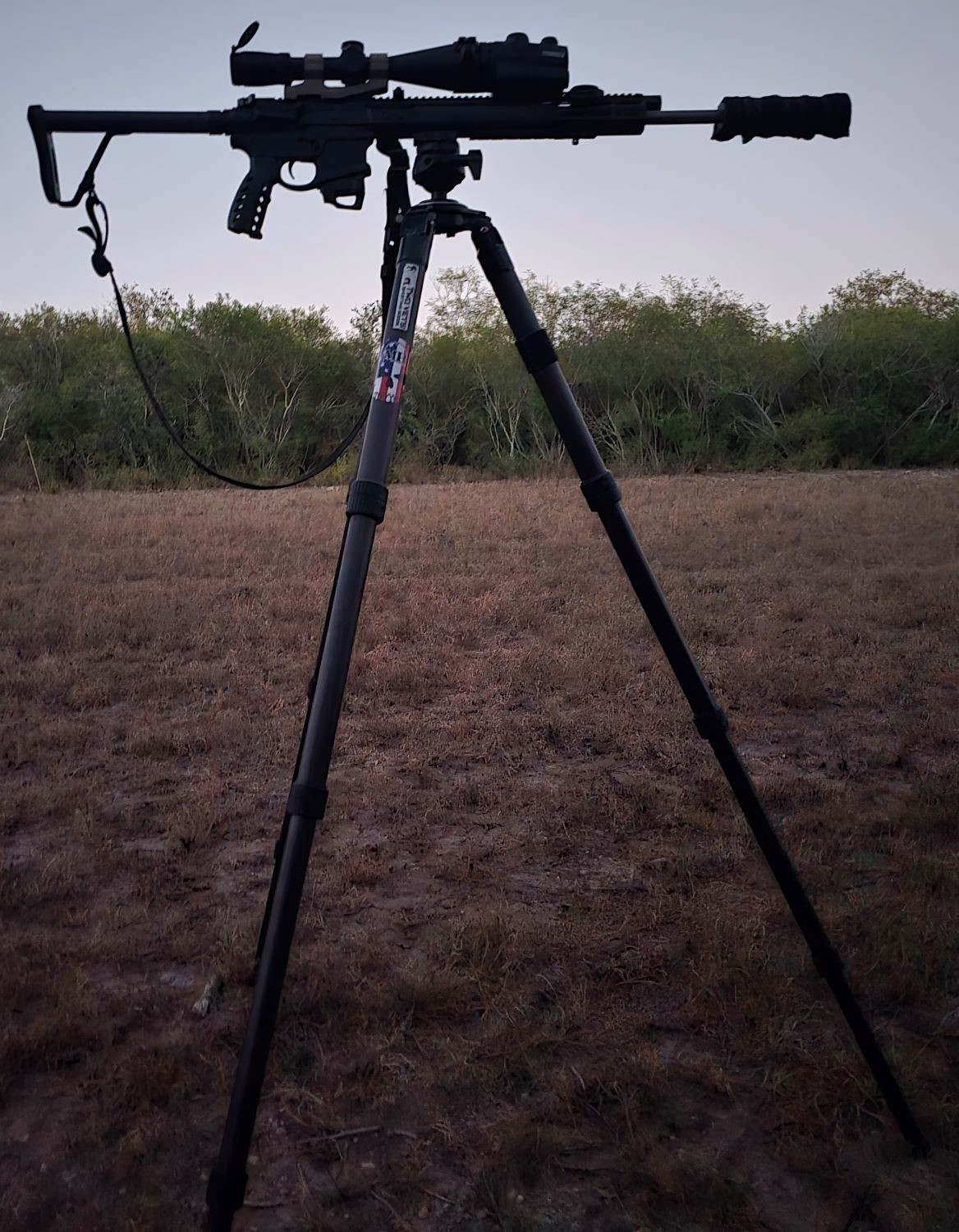

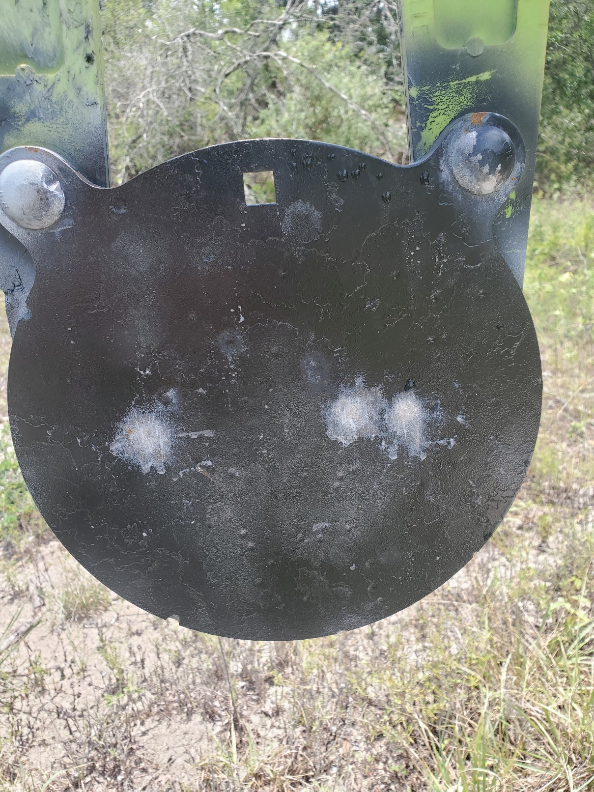

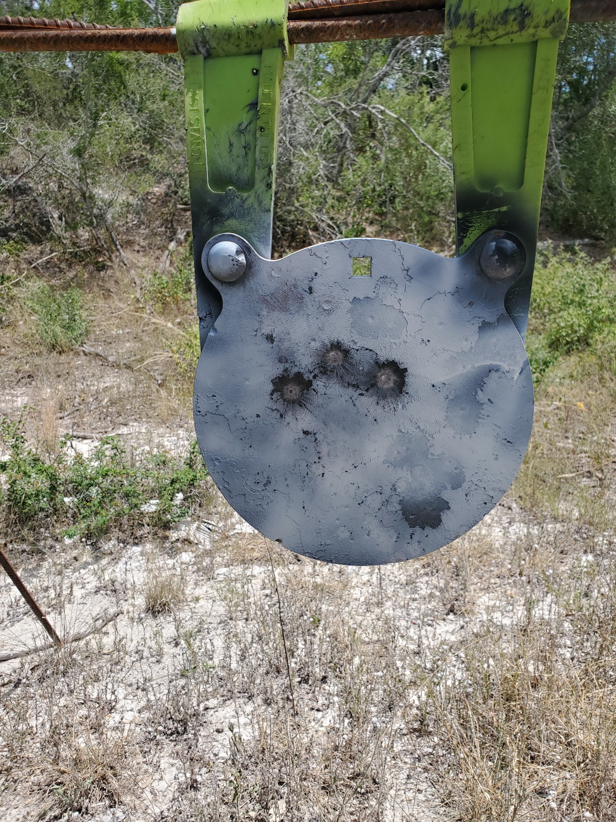

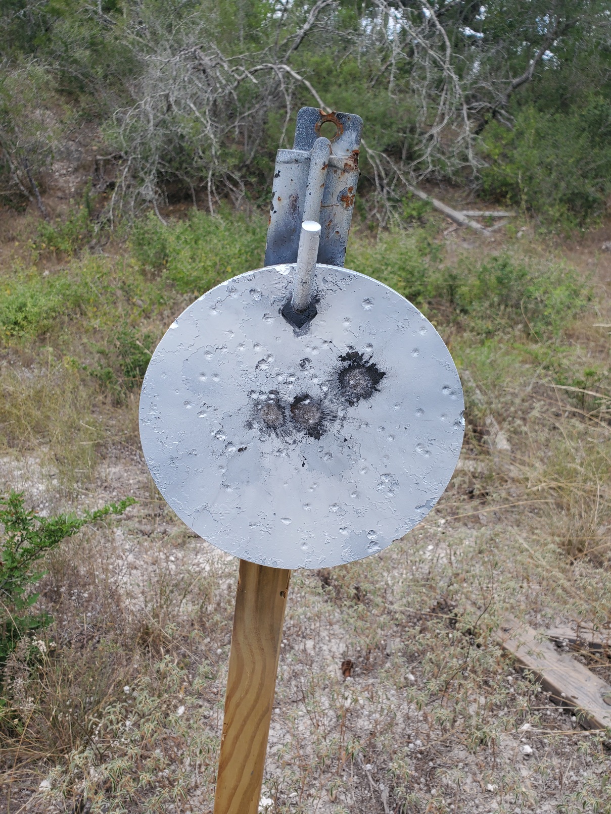

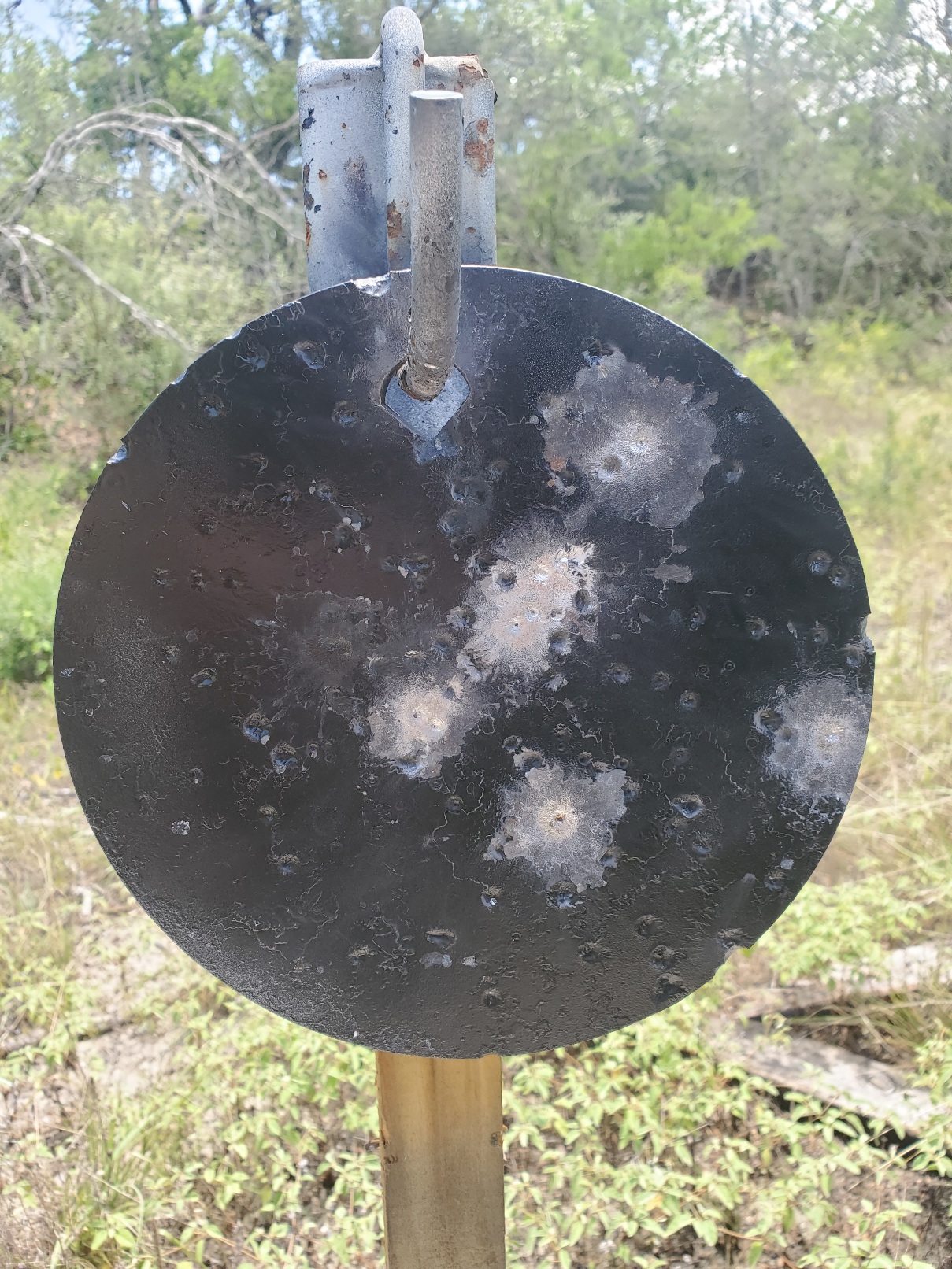

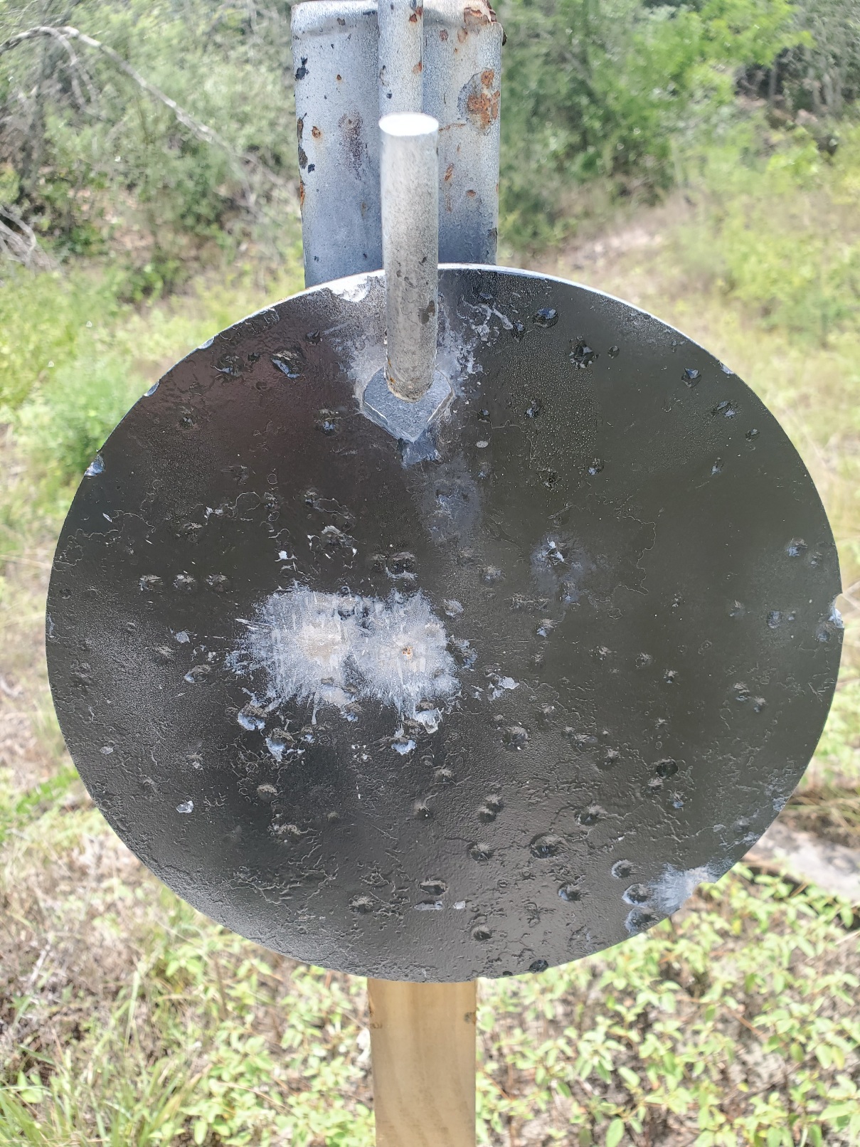

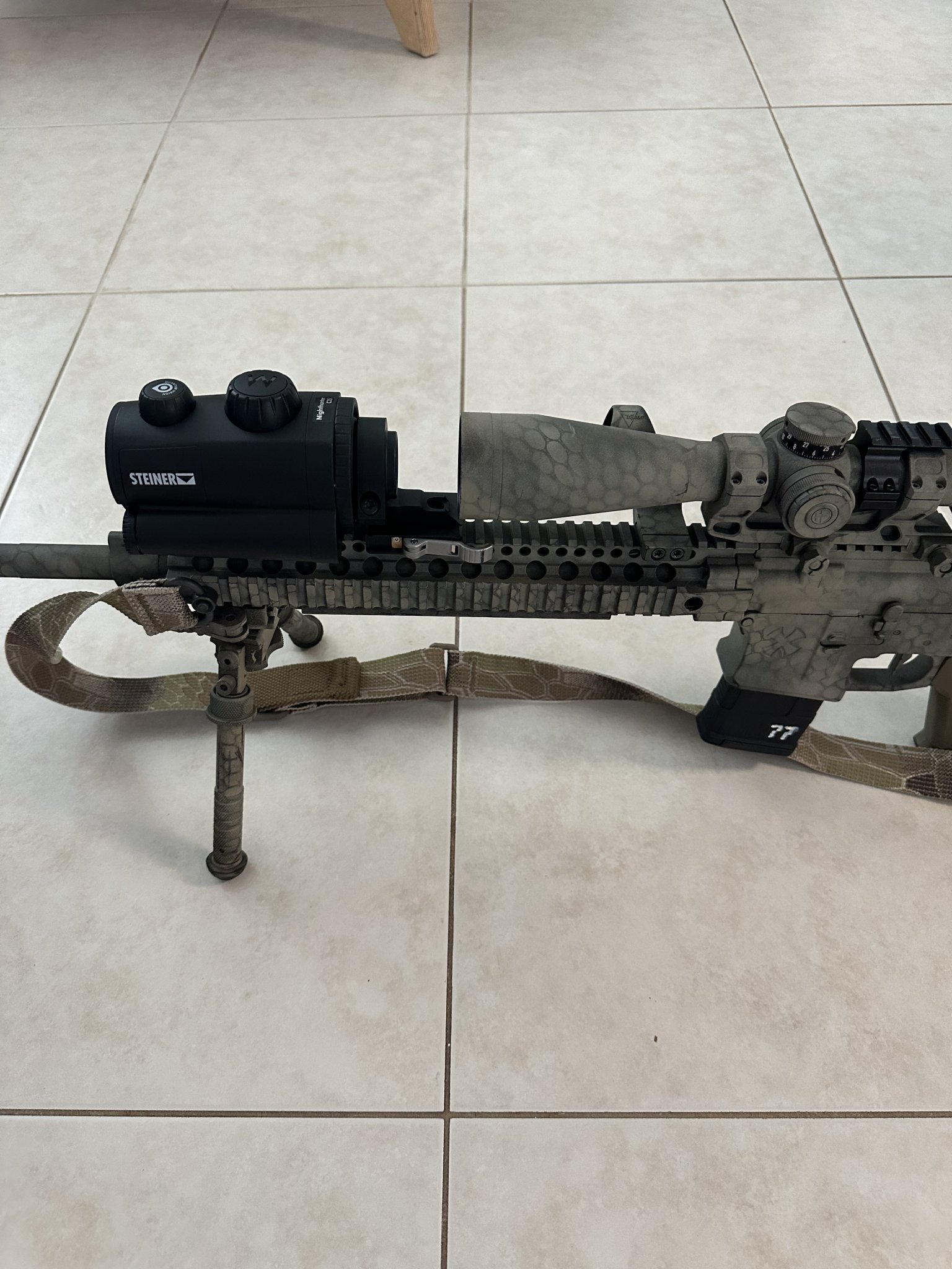

    TLDR - The Burris Clip on adapter can be made to work and is in practice, in the field, minute of pig repeatable. Detailed RTZ testing later.
    So, the universe works in mysterious ways and I ended up with a NOX35 that put the Steiner onto my oldest son's rifle. He's shooting a 556 with the OG 1-4 Razor, which is a great match up.
    All these groups are fired from a not tactical tripod, i.e. less than $100 and just has a valley to rest in, not a multi thousand dollar hydroball clamped in situation, all shot at 90 yards.
    We've checked it across the three days we weren't setting rained out on steel by going off/on/off/on, firing three rounds on each gong for each iteration. Day three I needed a clean gong to verify something else so we have six shots on one, but it went off and on in between and produced two groups where I could see the shift, but predictably so. In practice, they have seen two pigs and killed two pigs this trip - we've been hampered by that tropical storm a bit, but have eaten our way through it and managed a couple pigs, a coyote, and some quality time nonetheless.
    So - takeaway is I'd like to thin out the top of the mount so that it slides under a 30mm scope a little more easily, but I suspect on a concrete bench and bag situation we're gonna find a 1.5" rifle can reliably produce say 4" groups clipped off and on. Not perfect, but what is - in practice, this beats humping a second rifle out there and is for sure minute of pig.
    Hanging gong is 9", post gong is 6".

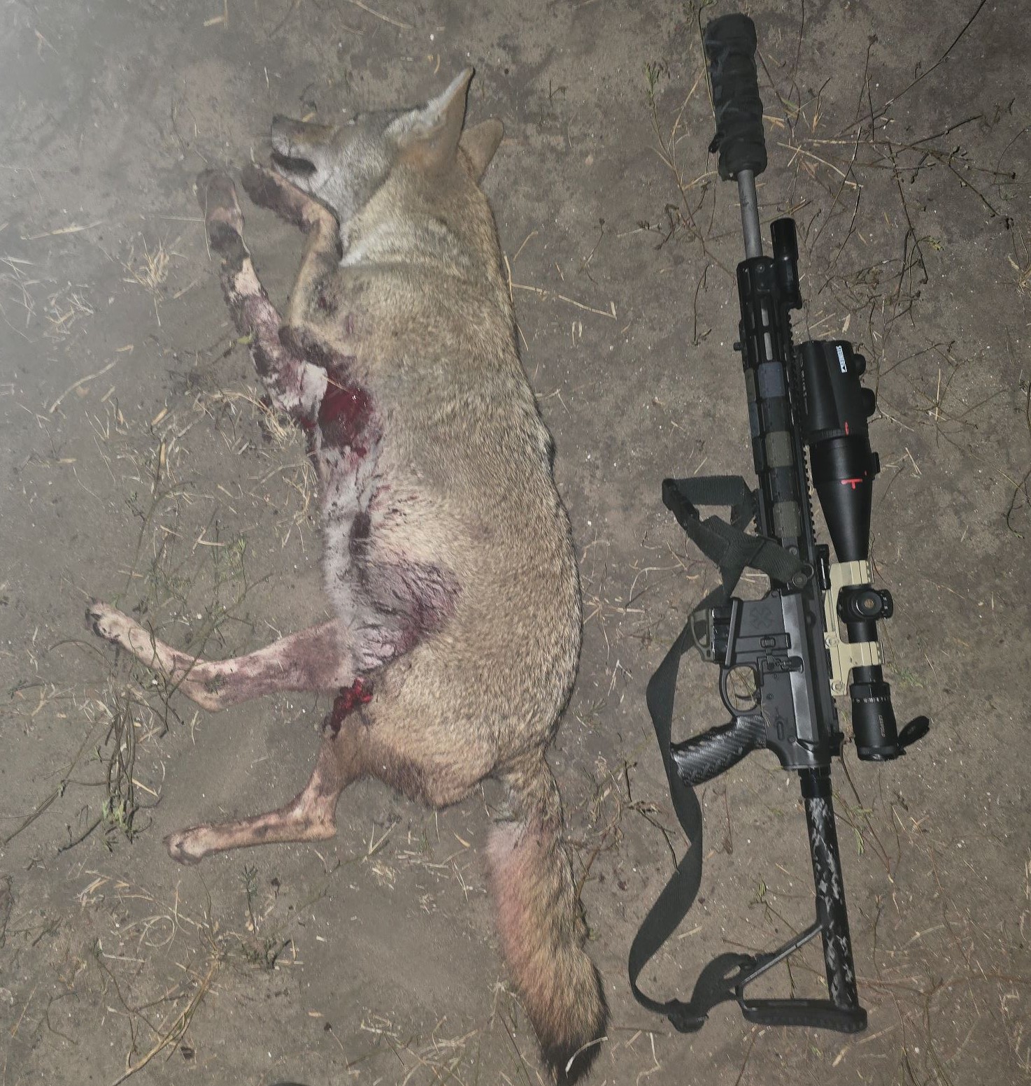

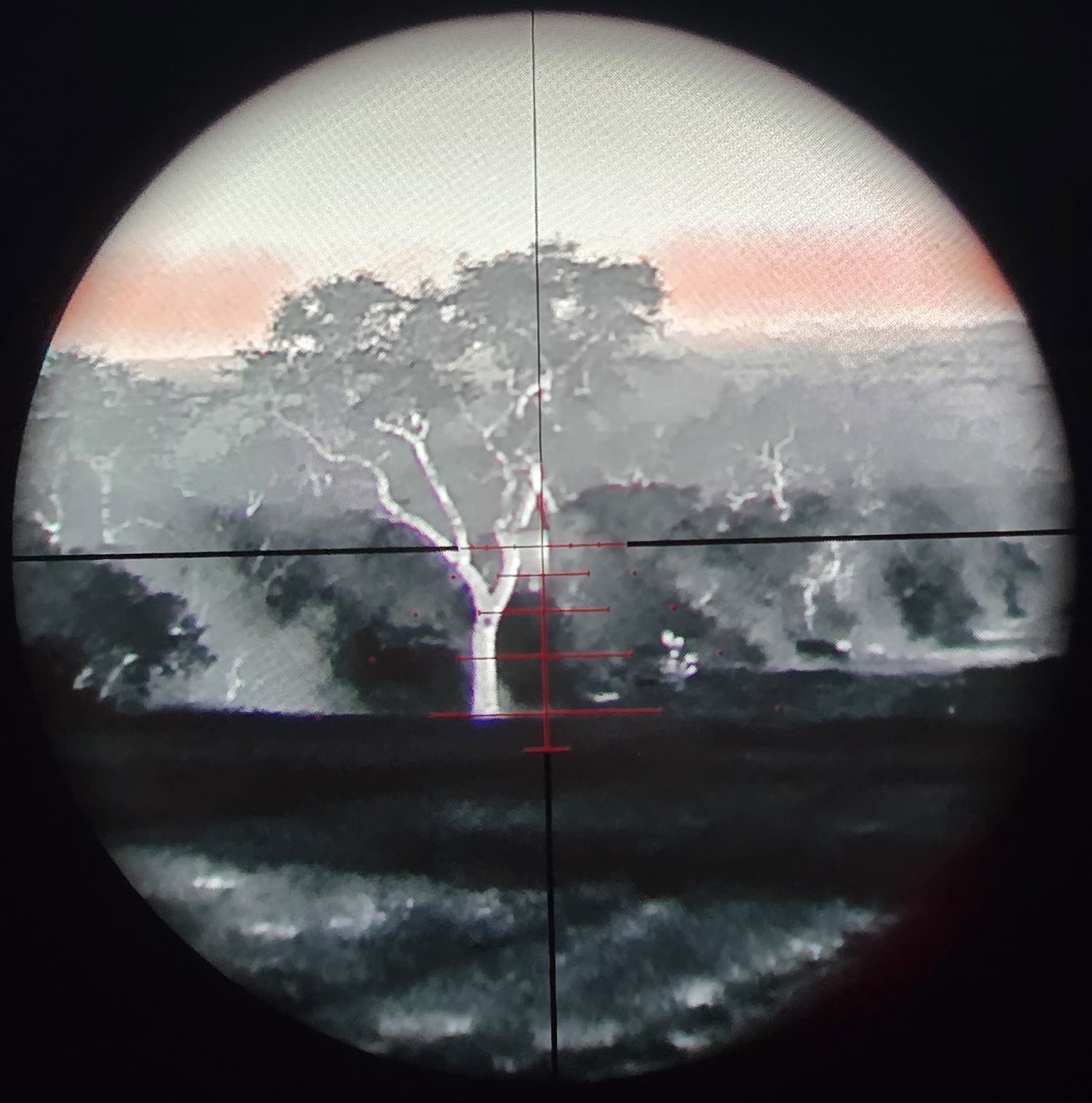

    Steiner really impressed this trip. I got the bigger coyote at 305 yards. Images are through a Leupold VX6 HD 3x18 at 3X and 18X.
    The pics with my son and an NOX 35 are pigs that were hit with on a countdown and a let him have all photo credit, but the smaller one specifically I'm pretty sure was all me ;)
    Steiner notes - I zero'd it before the hunt and left the unit on the gun as our cameras showed all activity at night. I verified zero on site with minimal adjustment. The fucking site got turned on in a case (?) as it went in with full batteries and 10 hours later was dead as a doornail, but it never displayed any issues the rest of the trip so I'm contemplating how to make sure the on button is shielded in the future.
    Without any on/off zero shift drama, I have to say I was very, very happy with the performance.
