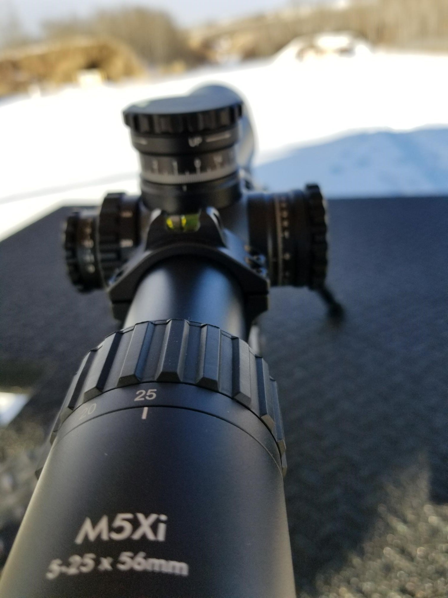

While out adjusting my zero I lifted the elevation turret cap off the base and I was unable to use the full range of the elevation adjustment. Is their any advice on how to correctly reseat the cap to regain full adjustment. I have read the Steiner optics manual and it isn't clear on how to troubleshot any issues with the optic. If possible any advice or ideas on how to bring it back to the factory zero position would be helpful.
Sorry for the slow response. I found out that the elevation turret cap has three possible positions but only one of them will give you full elevation adjustment range. The tech support from Steiner was quick almost no waiting time and the tech stayed on the phone with me for a few minutes while I made the adjustment to the scope to confirm it was back to normal.
here was my 100 meter group and cold bore shoot today in -2 Celsius
