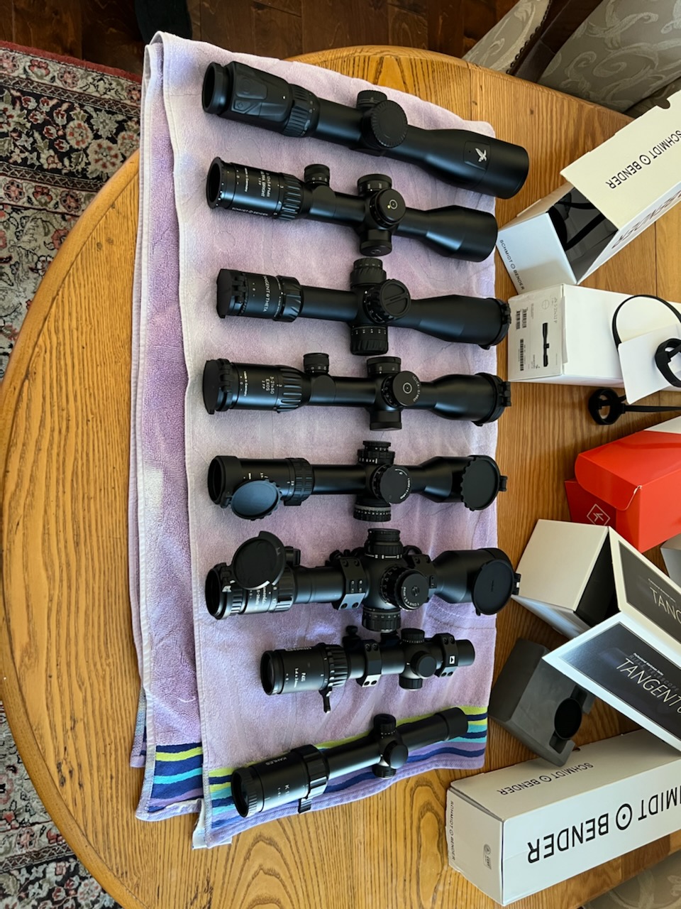

I have owned a lot of scopes, had three different people blind test all of these scopes and they all agreed steiner is the best (including Hensoldt and TT). Also the warranty is killer. But everyone's eyes see scopes and light differently so I'd highly recommend looking through it yourself, you may prefer some thing else. It's all about what you like, don't listen to what other people like.

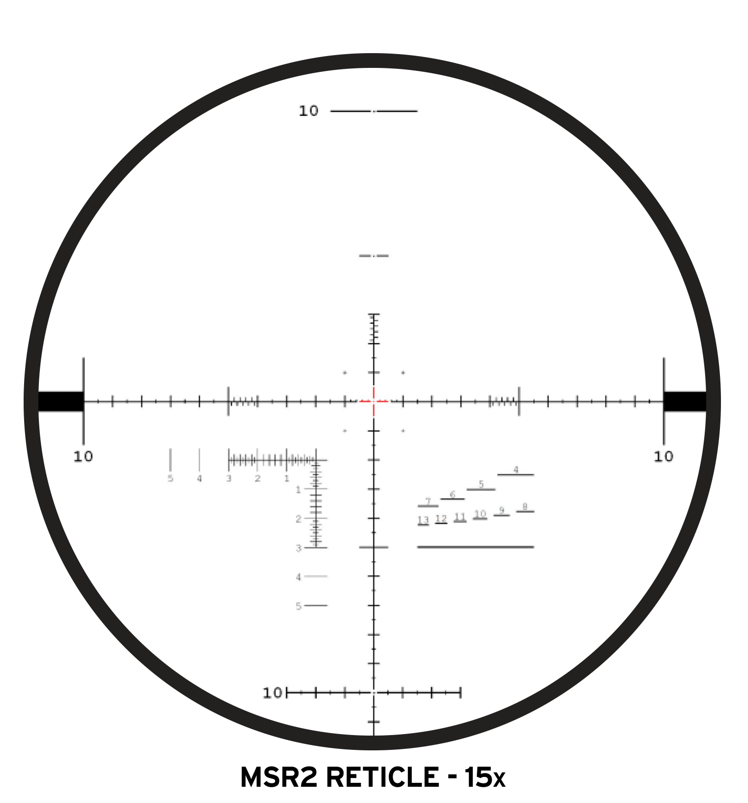

The only thing still giving me doubts is the MSR2 reticle. It looks a bit busy. Last scope I bought, it was a Christmas tree and I decided that overall I like a clean reticle with only graduated crosshairs. Less clutter, easier to see bullet splash and bullet trace. I don't know what the heck I'd use the thing in the bottom left quadrant for.
https://www.steiner-optics.com/sites/default/files/msr2_reticle_15x-web.png
The MSR2 has slowly become my favorite reticle.
It looks clean when focusing on your target, and I've absolutely used that little thing in the left low quadrant to measure targets, measure corrections, etc...
