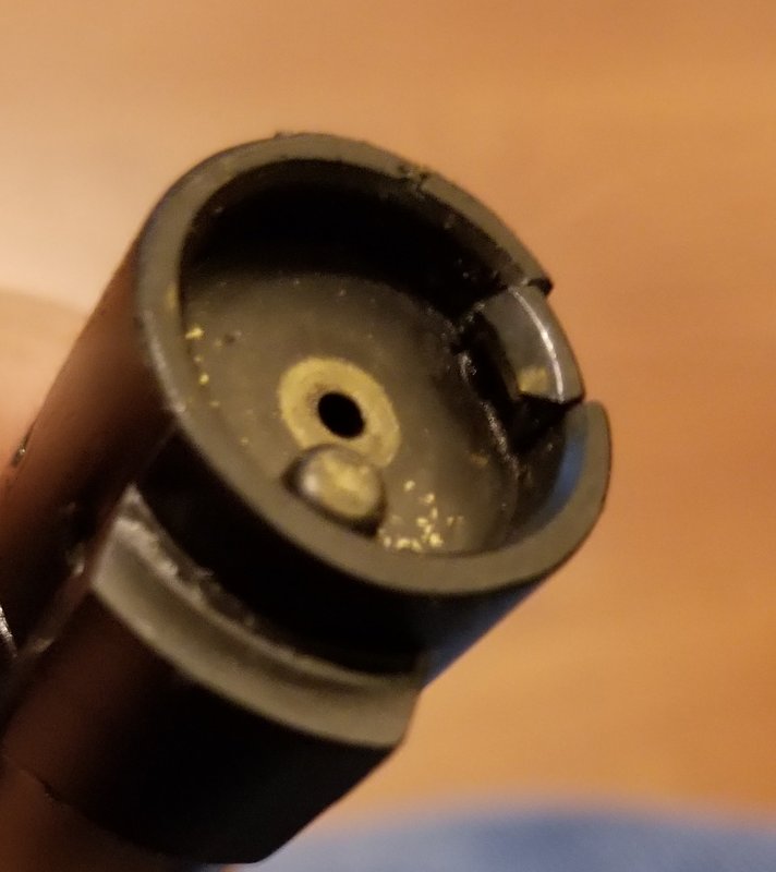

Okay so I did a little more investigating last night with some empty pieces of fire formed federal brass. I'm not entirely sure but it seems like I'm having multiple issues during ejection.
For background, this is a left hand Stiller Tac30 with a 223 bolt face and Sako extractor and its sitting in a McMillan stock. If I run the bolt fast, the brass sometimes contacts the parallax turret of my Bushnell DMR2. It is the non-illuminated model and the parallax turret isn't that big so this seems pretty annoying to me. I can't imagine moving my scope forward or backwards at all to eliminate this issue; my eye relief is set up perfectly.
On the other hand, when I pull the bolt rearward slowly, there's an intermittent chance that the ejector just leaves the case in the receiver. Every once in a while the ejection seems perfect and the case is flung out of of the receiver and spins end over end (like a proper plunger-ejector should function). Sometimes, even when the ejector manages to get it out of the receiver it seems like weak ejection and doesn't flip end over end like I would expect. So it seems like sometimes ejection is proper, sometimes ejection is weak, sometimes ejection causes the brass to hit the parallax turret, and sometimes ejection just leaves the cases in the receiver.
I'm not even sure where to begin. I did use the wooden dowel end of a Q-tip to work the ejector in and out a bunch, and some brass chips were freeing up in doing so. It didn't seem to have much of an effect on the ejection issues. I'm going to contact Stiller and see if they can offer any help. I am tempted to just buy a new Sako extractor and a new ejector plunger/spring and replace both to see if it helps at all. Can anyone confirm that the ejector is just the standard Remington 700 ejector and spring shown in the links below?

From a little research I can see that issue is not new and a few people have had to modify their extractor's slightly to allow a lower ejection angle. I'm really not 100% sold that this is my only issue as I'm almost positive there are occurrences where the brass is NOT hitting the turret but is still ejecting improperly (either by just laying in the ejection port, or by ejecting weakly). I'll wait to hear back from Stiller and hopefully they will take care of me.
Well, I feel pretty stupid but tonight after work I decided to remove my scope and mess around with extracting/ejecting a piece of empty brass. With my scope removed, I couldn't replicate any of the poor ejection issues that I mention in the above posts. Talk about a poor ejection angle... hits the parallax turret of DMR2. I am going to call Stiller tomorrow and hopefully I can send my bolt to out to have them modify the extractor to fix the ejection angle. Or it looks like I could probably grind a bit off the corner of the extractor to reduce the angle like some others have done.
grinding some the top is pretty common on Sakos. In Iraq, buddy took a hack saw to his one piece base for the same shit. (M700LA, Sako extractor installed by Crane). It's a simple process to gently file and polish the corner, but it takes time removing and re-installing the extractor.
You said working it slow had it grabbed. This should have nothing to do with the scope. Are you raising any burrs on the case rim? If so it's probably just a little tight. You can polish the extractor groove with a cratex bit in a Dremel (slowly and carefully) and if that doesn't fix it maybe use a small flat file to open the extractor groove (Barrel side, not bolt side) a few thou a re-polish.
Edit: I posted a pic of my Stiller mk13 M16 style extractor below. Not 100% apples to apples but this gives you an idea of what I'm talking about.

A standard, stock Sako extractor has no bevel in it, and is 100% symmetric; therefor it is the same for a LH and RH bolt. The extractor in my bolt doesn't have any bevel in the claw and that it why it is ejected the brass at a high angle.
But yes, you are partly correct, if you are going to bevel the extractor claw to lower the ejection angle, the bevel will be on different sides of the claw for a RH or LH bolt.

I am HOPING (fingers crossed) that I can get mine to extract reliably by just slightly modifying the extractor claw, as I would be incredibly upset if my brand new rifle needed to have the receiver body modified in order to function properly. I talked with Stiller yesterday, and they said I could go ahead and try modifying the claw myself to remedy the problem, but they are also going to have someone in the machine shop grind a new extractor and send it to me if needed.
To update this thread: I took a file to my Sako extractor and put a slight angle in the edge of the claw. It seems to have cured my ill ejection issues. I am able to reliably extract and eject cases without them hitting the scope turrets, or falling back into the receiver.
On another note, Stiller was responsive and helpful as well. They called me this morning, like they said they would, and are sending me another extractor that they ground for me. It will be nice to have a spare in case I ever loose one or something like that.
