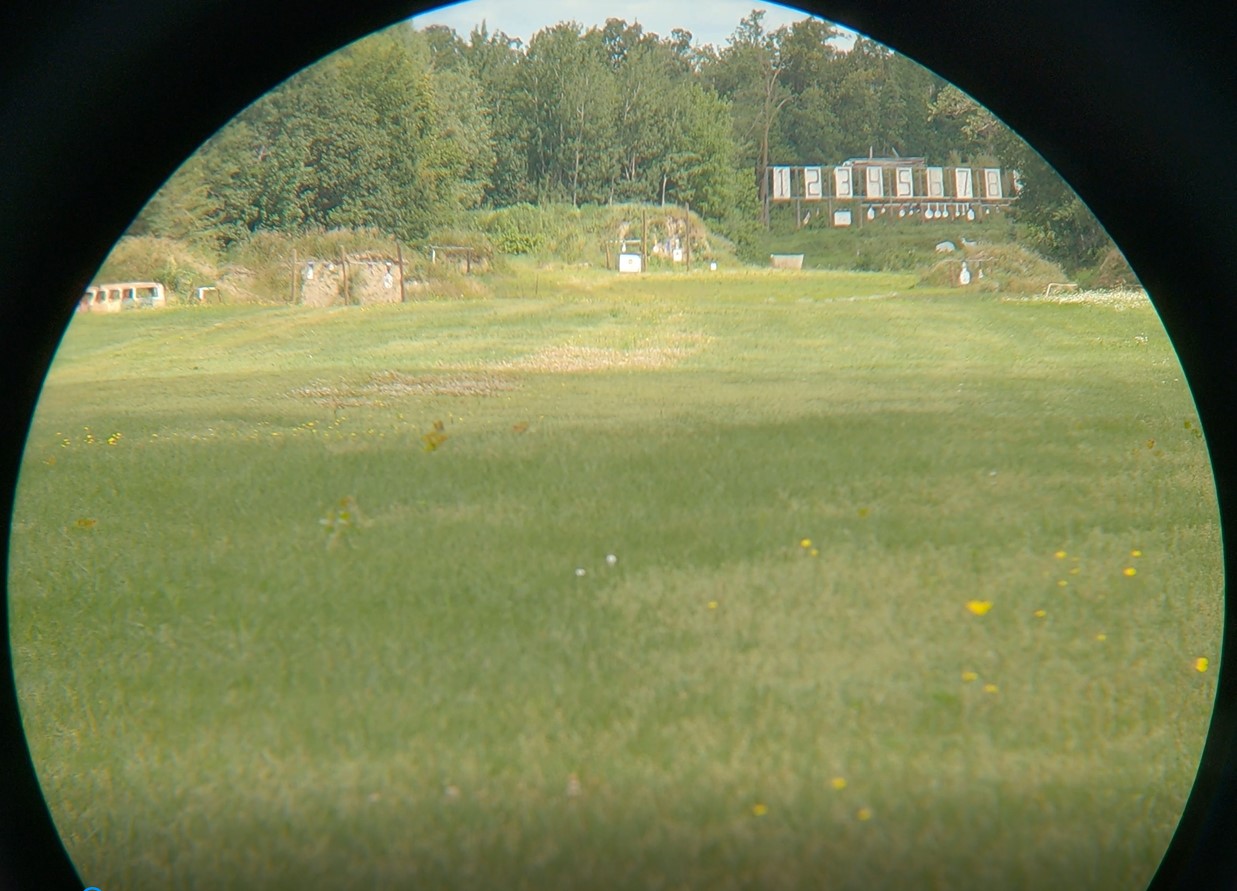

Yesterday I took the LMT 20" 6.5cm out. I am shooting factory hornady 140gr ELD-M ammo. Right now the barrel has 100-120rds of this ammo (and only this ammo) through it, so my MV is a little slow, trued with AB app to 2514FPS out to 700 yards. Everything from 300 to 700 was no problem. 900 made me look like a fool.
The shooting line and targets to 700yds are in the wide open fields. The wind was coming from left to right gusting from 4-12mph, and the wind would switch from 12 to 10clock. My gun appears to be a 6mph gun based on my holds.
The 900yd targets are surrounded by trees and not in the open at all. The mirage at 700 was horizontal but the mirage at 900 was difficult to see (10x binos and Mk5 5-25). The 10x binos weren't strong enough to see mirage at 900 and Mk5 was the same result. If I cranked up the magnification, it didn't seem like I was cutting through the 700yd mirage, so backing down the magnification I watched the vegetation and trees.
According to my AB app, I should've been around 1.2mils for a 6mph wind at 900 from 10clock. I tried bracketing the plate C-zone silhouette giving more room in case the wind was stronger. Since it's all trees and tall grass, I couldn't spot any splash. I could not see bullet trace either. I was on about 17x at 900. I went bold and put my 2mil marker on the center of the plate thinking it may hit left or right. Nothing. I could see the horizontal mirage at 700 and vegetation moving, plus my wind at my shooting position. I started watching this patch of small trees about 40 yards in front of the 900 yard targets. These trees would either be standing still or would whip around in a 360* manner. So I started reducing my wind call thinking I was adding too much. I started getting desperate and would hold .75 (PR2 reticle) and even just left edge hoping to get some indicator. I tried splitting the difference between wind at my position and what the vegetation was showing at 900. Nothing.
After much frustration, I drove down to the 700 yard targets and felt the wind was doing the exact opposite of my shooting position. It would go from 12 to 2clock and velocity was less. Over a few hours of shooting, I spent 60rds of ammo total from 300 to 900. So I was doing my best to take the time to evaluate wind conditions, switch from binos to scope while observing mirage and veg.
I did get hits on the big square plate at 900 but I couldn't see any new impacts or paint splash on the target. I just placed my center dot on the left edge which gave me almost 2mils worth of windage on the plate. I was at a loss doping that wind at 900 today.
Long story short, what methods do you use for shooting at targets that are sucked into tree lines with vegetation showing nothing to whipping around? I owned it from 300-700 but after that I got my teeth kicked in.
I included a photo of the range that was taken through my leupold 10x binos with gopro camera. The 700 yard targets are on the left. I was shooting the silhouette to the right of the square plate. At 900, I was shooting the silhouette under #4 and circle plate at #6.

The scope is a fixed parallax (300 yards) PMII and it showed me absolutely nothing. Im totally open to me just beeing retarded here.
Now you know why I still carry a spotting scope even if I'm alone. A spotting scope, correctly used, will show you lots of mirage information. Actually more information than most adj parallax scopes will show you. Unfortunately that's not something that can be taught anywhere but in the field.
Looking at the picture in the original post, I'm thinking it might help aslrookie to think of the wind a bit like water flowing over rocks in a river. It bounces off and creates suction zones around obstacles, and there are obstacles in the pic.

So what you’re experiencing is cross compartment wind (aslrookie’s situation has similarities). The approach to cross compartment wind management follows the same basic tenants but with the addition necessities of going much deeper.
1. Establish Wind indication points. The simple 1/3 -2/3 rule doesn’t normally work out. Reading wind at your location or the target is nearly irrelevant, you’ll need to understand how to read the terrain, you need to establish the different components of the terrain in order to deduce which parts are most relevant to your trajectory.
2. Direction/Value, now that you know where to properly look, you’ll need to account for the value(s) at play. They may need to be stacked or subtracted from each other, you may even find that some of them are actually irrelevant your situation. These values are also not only left to right but potentially up and down. In some particular Instances you may have to extrapolate wind value at altitude solely based off of observable wind effects at ground level.
In short keep it relevant, keep it simple. Fancy wind roses with cosines and all that bullshit it’s all fine in the theoretical but on the real world has a tendency to overwhelm and bog people down.
3. Establishing a wind speed (at each point). Again this comes down to understanding the relationship of fluid mechanics to the train at hand. You’ll have to be familiar with concepts like Venturi effects, slope compressions, wind gradients, duration cycles, etc.
At the end of the day thought you need to simply Establish a wind speed, ideally A high and a low based off of the observable wind cycle. The chances of completing an accurate timely calculation inside a single one cycle is reduced dramatically the more complex the scenario becomes.
4. Apply corrections based off of your guns Wind Speed Constant just like normal.
So the concept it’s self is simple but the practice of is another thing altogether. I am hesitant to bother even a rough outlining not because I worried about giving a way the keys to the kingdom but the fact that people are going to completely miss the critical points.
