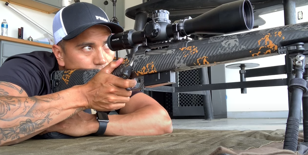

Here is Philip Velayo doing position one and two. These are ever so slightly different but this little difference make it work better.
Getting the rifle stock High enough on the shoulder is important. Than having the scope set right, and the cheek Height set right will stop the need to role your head. Between rifle setup, rifle connection the body and body position we should be able to eliminate rolling the head.

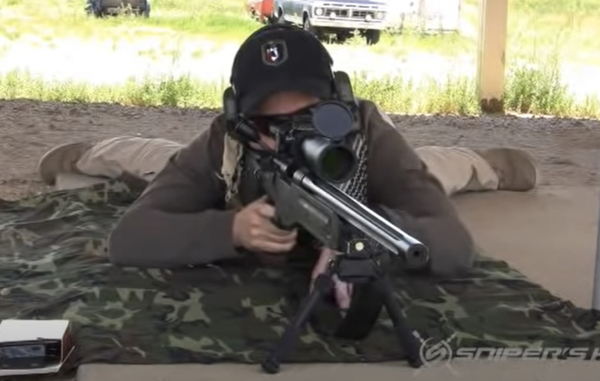

Sure you can find a picture of me here and there for various reasons but what exactly are you trying to point out, that you are more worried about the camera angles and what you "SEE" versus how it is taught and explained ad nauseam
Look at these screen shots, how can you be anything but straight you are looking at a camera angle most of the time, you can't put the camera dead in front of you there are angles involved
I index the rifle the EXACT same way every time, doesn't matter the position we line up straight

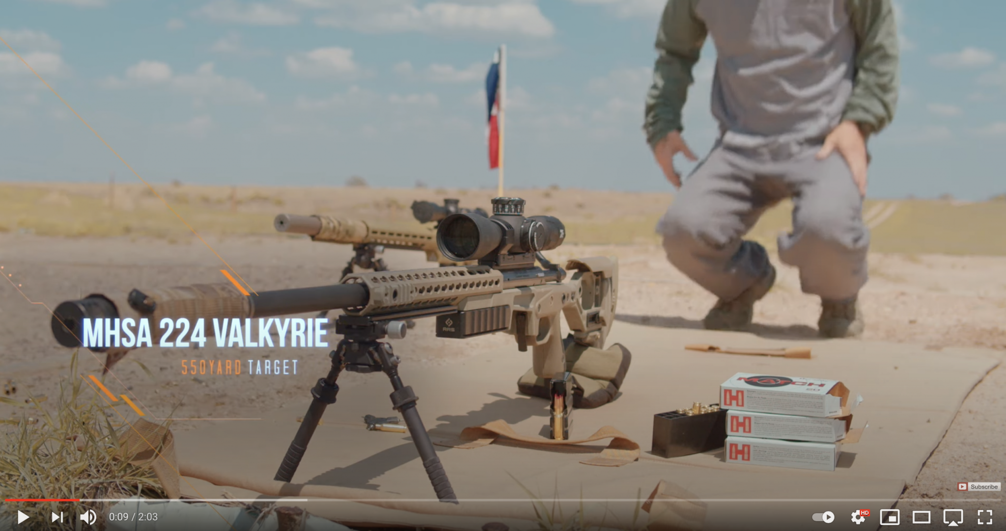

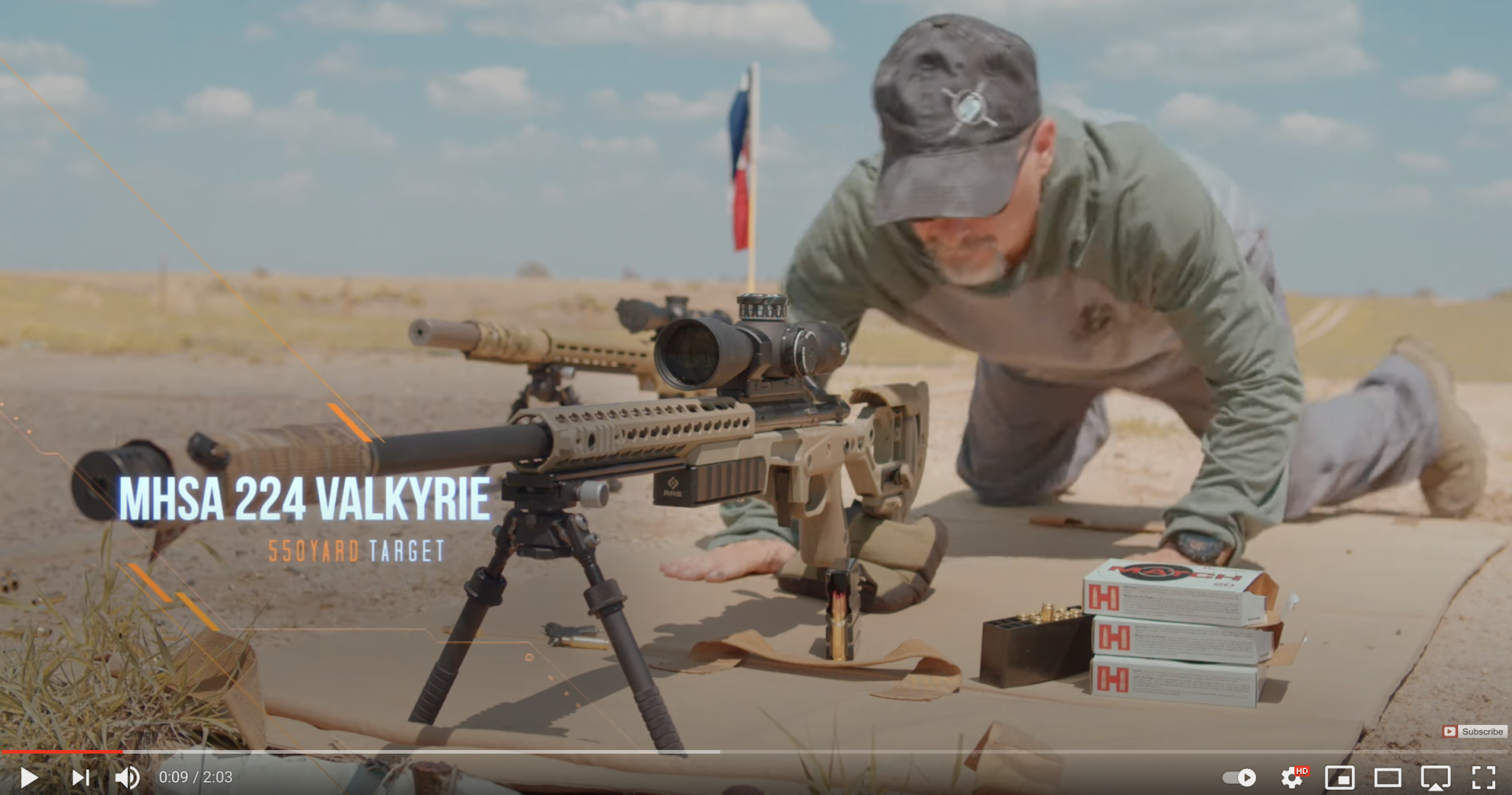

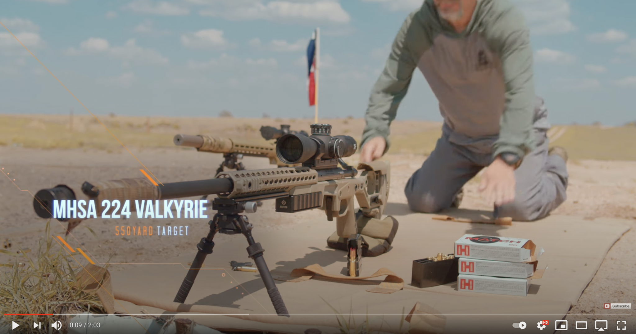

LL thanks for your response...man I just want to shoot like you sir. Thanks for your service btw. Not to be critical but in that Valkyrie video, it looks like you shift your knees to the left at .10 and your hips to the left at .18. That’s about the angle I am talking about for me, just ever so slightly to get my eye better lined up over my shoulder pocket so I don’t have to roll my head as much.
You can shift for a variety of reasons,
Heck it might be something under the mat that is uncomfortable, my neck and shoulders are jacked, I could have not felt great that day and you see it.
Every single body is different, the variations are minor, a 1/2" here, 3/4" there ... it just how our bodies are, the terrain, the rifle set up, the target locations
All that comes into play, it's Rifle pointed to the target and shooter pointed to the rifle
