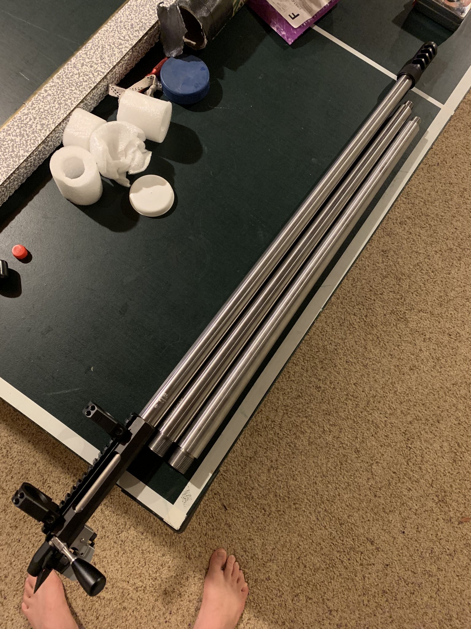

Are all a couple of hundredths different along the length of the barrel. I’m sure an armorer and machinist can tell by looking, but most people probably can’t, or feel a four ounce difference on a 14-20 lb rifle.
I think a lot of it is preference, and once you’re shooting any one of these “full contour“ barrels you’re getting the mass and heat conduction you’re looking for...
I have rifles in all of these and fluted/unfluted. I just don’t see it making that much difference in the shooting. I’m sure some feel more strongly than me, but that’s my opinion.
